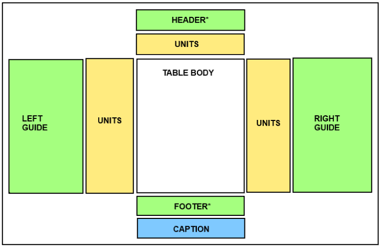

Too fast ioan, there are many things to do and to fix before a relase :d
I saw this beta yesterday on the online gallery, and let out little squeals of excitement but don't know well what it is.
Does it work like excel tables expandable and referencing to equations written on other places of the canvas ?
Is a region that show a SMath Studio numerical variable as written in a table; basically is an image, the look is customizable using the context menu (a cell editor like excel is too complicated to make for me); as for now there's only the body, I'll try to add other things (those shown in the dialog above and schematized below (colored boxes are all "optionals", as general idea); the hardest thing will be surely unit's handling ...
Best regards,
Davide

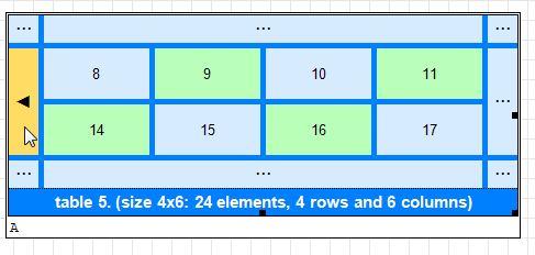

The possibility to display wide tables is in my mind, I've already a couple of ideas...

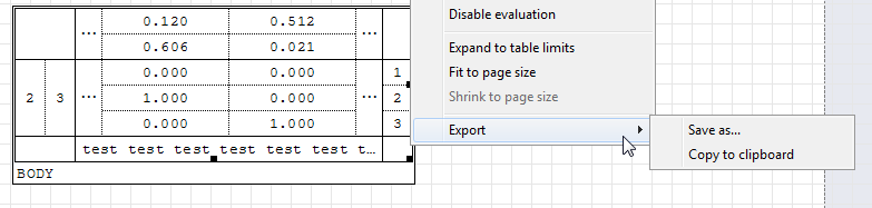

As for now the default size is the entire table (this is driven by the change of the data size - rows or columns); I've thinked to add an optional restriction on the page size but actually it's not easy (the plugin code need some improvements); your idea seems much more easy to implement
