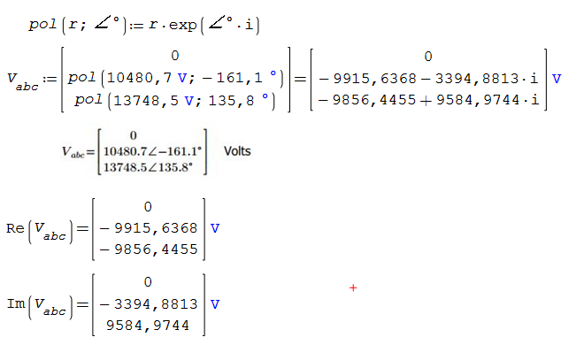

I am one tiny step away from freeing myself of Mathcad Prime. I just need to know how to format the result of a matrix/vector operation so it is in polar form with angle in degrees. The attached image is a snip from a Mathcad result. How is this possible in SMath?

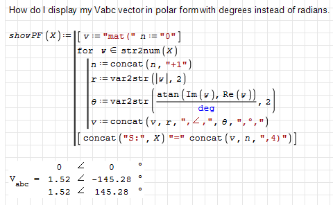

Hi. You can try something like this, using the table plugin.
showPolarForm.sm (18,3 КиБ) скачан 1157 раз(а).

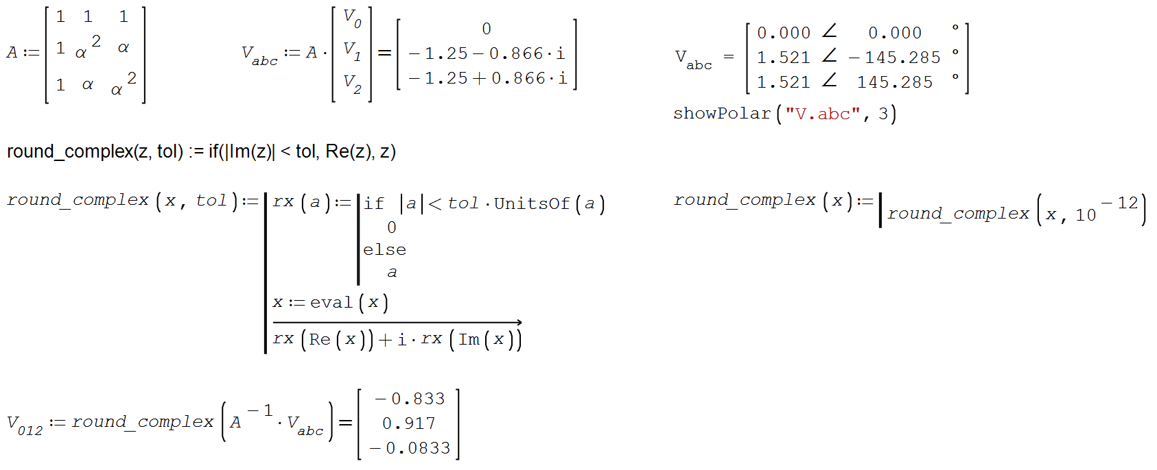

2) I can't figure out how to make it report a very tiny imaginary component as zero. See bottom of attached. showPolarForm.sm (20,74 КиБ) скачан 1188 раз(а).

Hi. Modified version.
showPolarForm.sm (21,93 КиБ) скачан 1209 раз(а).
