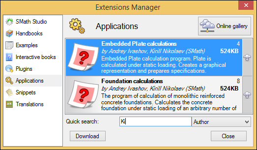

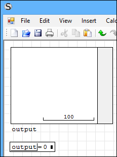

  1. Modeller Region is not built-in into standard SMath Studio package. It should be installed using Extensions Manager (Tools > Plugins > Online Gallery).
  2. Modeller Region available via Insert menu, so lets try to add it to the worksheet;
  3. Modeller requires output variable to be set. Try to evaluate this variable after Region to see its value. 0 - means no data drawn.

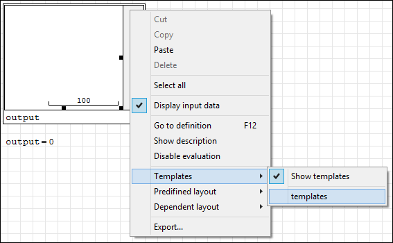

  6. Now we neeed to link Templates with a Modeller Region. It can be simply done with Context menu.

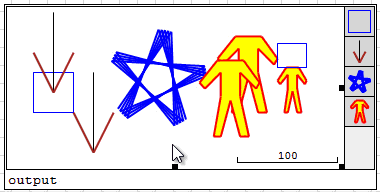

  7. After it is done you will see a Shape appeared at right of Modeller and while this Shape is hovered you will see a hint with Shape's name.
  8. That is all we need to start. Now you can drag'n'drop shapes from the palette at right to the Modeller canvas.
  9. Check out output variable. Do you see how butifull it is? Indeed, it contains full description of Shapes drawn inside Modeller! Now we can do whatever we want with this data!

  12. All Shapes are in vectors, so we can zoom in and out using mouse scroll.
  13. By the way, to delete drawn Shape just focus it by mouse and press Del on keyboard. You can also update Shape properties by double click on it try it by yourself. For the start you can use example I created for this intro:

I cannot access the applications from the online gallery, neither in the installer version nor in the (otherwise reliable) portable one.
works for me

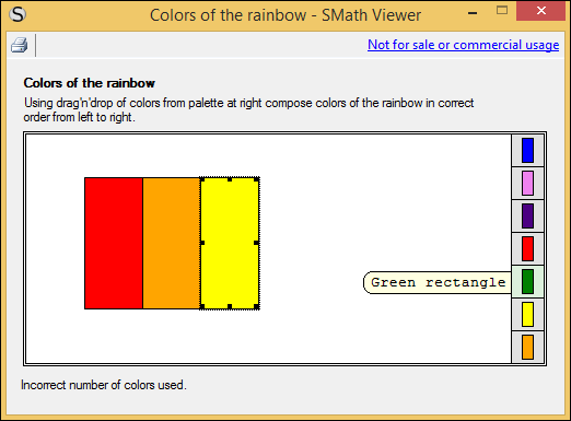

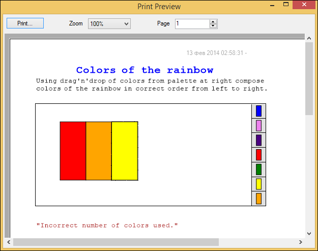

I just created a very simple game based on the modeller Region functionality. It is available as an Example and Application within Extension Manager.
Use Example to see how it works:
I can imagine to create some applications for students with tasks about math, physics or anything else where students should set correct locations of some objects (numbers, resistors etc) to pass the test/exam. Note: that Print button is available in SMath Viewer, so the result can be sent to print out in seconds! Any ideas?

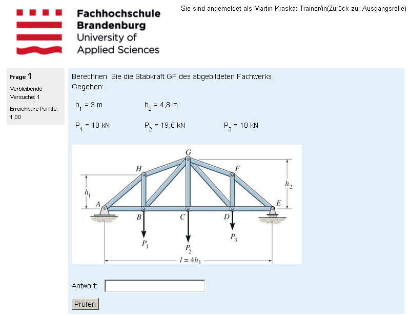

I am using Moodle for homework assignments in engineering mechanics. You can define problems with random individual parameters for each student and ask for a single number (with units support). This number is checked against a reference solution formula, given as a single expression without intermediate variables. Moodle takes care of deadlines, grading and the like.
These formula can be several hundred characters long, just imagine to compute the maximum stress in a compound cross section, where the centroid and moments of inertia need to be calculated from the given data. Kay had the job to create and input these reference formulae - guess what he did: writing a plugin for export of expressions to moodle format.
With interactive graphics at hand, I could imagine to ask for free body diagrams and support reactions with automatic consistency checking.
Or let the students draw shear and moment diagrams from randomly created loads and support conditions.
Or just create graphic problem representations based on parameters.
Moodle has a plugin interface and there seems to be a maxima plugin. However, I am not a moodle administrator and it was quite hard for me to find out how to operate it. The docs explain the buttons and dialogs but do not guide you through common workflows.
An interesting tool for such interactive graphics combined with computer algebra functions is geogebra. This is a tool which can be embedded in web sites, similar to SMath live. It is developed in Austria and in recent releases moves towards computer algebra.

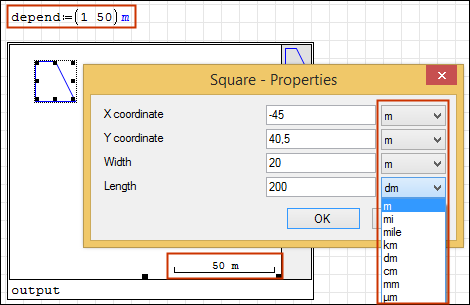

How did / do you incorporate units?

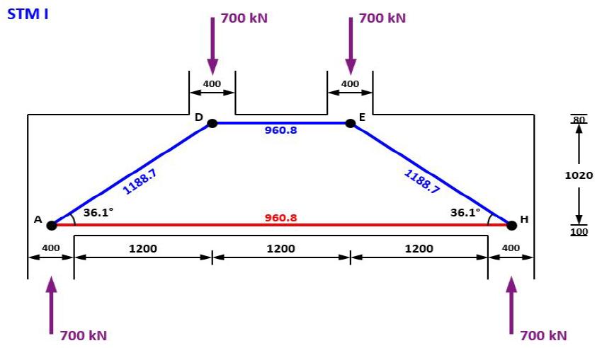

I know it has been quiet here for a while, but there is little something something I could use modeller for - strut & tie modelling:
http://best.umd.edu/publications/stm.pdf
or in plain words, conceptually separating a chunk of concrete into compression elements (struts) and tension steel rebar elements (ties) in a way that will create a valid load path from the point load to the support or reaction.
The thing with strut & tie is that it is very graphical solution; if you can draw it, it will work.
I was hoping to use modeller to draw a set of interconnected lines. Once drawn, the lines (start & end coordinates) can be extracted to SMath for further processing.
Modeller would be a perfect environment for this, except in it current form it cannot draw inclined lines, or lines that will "snap" to the existing node.
Andrey, do you anticipate any further work on this plugin?
Right now I am "drawing" in EXCEL and heck it is not right way of doing this.
