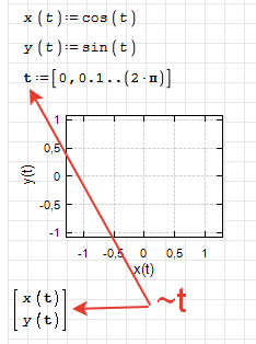

And one last question: could it be possible to implement the graph of parametric functions in the XY Plot plugin? Something like ParamtricPlot (x (t), y (t), a, b ) and that takes the number of points from the plugin configuration, or ParamtricPlot (x (t), y (t), a, b, N ) for N subdivisions (N + 1 points) of the interval a < t < b.

And one last question: could it be possible to implement the graph of parametric functions in the XY Plot plugin? Something like ParamtricPlot (x (t), y (t), a, b ) and that takes the number of points from the plugin configuration, or ParamtricPlot (x (t), y (t), a, b, N ) for N subdivisions (N 1 points) of the interval a
I think it is possible to mark a "vector" variable with a tilde "~": ~t. It might look like this. I need to think about whether this will work.

#123 Опубликовано: 11.12.2021 04:14:06
It looks pretty good.

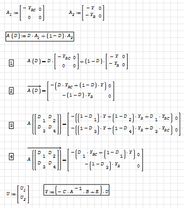

... Maple Tools, simplify выдал что-то не то что должен был по моим разумениям.Raschjot17.sm (24,05 КиБ) скачан 1717 раз(а).
Hi. Notice that SMath does not operate automatically expands matrix operations. Also, the maple's linalg package have some issues too, and sometimes needs to call evalm function, which means "eval as matrix".
If D is a scalar I suppose that the correct result is (2), but if it is a 2x2 matrix I think it is (3).
In both cases you cannot calculate A ^ (- 1) because the second column of A is zero.
Could you comment what is the expression you expect for A? Also perhaps something from this post may be useful to you: https://en.smath.com/forum/yaf_postst17472_Applications-for-equrep--expression-isolation-and-laplace-transform.aspx

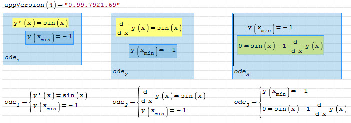

P.S. Found a critical issue while trying to resolve this kind of system (x'(t) and x''(t) in one equation):
The conversion of a complex system to a matrix form is not correct. A more complex algorithm is required. Only simple types of ODEs will be computed correctly.
churichuro 21.06.2022 14:46:00, sergio 21.06.2022 14:59:00

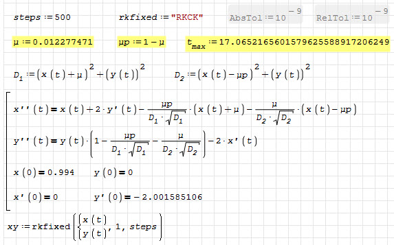

I hope I didn't solve it wrong.
These ODEs is called the Arenstorf Orbit.
lsoda.Arenstorf Orbit.sm (15,45 КиБ) скачан 1988 раз(а).
lsoda.Arenstorf Orbit.pdf (93,42 КиБ) скачан 1078 раз(а).
The problem is that I use an universal algorithm that independently searches for derivatives in equations and arranges them in a matrix. I started with low order derivatives, so the equations were solved with respect to them first. It's wrong, but it worked in simple cases. When I redid the enumeration of derivatives of higher orders, I found that I did not take into account the case of different naming of variables. In this regard, an incorrect matrix is ​​obtained and the numerical algorithm cannot find a solution.
I need to organize a double loop that first takes into account different variables, and then their derivatives.
It is strange that I didn't do this earlier, because the rest of the code is designed for this.
I had a very simple set of examples that I experimented with. As soon as I tried something more complicated - it immediately revealed the problem.
