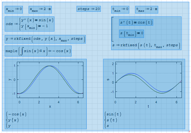

Updated. Now you can also use simple form for D() function definition.

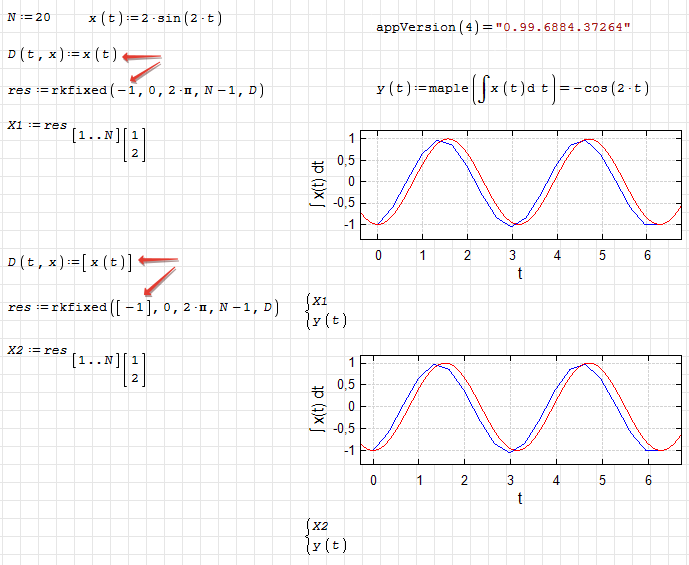

But x in D(t,x) is vector.

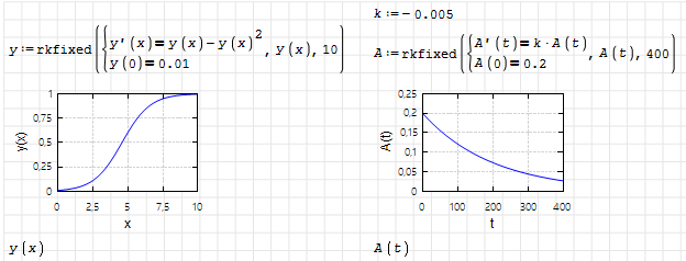

#83 Опубликовано: 24.12.2018 05:33:39
Updated.
Now x in simple D(t,x) definition must be a scalar.

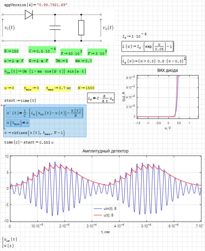

2018-12-24_13-43-45.png iode.test1.png iode.test2.png 2018-12-24_13-32-46.png
iode.examples.sm (204,21 КиБ) скачан 2333 раз(а).
iode.kinetic1.sm (7,75 КиБ) скачан 2279 раз(а).
iode.kinetic2.sm (14,4 КиБ) скачан 2136 раз(а).
iode.kinetic3.sm (14,08 КиБ) скачан 7101 раз(а).
iode.integrate.sm (10,57 КиБ) скачан 7066 раз(а).
iode.test1.sm (22,49 КиБ) скачан 2121 раз(а).
iode.test2.sm (22,5 КиБ) скачан 2273 раз(а).
iode.Amplitude detector.sm (20,18 КиБ) скачан 2210 раз(а).

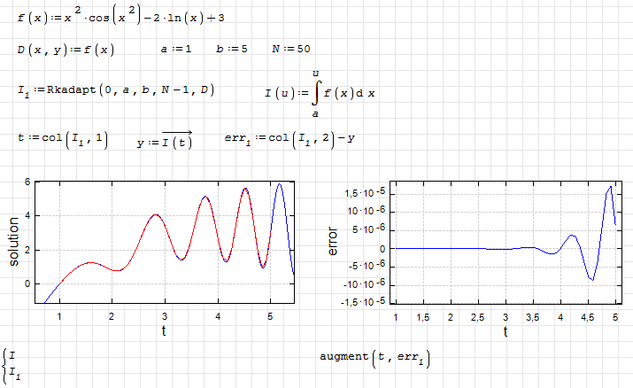

#84 Опубликовано: 16.01.2019 06:05:17
Updated. Rkadapt() fixed.

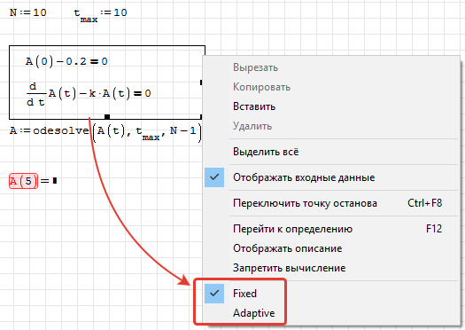

No, Jean, 1/1 - not possible. Now they have two different realisations: MC11-MC15 and Prime. But I can do something similar. Plugin can implicity collect information about available ode solvers and you can choose them in the context menu.

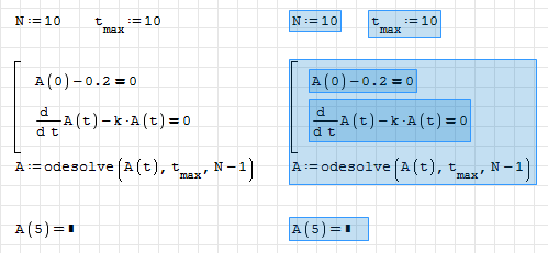

#91 Опубликовано: 11.07.2021 00:23:42
Some news.
It's hard but I want to realize a general solution for some types of tasks. Specially for this I need more powerful symbolic engine inside SMath. Therefore I made symcs project. I hope that we can use this solution in other similar cases.
Hi uni. It is possible to enable a clone of that component for return only the expressions inside? For example, the set of the equations
Also, it is possible too to add the option for mark with a round box the area?

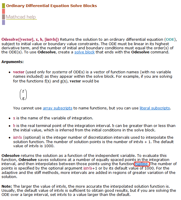

I have verified that linear interpolation is used, which is described in the manual.
I changed the interpolation method to linear and also changed the notation of the derivative by analogy ( "`" ).
Davide Carpi 29.11.2021 06:40:00
#95 Опубликовано: 28.11.2021 16:42:18
Prime symbol looks much better (′). I think it's better to use it.
#96 Опубликовано: 28.11.2021 18:49:59
I was wrong. Linear interpolation and linear spline interpolation are different things. I will try to find the formulas that are used in these functions.

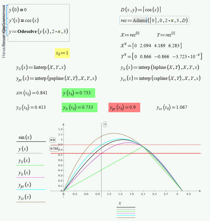

#97 Опубликовано: 29.11.2021 02:43:07
A simple test that shows the interpolation method used by the ODE solver. Obviously, the lspline() function is used.

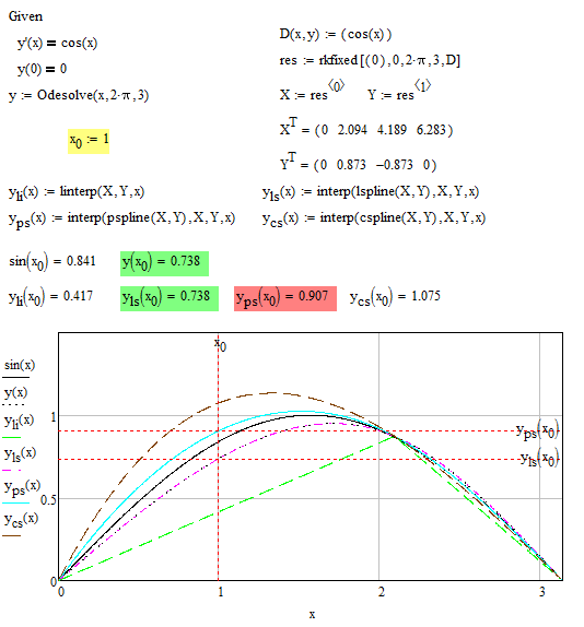

Odesolve() with rkfixed method (Mathcad 15).
Odesolve interpolation test.mcd.zip (8,84 КиБ) скачан 512 раз(а).
The same for Mathcad Prime 7.0 (Adams method used).

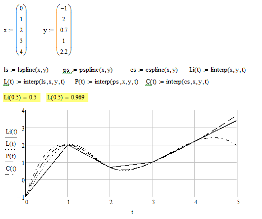

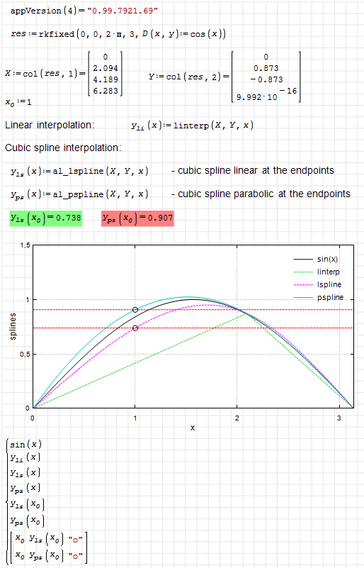

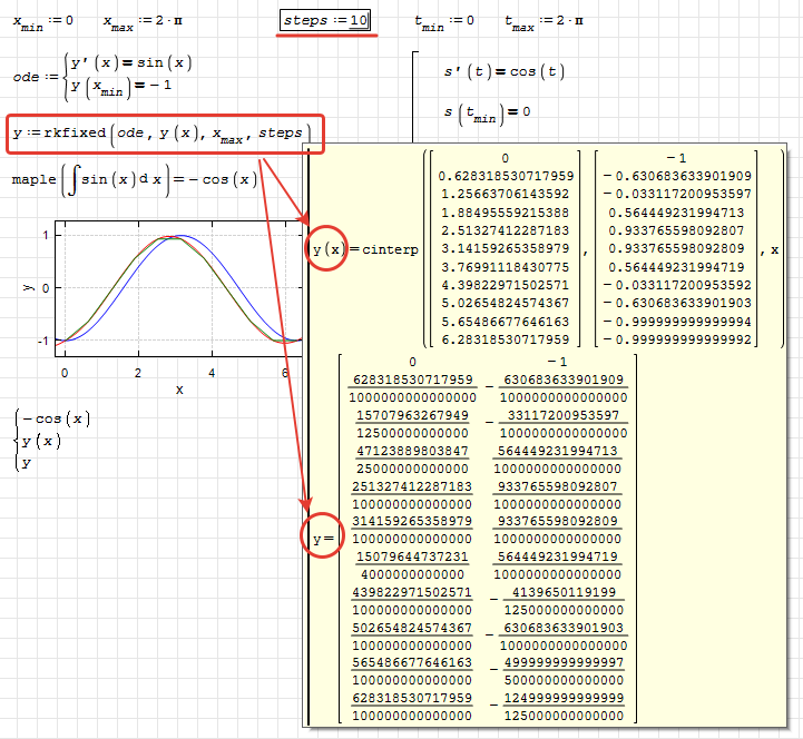

#98 Опубликовано: 29.11.2021 20:31:00
Ok, I found a bug in rkfixed() and finally figured out the difference between interpolation functions. In the picture below, I repeated part of the calculations from Mathcad. As you can see, to interpolate the numerical solution of the ODE, a cubic spline is used, linear at the end points.
Bugs will be fixed when the build server starts working.

#99 Опубликовано: 29.11.2021 21:30:48
Thanks Viacheslav ... superb demo.
BTW, I was wrong ODEsolve is lspline MCD 11.
Years ago, Tom G. had exposed the different deficiencies
wrt to each l_p_c cubic spline ... Matlab as well.
So, your next headache is to figure the best solver from
the huge Smath library [17], Mathcad stiff is Radau MCD 2001i, 11.
Cheers ... Jean.
