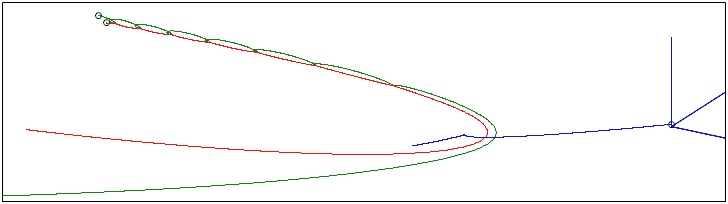

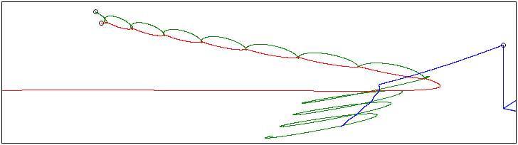

#149 Опубликовано: 04.04.2023 01:59:18
Little bit more.
Click to enlarge
7-13-Three-Planets 6 (Mathcad Block).sm (26,11 КиБ) скачан 2186 раз(а).
7-13-Three-Planets 6 (Mathcad Block).pdf (67,28 КиБ) скачан 1039 раз(а).
Mark R Harris 04.04.2023 16:19:00

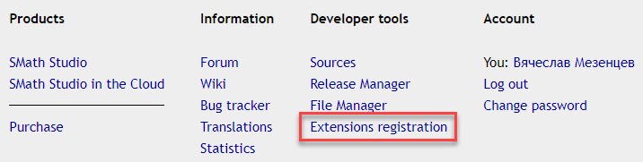

Hi. That function looks great. Is there an example of using a document as an add-on?
Try to log in here using the registration data in the program: https://en.smath.com/upload/extensions.aspx
You should see this picture:
Click to enlarge
Next, you need to choose the type of extension
Click to enlarge
Before uploading a file, you need to fill in the document properties. Later, you can delete the file if necessary.
Click to enlarge
If the registration data is not suitable, then you need to request them from Andrey via e-mail.
The registered files will be available through the gallery.
Click to enlarge

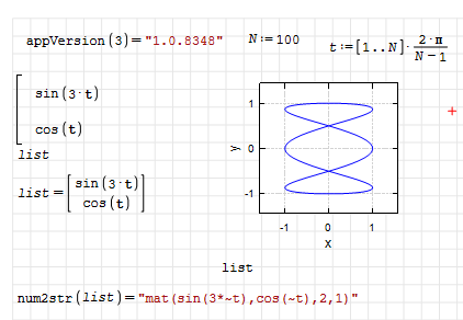

#158 Опубликовано: 17.04.2023 06:58:15
SMath Studio compatibility
Plugin updated.
Changes:
- added support for sequence operation (sys - default, mat, line);
- base frames drawing for error and eval states restored.
Click to enlarge Click to enlarge

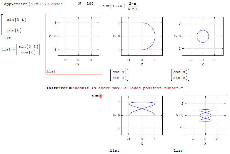

#159 Опубликовано: 17.04.2023 16:43:23
Unfortunately, I can't reproduce your parametric plot example.
It seems that the parameter range is taken from the x axis limits. Assigning a range to the parameter makes the plot fail.
How to fix this?
BTW, how about making the glyph of the mathcad block reflect the actual type by using {,[ or | to indicate the vertical extension?
Mathcad block.sm (13,77 КиБ) скачан 1738 раз(а).
#160 Опубликовано: 17.04.2023 17:22:41
...How to fix this? ...
Use ~t instead t in list, but t in the range.
That's very original!
