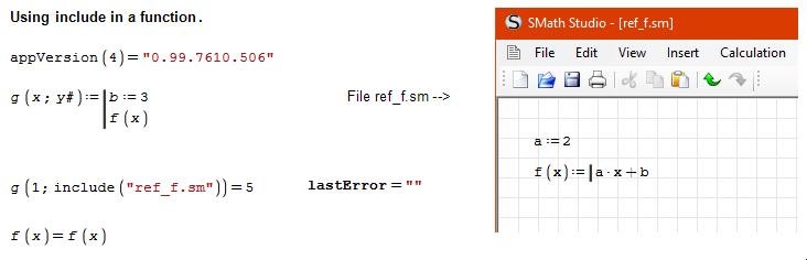

Hi. First, thanks for your work. I think that include it's one of most important tools in SMath for write advanced functions, like ode solvers, in native SMath code, instead of use C# plugins.
It's possible using include in a function body? Please, see the attached. In case that it could be, can also be values in include only local for the caller function, and not to the entire worksheet?
ref_f.sm (2,29 КиБ) скачан 1506 раз(а).
work_with_ref_f.sm (19,44 КиБ) скачан 1477 раз(а).
work_with_ref_f.pdf (102,22 КиБ) скачан 832 раз(а).
Thanks!!!

using "include" as a function parameter can work around the problem!?
Alvaro 18.11.2020 13:36:00
#129 Опубликовано: 18.11.2020 13:35:22
Hi Pompelmo. Absolutely. That' exact what I want. Thanks very much.

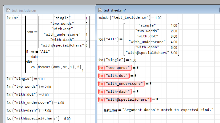

Hi. Thanks for this plugin. I found it very useful in creating a single custom functions file for my team.
I'm encountering errors when I have strings with spaces or any other special characters as arguments. If I call the function within the included file there's no error. Does anyone have an idea on what's causing this?
Thanks.
test_sheet.sm (5,08 КиБ) скачан 1538 раз(а).
test_include.sm (5,18 КиБ) скачан 1518 раз(а).
#138 Опубликовано: 10.12.2021 06:22:01
SMath Studio compatibility
Plugin updated. Please try.
The update solves the problem. Thank you very much uni.
