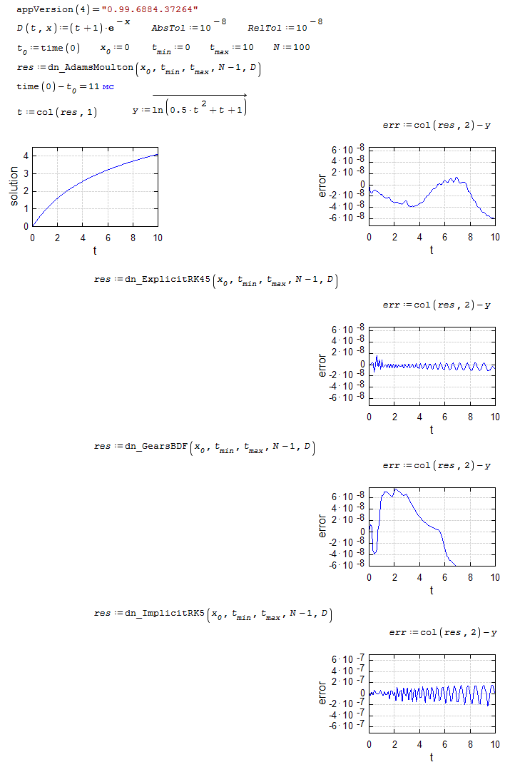

Options:

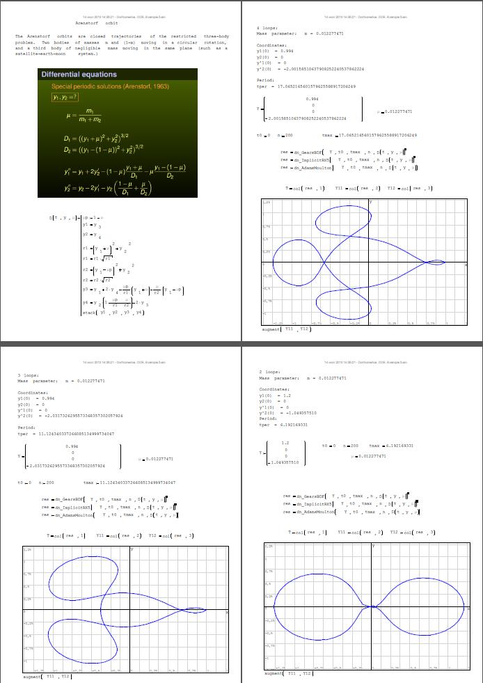

2. Arenstorf orbit. Numerical Analysis: Theory and Applications. Proseminar, 28.03.2011, UIBK [pdf].

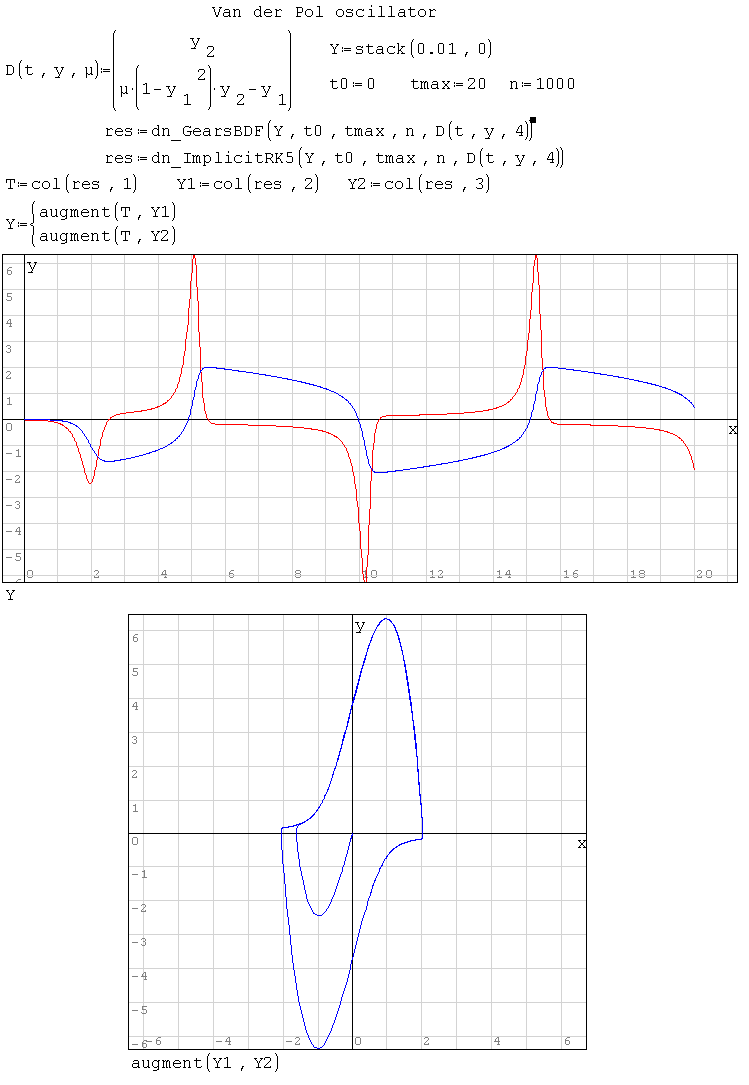

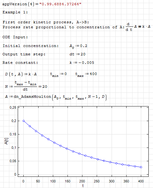

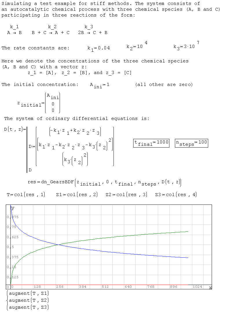

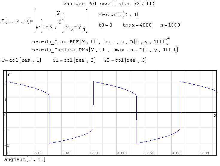

Examples:

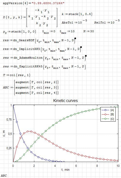

Test_GearsBDF.png DotNumerics. Example 3.png DotNumerics. Example 4.png Arenstorf orbit.JPG
2018-12-24_17-06-48.png 2018-12-25_04-33-23.png 2018-12-25_04-34-24.png dn.ode.test2.png dn.ode.test1.png 2018-12-24_17-07-41.png

DorNumerics. ODE. Arenstorf orbit.sm (91,95 КиБ) скачан 1816 раз(а).

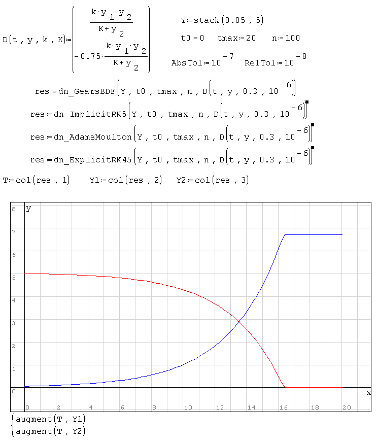

I must be annoying now , but could you try please try to reduce this numbers just a bit and try my "famous" example with bioreactions. I used recently some ODE stiff solvers from a package inside R. They gave the same results with negative concentration. Then, I reduced the default values for the accuracy and it worked a bit longer, but gave me the expected zero concentration.
Updated. I've added support for accuracy (not completely). The library allows to set accuracy for each equation separately. Now for all the equations will be the same accuracy.
Yes ... This was simply great and a celebration for my eyes and soul .

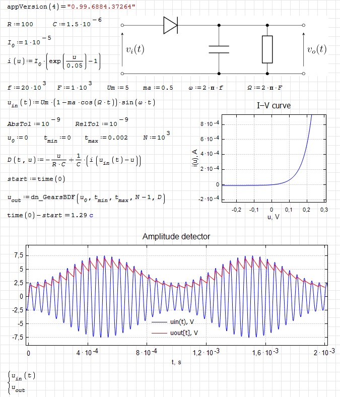

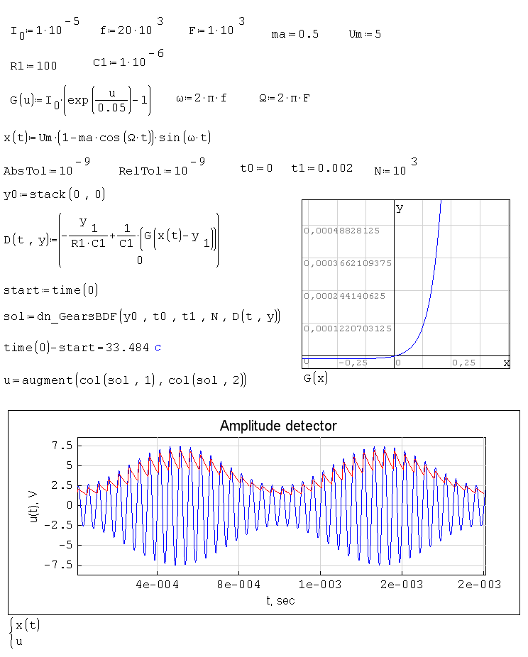

Amplitude detector.
Amplitude detector.sm (14,41 КиБ) скачан 1742 раз(а).

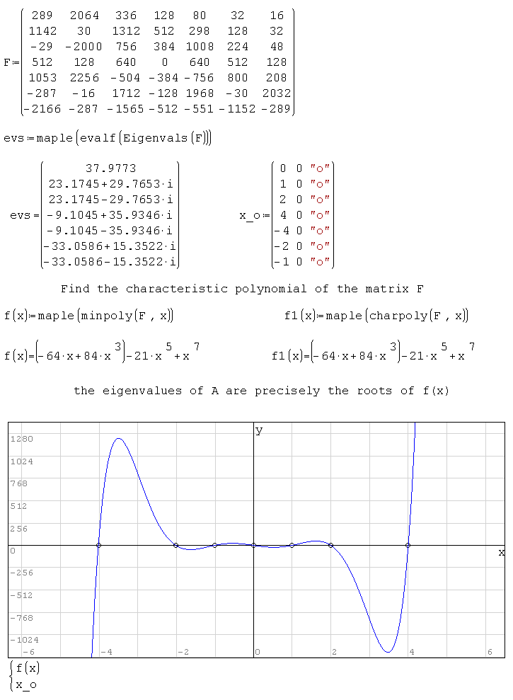

[+]: dn_LinAlgSolve(), dn_LinAlgLLS_COF(), dn_LinAlgLLS_QRorLQ(), dn_LinAlgLLS_SVD(), dn_LinAlgSVD(), dn_LinAlgEigenvalues(), dn_LinAlgEigenvectors(), dn_MatrixInverse().
Цитата
I have such a modest dream – ta have available in SMath some others modules from DOTNUMERICS, particularly the EISPACK one.
What kind of functions do you need?
I'm not sure that dn_LinAlgEigenvalues() works correctly.
DotNumerics. Linear Algebra. Example 1.sm (28,95 КиБ) скачан 1827 раз(а).

I played a bit with your example. It seems to me that eigenvalues and eigenvectors are correct for both matrices A and F. For the matrice F you gave the vector of eigenvalues which should be correct ("must be" vector). It seems that both vectors of eigenvalues - this one and the one found by dn_LinAlgEigenvalues() correspond to the eigenvectors fond by dn_LinAlgEigenvectors(). I am not sure this should be all right then or some numerical "glitch" is involved here. For some simpler matrices it works Ok and we can get the desired result by simple transformations of eigenvectors. I do not know how the AlgLib works and which kind of transformtion uses in order to give one of the many possible solutions for eigenvectors. I might be wrong about all of this, of course.
This time again eval() must be used as well to get the result. Moreover, again the well known annoying thing that sometimes the results with and without eval() are slightly different. See the attached file please.
DotNumerics_LinearAlgebra_Example-corr.sm (106,57 КиБ) скачан 1809 раз(а).

Yes, this is interesting. And I'm doing it this way.
DotNumerics. Linear Algebra. Example 2.sm (11,82 КиБ) скачан 1828 раз(а).
Hmm...If you use eigenvals() instead of Eigenvals(), you will get the roots as on the graph. I do not know what is the difference?

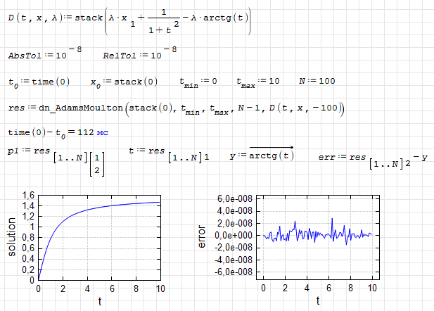

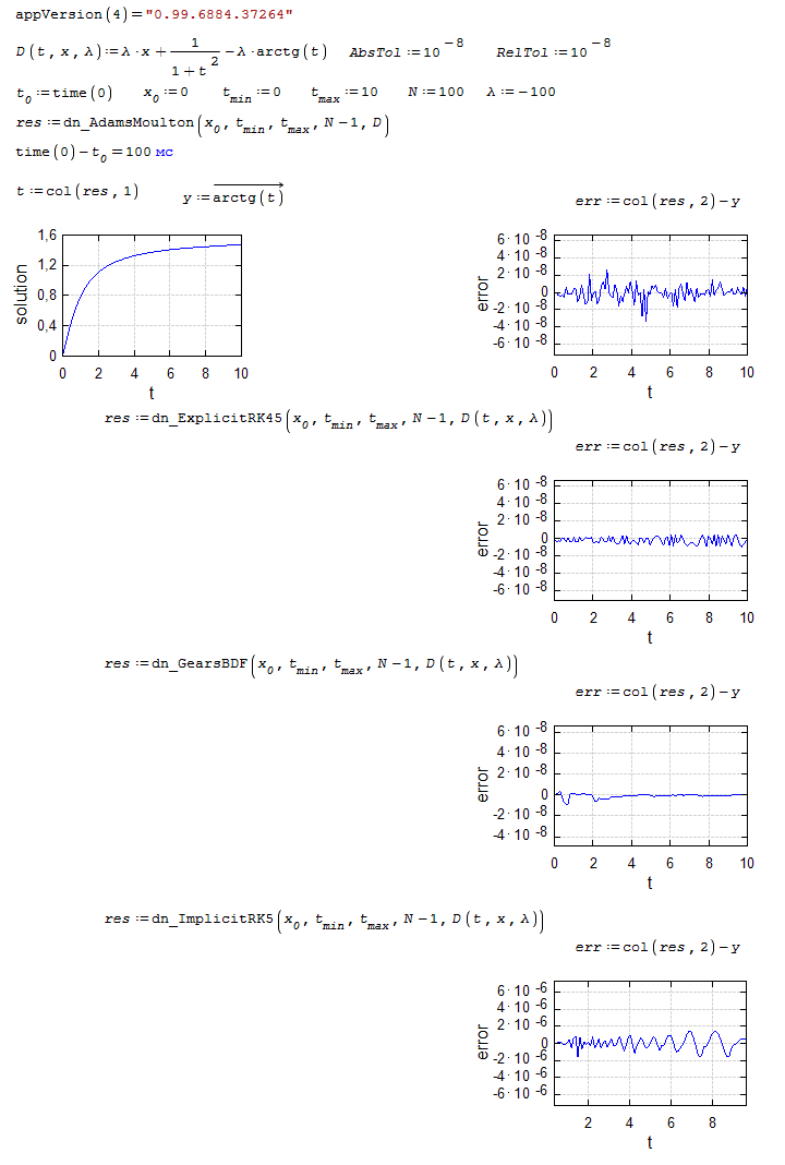

dn_AdamsMoulton simple test 1.
dn_AdamsMoulton.test1.sm (11,33 КиБ) скачан 1760 раз(а).
dn_AdamsMoulton.test1.pdf (48,2 КиБ) скачан 887 раз(а).
