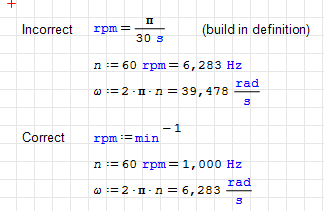

I've seen a few threads on this forum discussing the confusion with rpm unit. I'm not going to claim that this unit has wrong definition in SMath since it looks like it's just defined differently than one might expect. Anyway, can you tell me how to convert rotational speed in rpm to angular velocity in rad/s without having to get rid of units in the whole document ? I need a correct value of angular velocity for further calculations.
Here's what I get in SMath:
And here's what I expect (result from Wolfram Alpha):
It seems that I can't use built-in unit conversion in this case. So what's the best workaround ? Is it necessary to redefine the unit or maybe I can do something else to make it work ?
Thanks in advance for your help.

As you can see, Smath already stores "n" in Hz.
If you intend to convert manually then you have to do it correctly as shown here:

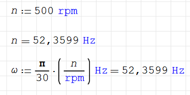

#3 Опубликовано: 27.08.2021 15:44:10
EngMath
EngMath
0 сообщений из 51 понравились пользователям.
Thanks, it seems to work:
Is that the only possible workaround apart from not using units ?

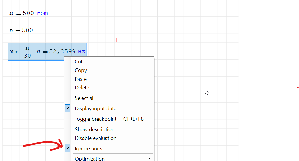

UnitaSilenziate.sm (2,88 КиБ) скачан 1350 раз(а).

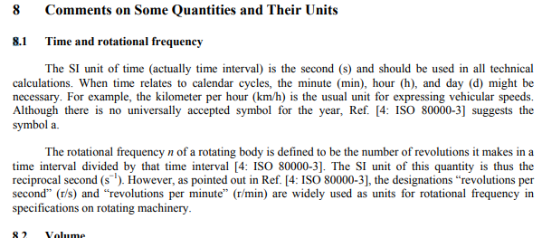

The NIST document (https://physics.nist.gov/cuu/pdf/sp811.pdf) defines rpm in chapter 8.1 as (rotational) frequency:
At the top of page 54, you will find the table caption
and further down the conversion factor.
Try to harmonize this with the Smath definition...

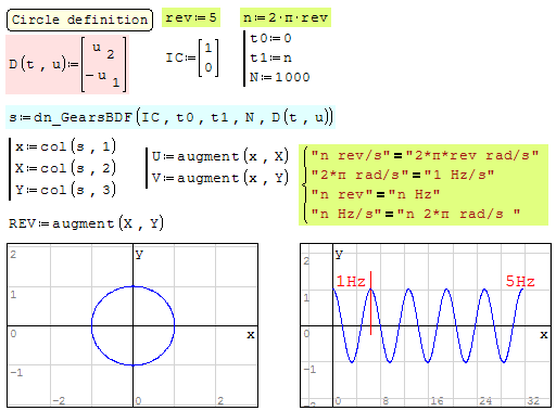

Plug my frequency meter in the grid ► 60 Hz, i.e: frequency
However, not from Smath !

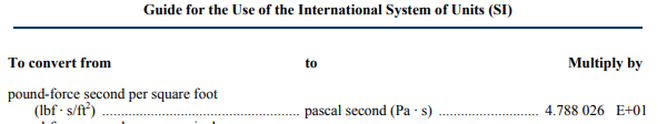

Overlord, you've misread the NIST conversion table. As listed on page 54 and again on page 67 at https://physics.nist.gov/cuu/pdf/sp811.pdf:
The table says:
Цитата
To convert from:
rpm
To
rad/s
Multiply by
1.047198E−01
Note that the NIST table does not convert rpm to Hz, it converts rpm to rad/s. I've laid out the calculations to prove it below:
