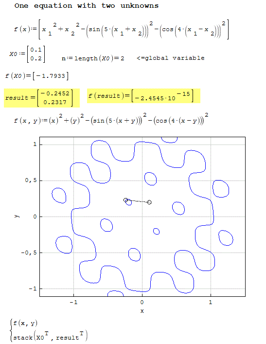

One example of V. Mezentsev (Uni)
Primer Uni.sm (13,49 КиБ) скачан 1671 раз(а).

Fortunately, I was wrong. We could use it with different number of equations and unknowns.
I just use the Ber7 example and change it with n as a global variable. No need for zeros as non-existing functions.
Primer%20Uni-mod.sm (13,3 КиБ) скачан 1734 раз(а).

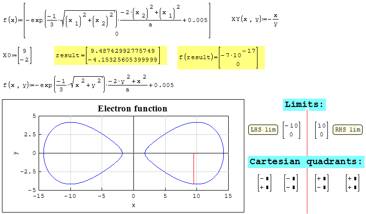

#25 Опубликовано: 18.07.2018 15:19:47
But for some reason simple Newton-Raphson with variable step usually
works better than al_nleqsolve.
Can you demonstrate for this application ?
Solve al_nleqsolve-Electron.sm (18,41 КиБ) скачан 1637 раз(а).

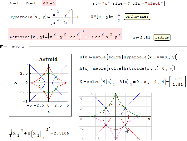

#34 Опубликовано: 23.08.2018 10:57:07
... thanks Ber7
Contour SOLVE AstroidHyperbola.sm (20,85 КиБ) скачан 1692 раз(а).

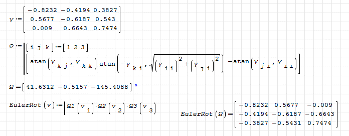

PD: Do you know the angles for your rotation matrix gamma? I get this, but can't put the matrix elements in the correct order nor sign:
Actually, as I know, the minus in the last atan is a mistake, but at least give the same absolute values.

Hi, Alvaro.
Unfortunately, I have never done reverse transformations (gamma-omega).
Your error may be caused by the use of the left coordinate system in Smath- graphs.
I selected the angles for the axial matrices empirically in order to get a good perspective ,using the gamma matrix.perspective.
Alvaro 09.10.2018 21:14:00
#39 Опубликовано: 10.10.2018 00:40:38
Mathcad solves the Euler angles from a given γ [gamma matrix].
Smath does not immediately, it complains: Try to use a more specific algorithm.
There are 24 [4!] possible ways to define a 3D system [Mathematica].
The most common is Euler though Mathcad Mathcad ≠ Mathematica.
For common use to define some pleasant views, especially in Smath:
1. Euler [ 3 trig angles]
2. Parametric [X,Y,Z,t] very easy to manage.
3. Quaternion only two coefficients that Quaternion solves for the 3D γ matrix
Rotate Horn.sm (15,07 КиБ) скачан 1626 раз(а).
Solve Euler Fails.sm (22,54 КиБ) скачан 1671 раз(а).
Rotate Breather [Euler].sm (37,2 КиБ) скачан 1441 раз(а).
Rotate_0 Euler, xyz(t), Quaternion.sm (275,27 КиБ) скачан 1664 раз(а).

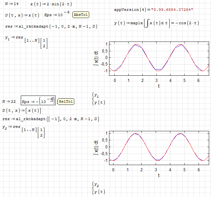

Updated.
Changes for al_rkckadapt():
- zero point issue fixed;
- added support for the simple D(t,x) definition.
