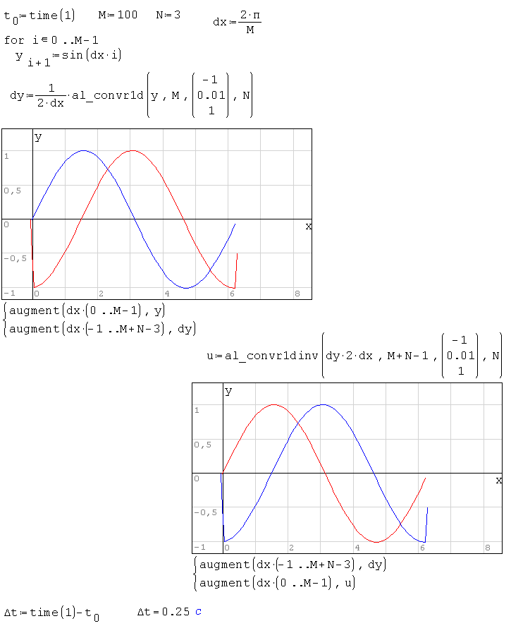

Didn't find an explicit alglib topic, thus I post this here:
It seems that the convolution function from the alglib plugin does not care for the second and fourth arguments (problem size in alglib ). I guess that the problem size is nothing else than the size of the 1st and 3rd arguments, thus they are obsolete.
If that is correct than I suggest to provide a convr1d(2) function.
BTW, a real symmetric eigensolver would be fine...

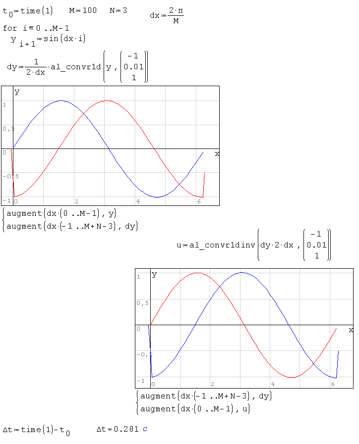

I think it's best to follow the description in the source code (see doc.pdf). I corrected the behavior of the function and added an inverse function convr1dinv().
#4 Опубликовано: 28.04.2013 02:34:59
Uni, thanks for the update. Now the function convr1d seems to insist on providing the correct vector sizes as arguments. This is not really an improvement unless values differing from the actual length can be provided for some magic purpose. I did not find any such hint in the doc. Thus, in order to keep the argument list lean, I would recommend to have
[MATH]convr1d(f;g)[/MATH] and let the interface determine the sizes as in the previous version.
However, I do not want to distract you from progress in the xyplot-plugin!
Martin
#5 Опубликовано: 28.04.2013 06:24:22
Ok, I'll add this too. It seems to me that I need to follow the documentation to describe the interfaces of functions.

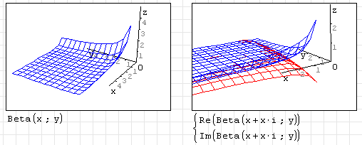

The alglib version of the Beta function seems o return values if one argument is negative despite of the docs limiting the range to posive arguments. Also, in contrast to the implementation in the StatisticalTools Plugin, the function cannot handle complex numbers.

#7 Опубликовано: 06.05.2013 06:55:55
Updated. al_convr1d(2), al_convr1dinv(2) added.
Davide Carpi 06.05.2013 07:46:00, Martin Kraska 06.05.2013 10:20:00
#8 Опубликовано: 06.05.2013 10:42:24
Thanks for implementing the proposal.
On my system, Example 2.sm fails to run correctly. If I replace the al_convr1dinv(4) by al_convr1dinv(2) then it is ok. My handbook examples show the same effect, on top of that, in conv.sm, there is an xy-plot-region throwiing an critical error. It does not recover, even if I fix the convolution problem with the new (2)-call. conv1.sm is the fixed version.

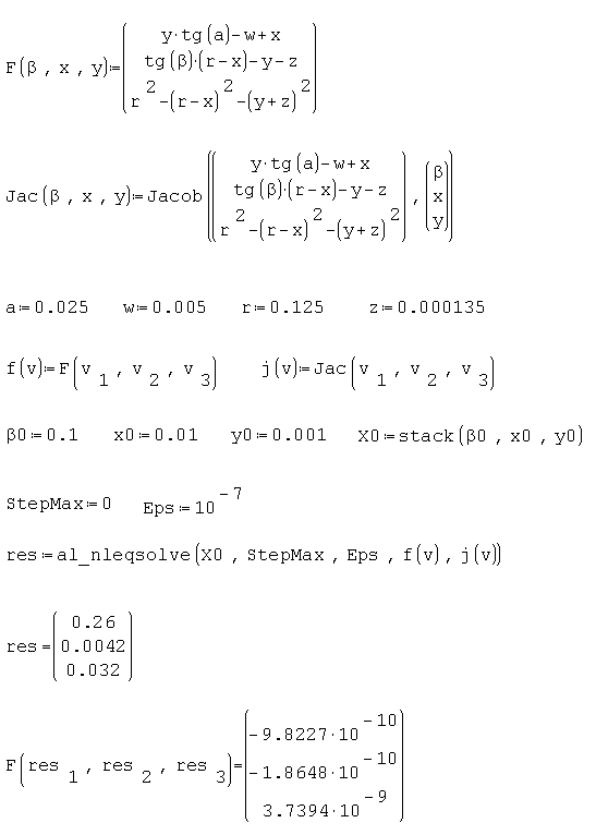

#9 Опубликовано: 08.05.2013 12:57:13

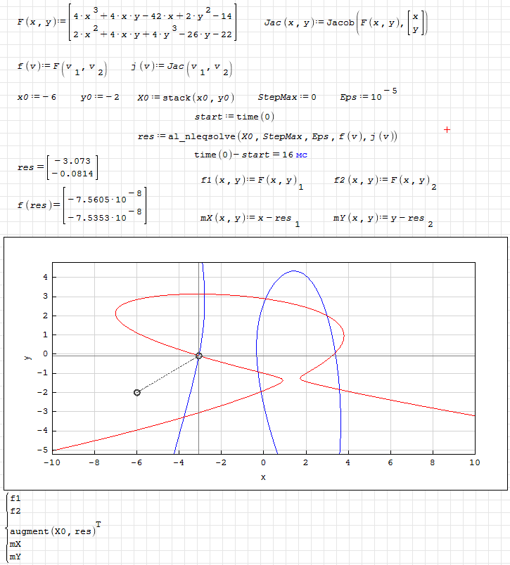

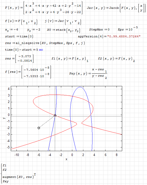

Updated. al_nleqsolve() function added (Levenberg-Marquardt-like nonlinear solver).
This algorithm solves system of nonlinear equations F(x).
Parameters:
X0 - starting point.
StepMax - maximum step length, >=0. Set StpMax to 0.0,  if you don't want to limit step length.
Eps - >=0. The subroutine finishes  its work if on k+1-th iteration the condition ||F||<=EpsF is satisfied.
Radovan Omorjan 08.05.2013 14:18:00

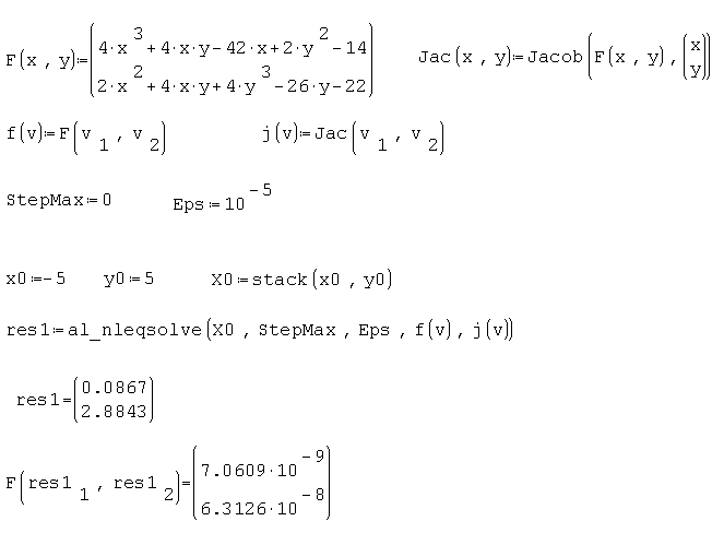

#10 Опубликовано: 08.05.2013 14:22:45
Thank you uni for this one
I could see that al_nleqsolve() will not work with
[MATH=eng]f(v):eval(F(el(v,1),el(v,2),el(v,3)))[/MATH]
[MATH=eng]j(v):eval(Jac(el(v,1),el(v,2),el(v,3)))[/MATH]
Is there any way to make this possible?
#11 Опубликовано: 08.05.2013 14:37:08
I think it is not necessary, since the function within itself already performs this. I need more examples. Try this solver at work.

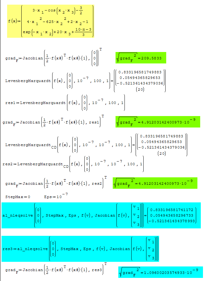

#12 Опубликовано: 08.05.2013 16:17:40
I just have some frustrating experience when the Jacobian is involved, and would rather appreciated some "derivative free" algorithms of this kind.
Here is just a playing with the NonlinearSolver plugin which includes Levenberg-Marquard algorithm and this one in AlgLib. For this particular example all performed quite well.
#13 Опубликовано: 08.05.2013 16:38:49
Thank you, Radovan. Unfortunately, this interface is defined by the function.

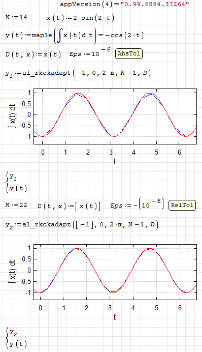

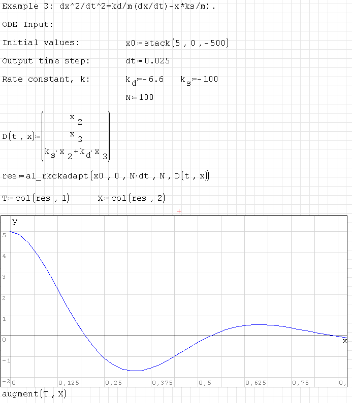

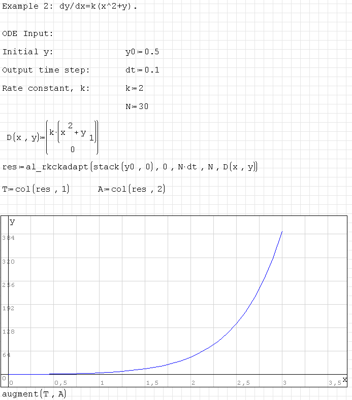

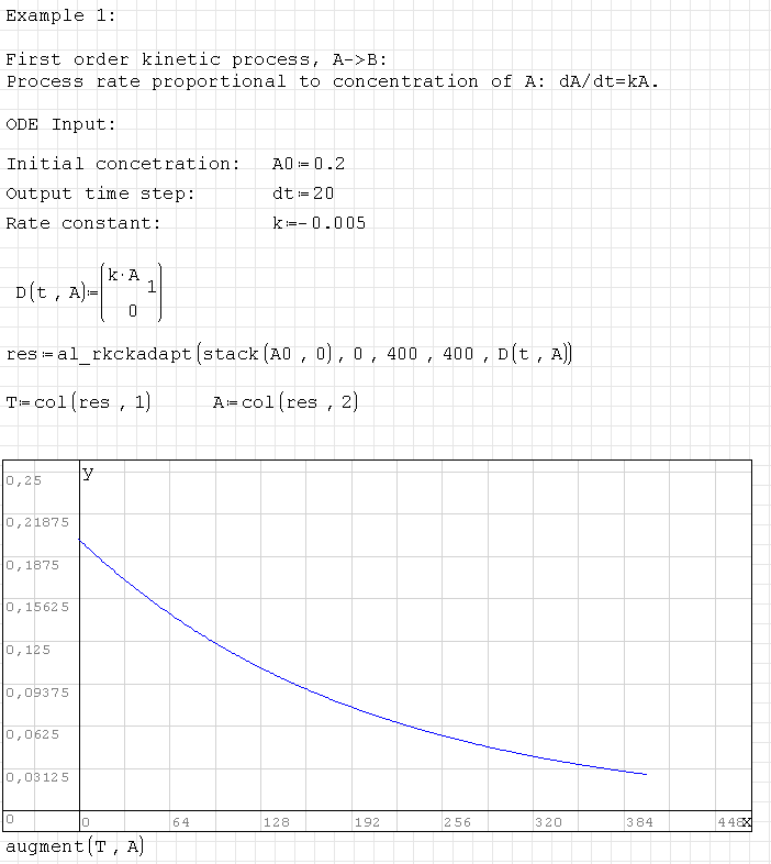

#14 Опубликовано: 11.07.2013 19:04:23

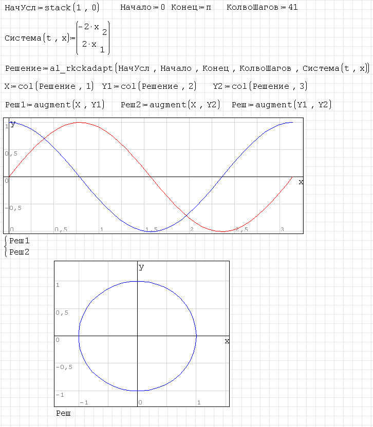

Updated. al_rkckadapt() function added (Runge-Kutta-Cash-Karp adaptive ODE solver).
You can compare with the examples from here: Using the AlgLib ODE (Runge-Kutta) Solver with Excel.

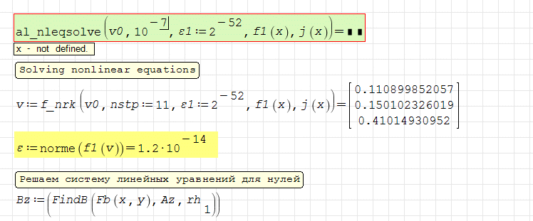

Some problem in the latest plugin. Another solver f_nrk(...) works fine.
x is formal parameter, how I can define it ? Optimization is numerical, the same for both solvers.
#19 Опубликовано: 09.07.2018 04:33:54
I need a complete example.
#20 Опубликовано: 09.07.2018 10:54:22
Igor Skarine
Igor Skarine
Hello uni,
Unfortunately I can't provide complete example, but if I pass to solver copy-pasted copies of the equations, it works.
See it below. The problem is that plugin can't read correct result of symbolic calculations, but solver written in Smath does it right.
