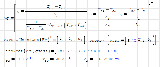

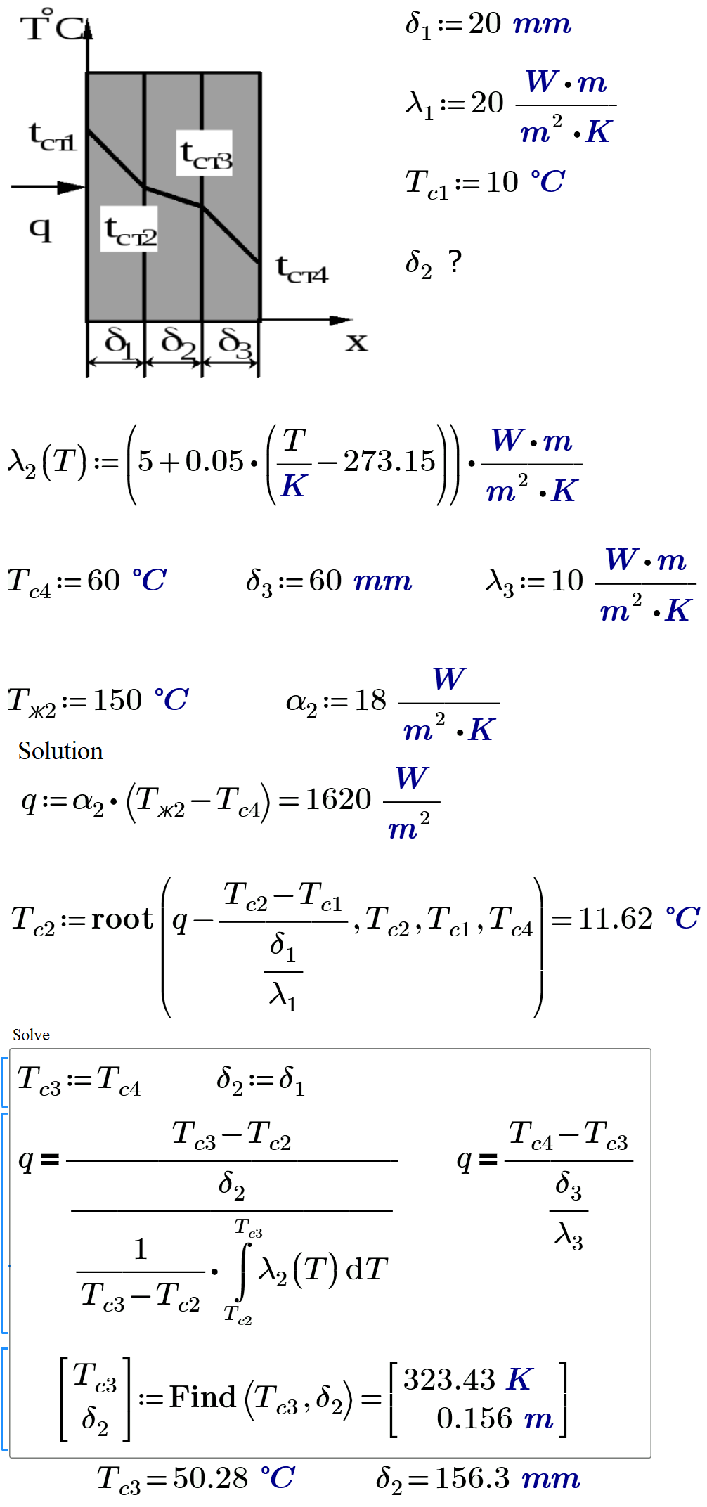

I can it solve in Mathcad - see please mcdx and pdf files
I try solve it (heat transfer) in SMath - see sm file
Help please
Файл не найден.Файл не найден.Файл не найден.

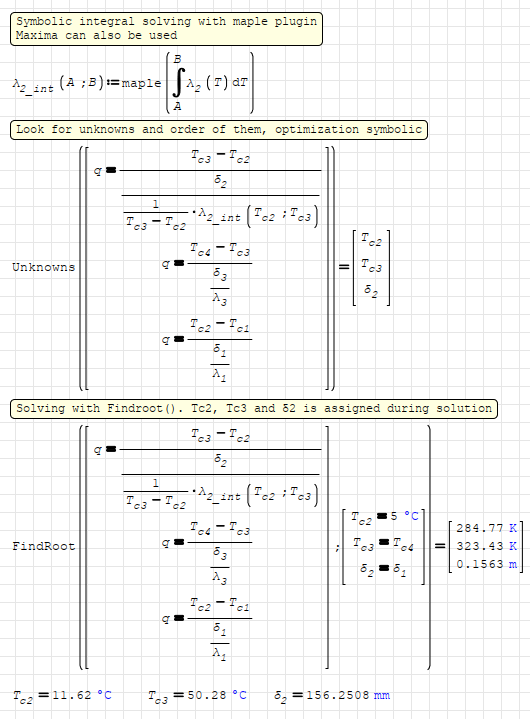

SMath symbolic solving of integration is not capable as Mathcad.
Thus integrals can't be used with numeric solvers.
However, you can use a little trick to solve them.
Using maple or maxima plugins is the key.
Here is your problem solved with various ways, roots() and Findroot().
solvewithunits.sm (23,4 КиБ) скачан 1454 раз(а).

Actually, you don't need to find Tc2 first hand.
Findroot() can solve with all three equations at once.
All important is the order of unknowns.
Valery Ochkov 04.06.2023 12:03:00, sergio 04.06.2023 13:48:00

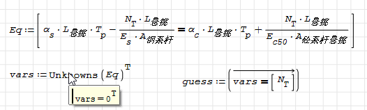

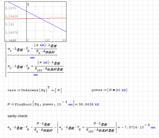

#9 Опубликовано: 26.06.2023 02:33:01
netsonicyxf
netsonicyxf
2 сообщений из 79 понравились пользователям.
Please help, why can't find root for this simple equation?
root.sm (20,2 КиБ) скачан 1419 раз(а).
#10 Опубликовано: 26.06.2023 05:54:06
Because there aren't unknows

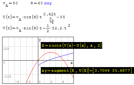

#11 Опубликовано: 26.06.2023 08:45:01
Please help,
why can't find root for this simple equation ?
roots solves wrt scalar function(s)
In this example, both functions are scalar wrt 'x'.
Try ... roots[(sin(x)-Gamma(x),x,1]
'x not defined' ... Gamma(x) is not scalar wrt 'x'
Few more numerical functions are not scalar
erf(x), erf(x,n) ... erfc(x), erfc(x,n) ...
#12 Опубликовано: 26.06.2023 08:55:02
In that case and similar ones,
RootSecant algorithm will spits out 15 decimals, instantaneous.
Cheers ... Jean.

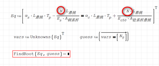

#13 Опубликовано: 26.06.2023 10:06:59
netsonicyxf
netsonicyxf
Thanks Davide.
Now I put "N" as unknown in the Eq. But it can't be solved either.
root.sm (19,41 КиБ) скачан 1382 раз(а).
#14 Опубликовано: 26.06.2023 10:58:58
You have to play a little with the precision, especially if there are units involved; in this case, seems that 10^-3 mm is a stable target (10^-2 works too, but in some case it returns the guess value, meaning that is "close enough" for the algorithm - you can see in the plot that 0kN to 200kN is in +0.02/-0.02mm range)
root_r1.sm (24,03 КиБ) скачан 1451 раз(а).
netsonicyxf 26.06.2023 12:18:00
