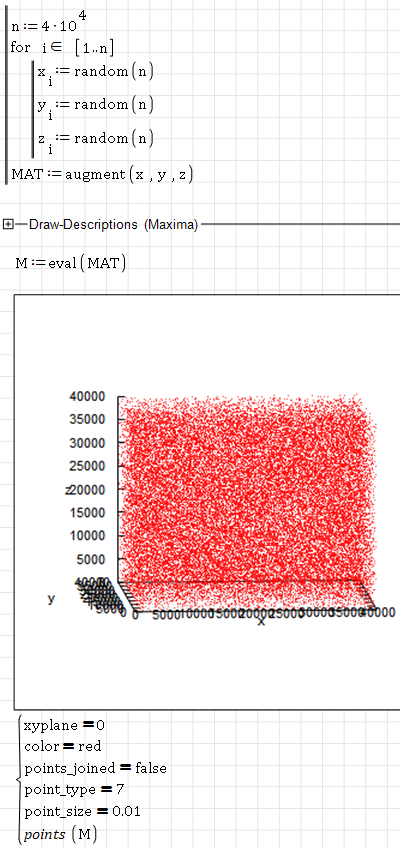

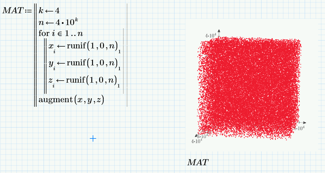

I think that a limit for stability is 40k points. Very difficult to rotate the graphic, but..it is a limit. A normal behavior I will consider until 5k points (to plot in ~5 s and easily rotate).
Again, thank you, because this will help me achieve my program (interaction volume for concrete design). And rarely I will need more than 5k points (I think 1M points was clearly an unthought exaggeration).
Here, the images:
SMath (40k points):
Mathcad(40k points): (plotting limit of Mathcad)
File:
Scatter plot_Kr-1.sm (152,43 КиБ) скачан 1823 раз(а).
