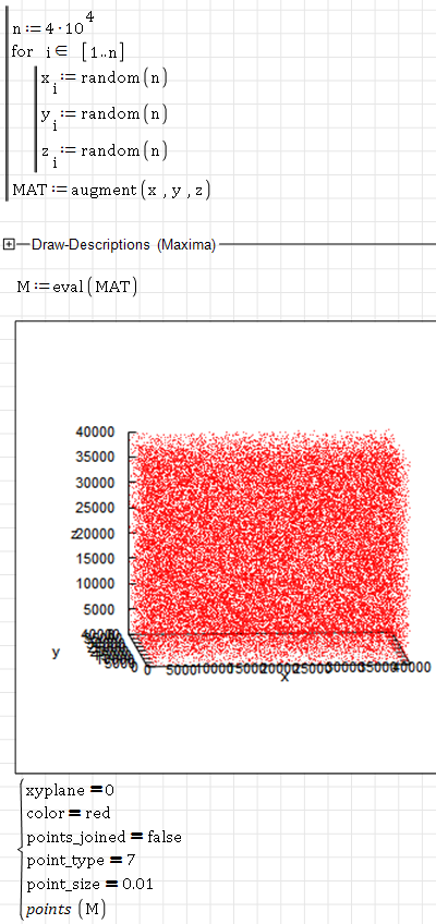

Scatter plots can be made using the Maxima plugin. I didn't respond initially, because the interface has never been tested with 1M points. Yet the backend gnuplot should be able to do that. I just don't know whether there are some limitations in the conversion functions.
The example uses a Maxima Draw3D plot region. You can interactively rotate and resize the plot with the mouse.
Scatter plot_Kr.sm (148,84 КиБ) скачан 2008 раз(а).

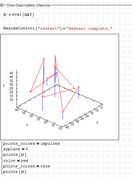

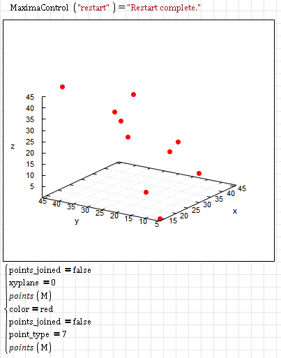

If the plot is sufficiently stable, you can remove the restart command.
You also can remove the first occurances of points_joined and points(). I just used them to demonstrate a selection of options.

I think that a limit for stability is 40k points. Very difficult to rotate the graphic, but..it is a limit. A normal behavior I will consider until 5k points (to plot in ~5 s and easily rotate).
Again, thank you, because this will help me achieve my program (interaction volume for concrete design). And rarely I will need more than 5k points (I think 1M points was clearly an unthought exaggeration).

SMath (40k points):

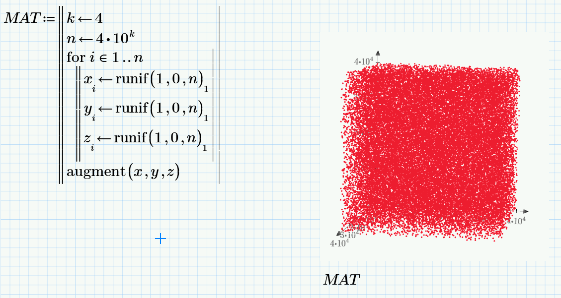

Mathcad(40k points): (plotting limit of Mathcad)

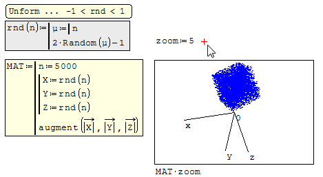

No problem to rotate the 5k graphic
24 Quaternions possible rotations ...
export the preferred angular system.
Would nice to add the cube outline.
Martin: what can you do with that in native SS 6179 ?
Cheers ... Jean.
Rotate 3D TREASURY_4 Quaternions MODULO Matrix.sm (45,96 КиБ) скачан 1861 раз(а).

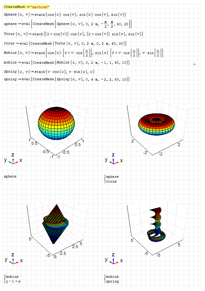

#52 Опубликовано: 19.08.2025 22:32:01
SMath Studio compatibility History page Changes AI Assistant

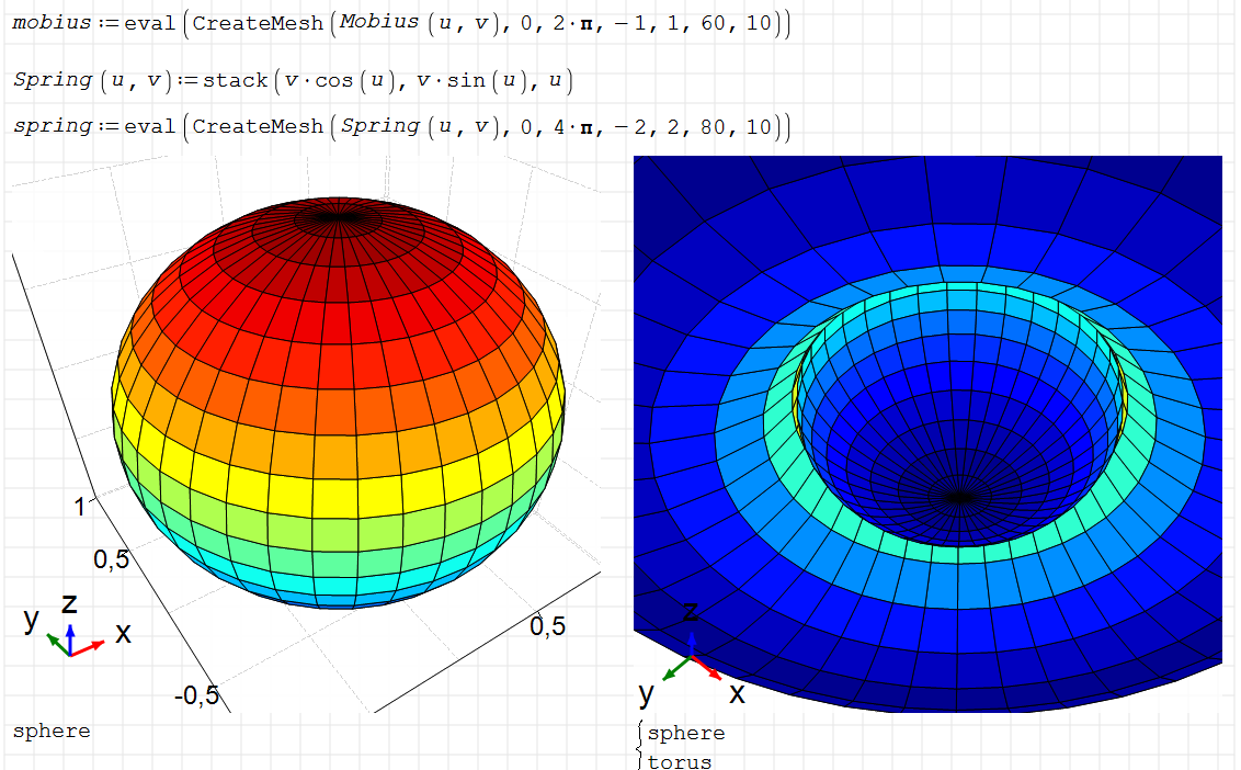

Plugin updated. [BETA]
It's very difficult to improve this plugin. Basically, I started developing it from scratch.
Changes:
- expression parsing has been improved;
- CreateMesh() function has been improved;
- automatic scaling function has been added;
- surface drawing algorithm has been improved;
- added many bugs.
plot3d-examples-draft.sm (11,38 КиБ) скачан 1399 раз(а).

#53 Опубликовано: 20.08.2025 08:37:50
Changes:
- improved mouse control;
- temporarily disabled autoscaling;
- added anti-aliasing when drawing.
Отредактировано 20.08.2025 08:39:22
