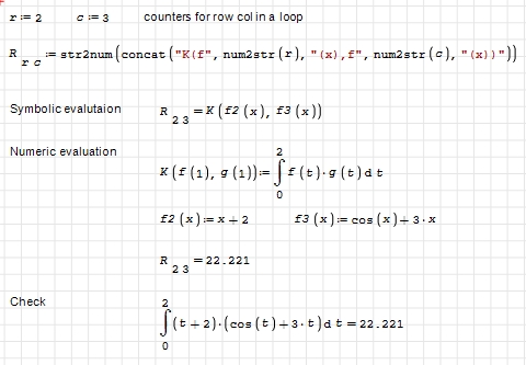

in my recent calculations I needed to have a function that takes two funtions as parameters
and calculates some values. Something like:
k_f(s;c)=s(1)*c(8)
k_f(sin; cos)=
Trying this in SMath Studio unfortunately failed.
Is is possible to implement such a thing in SMath Studio?
Yours,
Pawel Wierzba

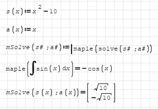

#2 已发布: 2021/7/7 08:32:56
1,443个赞,共2,936个帖子。
Yes it is possible, see the attached image
#3 已发布: 2021/7/7 09:31:23
Paweł Wierzba
Paweł Wierzba
0个赞,共6个帖子。
Thank you very much. Indeed, it works, even with functions with more arguments than one.
Sorry for asking a question about something that has already been implemented.

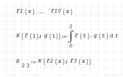

#5 已发布: 2021/7/7 10:11:06
Paweł Wierzba
Paweł Wierzba
0个赞,共6个帖子。
Thank you for the advice. Fortunately, standard way of defining functions is well known to me.
Unfortunately, I had to pass functions as arguments, rather than define them the "standard way".
I had several functions and some coefficients to be calculated, based on them.
Something like the example below.
If done the standard way, it would involve a LOT of writing.
#6 已发布: 2021/7/7 10:49:47
983个赞,共6,866个帖子。
Attach the document for understanding that mystic doing.
#7 已发布: 2021/7/7 13:23:49
Laurent Fournier
Laurent Fournier
9个赞,共66个帖子。
Beautiful!
I wonder why Jean is not so enthousiastic?

#10 已发布: 2021/7/7 15:22:21
1,139个赞,共1,805个帖子。
Hi. You can try a for loop with something like this in the body

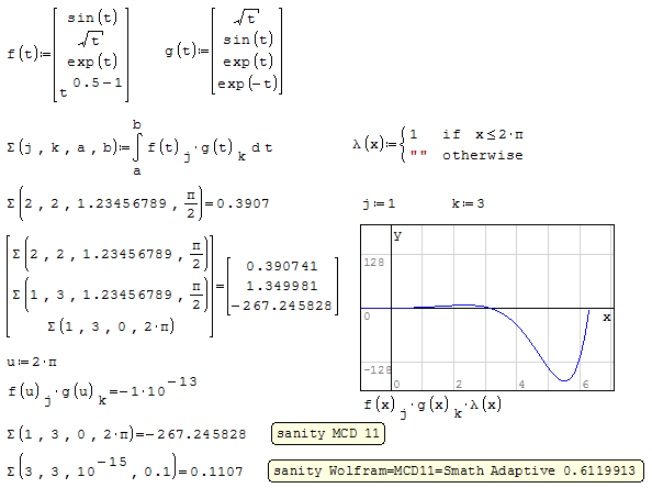

983个赞,共6,866个帖子。
#13 已发布: 2021/7/7 20:17:37
983个赞,共6,866个帖子。

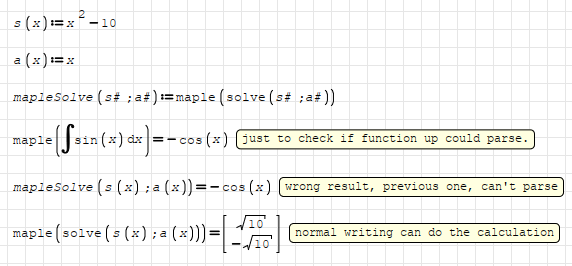

#14 已发布: 2021/7/7 20:56:00
600个赞,共1,381个帖子。
Interesting solution, promising to be very useful.
I wonder if it could be done with other functions.
It would really shorten a lot of thing if was possible.
Especially with external plugins function calls.
#15 已发布: 2021/7/8 08:36:54
Paweł Wierzba
Paweł Wierzba

#16 已发布: 2021/7/8 09:45:19
983个赞,共6,866个帖子。
Thank you for help, especially the comment about potential problems
with the integrator and illustrative examples.
I posted the wrong image ... that's the right one.
Don't drop dead by how far simple integration can fly in the blue !
#17 已发布: 2021/7/8 14:44:44
983个赞,共6,866个帖子。
Thank you for help, especially the comment about potential problems with the integrator and illustrative examples.
The 'thanks' button' never worked.
1. The previous image as *,sm
2. My Integration tool box.
Please, don't hesitate for + ... Jean
Integral 000000000000 vectorsf(j,k,a,b).sm (13.15 KiB)已下载 1753 次。
Integral 00000000 MASTER ToolBox.sm (477.13 KiB)已下载 1776 次。
#18 已发布: 2021/7/8 16:25:50
600个赞,共1,381个帖子。
Looks like line() mysteriously solve the issue.
I have come across similar to this behavior before.
#19 已发布: 2021/7/8 17:21:01
1,139个赞,共1,805个帖子。
Hi. For help understanding what's happen: that behavior is similar to the SetDelayed in Wolfram Mathematica language: https://www.wolfram.com/language/elementary-introduction/2nd-ed/39-immediate-and-delayed-values.html
