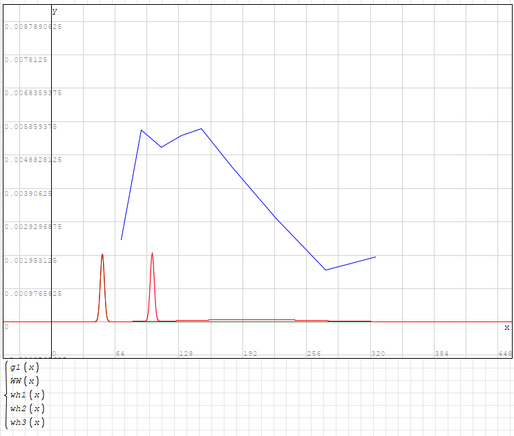

#5 已发布: 2021/6/9 08:38:18
anatolsen
anatolsen
0个赞,共16个帖子。
Dear alles,
Thank you for correcting my mistake.
But the desired result still did not work.
There, for some reason, the search of options stopped at the value of hh1 = 0.01, respectively, and hh2 = 001, hh3 = 0.01. That is, h1, h2, and h3 were only checked when the value =1.
Whereas I expected that the iteration of options should reach hh1 = hh2 = hh3 = 1, respectively h1 = h2 = h3 = 100.
For other parameters, it also seems that the search for options has not reached the end.
That is why the resulting graph shows a complete mismatch between the original data and the approximating formula.
I don't have an error in the If statement?
There I put continue in the else field.
eng-min.sm (32.5 KiB)已下载 1165 次。

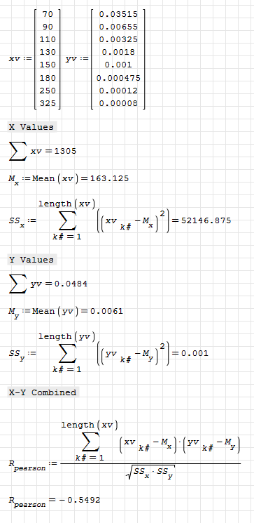

Regards.
Below you can find how to calculate Pearson correlation coefficient.
To sum all elements of a vector, you can use sum(1).
To operate piecewise you can use sum(4).
You can also use for-loop and while() to calculate something in a vector/matrix. Not demonstrated here.
pearson.sm (8.9 KiB)已下载 1217 次。
