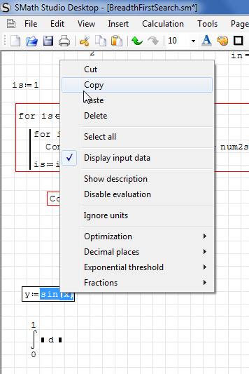

I am talking of very basic things in the normal usage of a program ( every program that we are accustomed to use )and an Example of the issue is in the e-mail of Davide.
However just to be clear let's try to do a definite integral of sen(x) from 0 to 1 in Smath.
I click on the Functions palette on the Definite Integral operator.
It comes up on the canvas ..then I want simply copy & past the sin(x) function that I have used 2 milliseconds before in another part of the canvas ..and this is NOT possible .
...And the same issue happens for all the other 3 operators included in my e-mail , for all the other ones in the same palette there is no such a type of problem.
Hope that it is clear the issue even if I haven't supplied a picture
Franco

Fixed in http://en.smath.info/forum/yaf_postst7361_RC3--SMath-Studio-0-98-5918--15-March-2016.aspx.

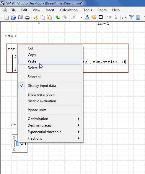

However I am famous for never give up ... and this is my new attempt in explaining what is happening, hoping to succeed this time3 ...with pictures
So as you can see a vary super basic operation is not allowed.
What I am trying to stress is the need for a CONSISTENT behaviour of the program using the same command of copy & paste with all the operators available on the palette and not with just a subset of them ...simply this.
Franco

WroteSo as you can see a vary super basic operation is not allowed.
It works with latest nightly build: http://en.smath.info/forum/yaf_postst7361_RC3--SMath-Studio-0-98-5918--15-March-2016.aspx
Just try it.
Yes it works fine Andrey , thanks a lot for the prompt fix.
Franco
