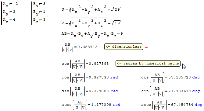

However, I cannot find degrees? I cannot find Angle in the insert meny at all?
#7 已发布: 2017/11/13 04:09:22
Magne Kristian Oen
Magne Kristian Oen
0个赞,共5个帖子。
Thank you!
This is exactly what I am unable to do! How do I make the trigonometric function return degrees?
Do I simply type the unit after the result? ( I am sorry if these questions are really daft!?)
Magne
#8 已发布: 2017/11/13 06:50:48
983个赞,共6,866个帖子。
All numerical functions are approximations in computing machinery.
Trigonometric function are in radian. If you want result in °
1. click on the empty place holder of the result,
2. click on the unit drop down menu from the tool bar,
3. click on ° or deg ... scroll down for 'rad' if you want result in radian.
