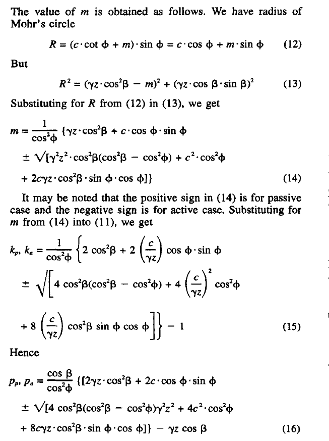

i want to solve below problem
m, ka, pa
i try to solve this problem
but i can't get result.
20230614_lateral earth pressure.sm (100.47 KiB) downloaded 1120 time(s).
Thanks in advance

Hi. Maybe the attached helps, but's hard to know. At the eqn 16 I count two open [ and only one closed ].

My suggested solution is in the attached.
Get more accurate solutions from roots(,,,)
LateralEarthPressure.sm (13.13 KiB) downloaded 1081 time(s).

Hi. Another way, plugin-less version. Have the advantage that can recognize the active and passive cases.
