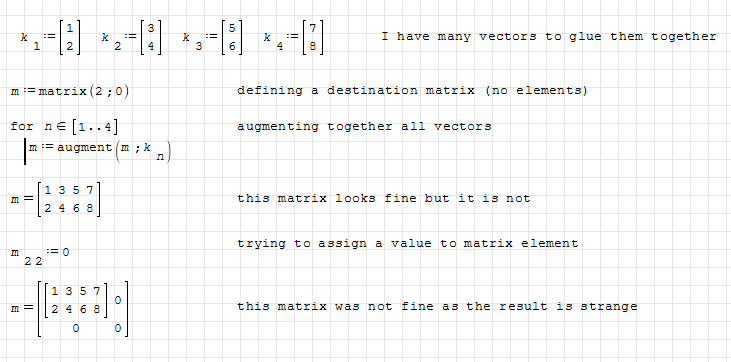

Hi, what am I doing wrong?
m matrix looses it's contents and dimensions after I assigned a single element.
Edit: I found an ugly fix. First I have to create matrix of (2;1) instead (2;0) elements. After all augmenting I have to use submatrix to get rid of first column.

#2 已发布: 2018/3/22 01:04:56
983个赞,共6,866个帖子。
Just like this.

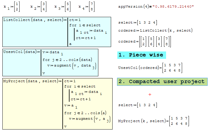

Here comes another example where I try to augment some vectors to new matrix.
I have many vectors and they are indexed so I can use program to augment them in a loop.

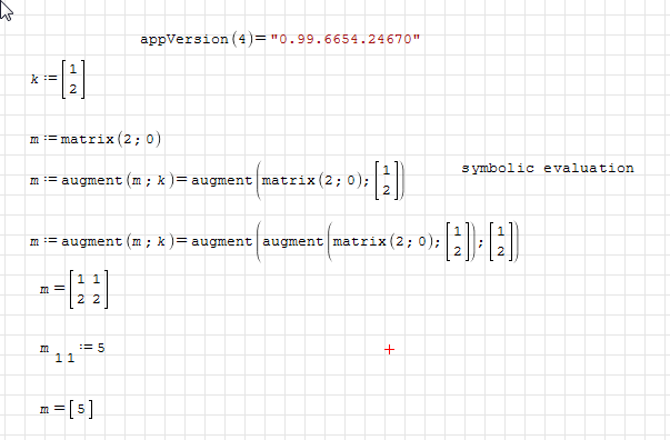

#5 已发布: 2018/3/22 08:08:01
1,362个赞,共2,276个帖子。
The issue is in the type recognition on the left hand side.
m is a matrix-valued expression rather than a matrix (expression with mat() being the top level object). We had this already with index values being expressions instead of variables.
Thus, the existing m is not recognized as a matrix and therefore not modified but overwritten.
You need to make sure that m is actually stored as matrix, i.e. by applying eval() or by just evaluating numerically (you did symbolically)
I'd prefer SMath to actually check if m evaluates to a matrix and then deciding what to do.
Ass_elem_Matrix_Kr.sm (5.67 KiB)已下载 973 次。

#6 已发布: 2018/3/22 10:21:30
983个赞,共6,866个帖子。
Ok, I probably did not clarify my real needs.
That will handle your projects more conveniently.
Poland.sm (15.33 KiB)已下载 990 次。

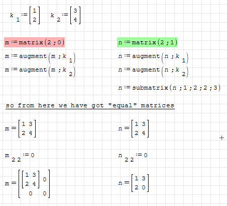

#7 已发布: 2018/3/24 15:39:26
m227
m227
4个赞和1个踩,共29个帖子。
Thank you for both your answers. It clarified the situation.
However I think if something looks like matrix it should behave like one. But it is not.
The history of building a matrix affects it
And I treat it as a flaw.
error_matrices_notequal.sm (8.49 KiB)已下载 988 次。
#8 已发布: 2018/3/24 19:01:20
1,362个赞,共2,276个帖子。
The flaw is that m is not evaluated before applying the by-element assignment.
you can, however, enforce this by setting the previous two assignments to numeric optimization in the context menu.
This complies to the survival rule "never use symbolic optimization unless you know what you are doing".

#12 已发布: 2018/3/26 08:55:23
m227
m227
4个赞和1个踩,共29个帖子。
Please be more specific about what you are attempting.
First of all, I want to say, that I like SMath Studio very much and I use it, whenever I have to prepare some calculations for students or in my projects. I once was co-author of book covering exercises in Mathcad. SMath studio is small, uncluttered and (mostly) does what is expected to do. And is free so I don't have to manage licenses, take care of keys and so on. I once paid some bucks to the author and gladly repeat it as program gets better.
But coming back to my being more specific: If I see matrix in the code (not necessarily mine) I expect it to behave like matrix and that's all.
Let's assume I got quite large project which can also reference to other files by include("..." ) add-in. So I have two matrices in front of me (see screenshot). I want to change a single element in each of them. Shall I go back and read all the code before to check if it can be done? The general question is: if we have two identical looking chairs shall we expect one of them not to be a chair but a briefcase with a chair in it?
#13 已发布: 2018/3/26 11:23:55
983个赞,共6,866个帖子。
Your original 'm' is a matrix.
Your concluded 'm' is NOT a matrix, simply a collection.
You can't apply any matrix calculation.
Make it a matrix and continue the project.
