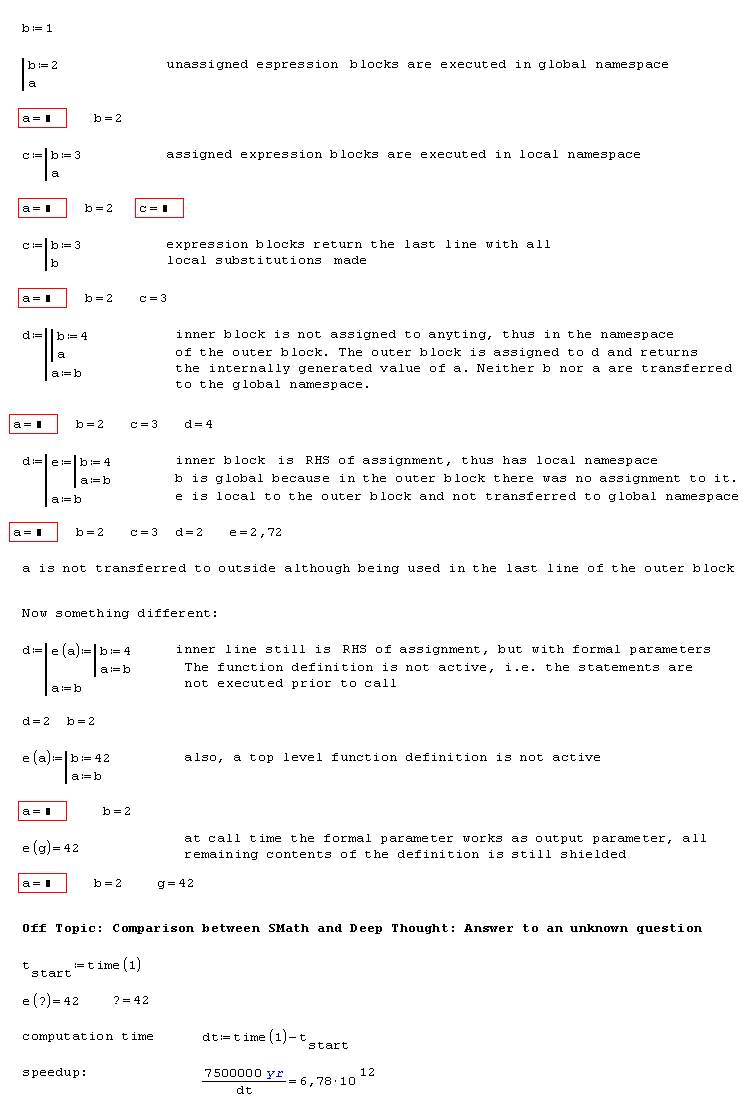

Here are some tests with the last line of blocks being assignments. Seems that in local namespaces these assignments are ignored and the block just returns the RHS of that assignment. Thus the assignment target is not transferred to outer namespace even if it explicitely appears in the last line of the block.
Also, for me it looks like that function definitions are inactive as long as the function is not called.
I might not have been complete in my explanation of the last line of the line function's behavior and therefore must clarify its behavior to remove any unresolved confusion. The last line funnels an expression, not to the general global environment, but to the LHS of an assignment operator in which the line function is the RHS. In your examples 4 and 5 you express a := b. The value of local variable b (not local b itself, nor the value of global variable b, nor global b itself) transfers to the global d. This is correct behavior as intended by the design of the line function in smath. The assignment to a in the last line is treated the same as in any other line in the line function and is therefore a simple assignment to local a, not global a. This again is correct, intended, and consistent behavior.
As you pointed out previously, a free floating line function does not have local variables, so the above behavior does not apply.
In all your examples 1-5, the behavior of the line function is correctly predicted by the rules we have learned from our prior experiences and our recent observations of its free floating use cases.
In examples 6 and 7, the functions d and e(a) are fully and completely defined by a line function on the RHS. If there is activity inside the line functions, it is all executed on local variables and cannot be ascertained by interrogation in the global environment. If we had the ability to use -> or = within the line function environment and have the calculated values show up from within the line function, we could tell. In the end, it doesn't really matter if they are active locally or not. What matters is the global effect. The effect on the global environment is what we must be able to detect and understand. Coming from within a line function that completely makes up the RHS of a function definition, the behaviors of examples 6 and 7 in terms of the effect on the global environment are exactly what we expect.
Function definitions in general do not necessarily contain line functions. Without that shroud, the operations taking place within the function definition are active in the global environment, are subject to the context of activity and variable substitutions prior to the definition, and effect activity and substitutions coming subsequent to the definition. Functions may be complex and contain parts that are globally active and other parts hidden by line functions. But the rules apply consistently to the individual pieces and make a predictable whole. I failed to mention this in my previous explanation.
As for your example 8. Finally, somebody has seen the face of god and brought the answer to the nature of the universe back to us mere mortals. With the mystery now unveiled, the stars will burn out one by one, eventually leaving a dark and physically lifeless, but fully spiritual universal existence in its wake.

#15 已发布: 2012/12/16 10:59:02
1,362个赞,共2,276个帖子。
Thank you again for the interesting contribution. Responding to all of the aspects will take some time, therefore I just take some of them.
In your for loop/trace example, the i is a local variable and no parameter argument is supplied to occupy local variable n, so the loop cannot execute in the definition. In fact, smath goes further and makes it a syntax error if a numerical value is directly used in the for loop range in this example of a function definition (this syntax error does not occur if the for loop is free floating, but only when it is in the RHS of an assignment operator).
If the formal argument n has a value or not does not affect the definition. You see that in the first section of the attached example. Still the loop is only executed if the function is called.
Thanks for explaining the term "active definition". My understanding is now: "A definition is active if embedded assignment operations are executed at definition time". Correct?
BTW, I never would have guessed that "for" or perhaps also other flow control structures create their own name space. At least, the iterator variable is local as long as it is not used in embedded assignments. To my taste this is one more time too much implicit scoping in SMath.
However, its different modes (numeric, symbolic), myriad structures (function definitions, line functions, for loops, etc), myriad operators (->, :=, +, -, ^, etc) make the set of rules complex and the effort to reverse engineer protracted.
Perhaps we have to add also differences in the program versions, as I fail in reproducing some of your observations.
symbolic evaluation - do you mean what are the rules for substitution to construct formulas that are defined or how does it do algebraic manipulations to simplify expressions?
Worst of all is the lack of the -> operator in recent SMath versions. The operator is available but is displayed as "=". Thus you cannot judge the evaluation mode by just looking at the doc. There have been discussions on what the effects of symbolic/numeric settings for functions at definition time and at call time are. Our recent discussion has really shed some light on that as well, might be worth revisiting those old examples.

Martin,
I have some more information about how the for loop behaves, at least in my version. I also looked into the issue with the imaginary number and discovered some interesting things, including some mishandling by smath.
For loop:
In my brief explanation in my previous post, I stated the index variable is local. I spoke too soon. Using i as the index caused its own quirky and misleading behavior. It looks like index handling is more complicated and its behavior using i is just a further complication. i is a reserved character, so we will talk about that later and not use it in this discussion. My latest exploration in my version shows the following behavior:
Using the for loop as RHS in an assignment operation:
Behavior upon definition:
- the LHS must have parens and at least one parameter for smath to use the for loop, or it won't create the definition
- the parameter must be that of the first value in the range
- additional parameters are permitted, but not necessary
- on the RHS, the index variable must be a single, naked variable, no embedded assignment is allowed
- the index variable has no local or global effects at definition time (it is inactive)
- the first and second range variables may be assigned to other variables and the assignment is active
- such assignments use global values the range vars had prior to the definition and assign to global vars with subsequent effect
- the body of the for loop has no local or global effects at definition time (it is inactive)
- embedded assignments are allowed in the body, but are inactive at definition time
Behavior upon call:
- a check is made that the number of parameters matches that from the definition, won't execute if there is mismatch
- parameter for index var is ignored completely by the index var
- value of global var with same name as index var is ignored
- in my version, the index var is global and its final index value has global effect after execution
- assignments to index var embedded in range vars are superseded by the index assignment
- assignments to index var in body of for loop become final value (from last loop iteration) in the global environment
- in yours, it only is global if used in the body of the for loop as shown in your example
- the first range var takes value of its parameter
- the second range var takes value of its parameter if it exists, if not, takes value from the global variable
- both range variables are strictly local vars unless assigned to, in which case their values are copied into global counterparts
- embedded assignments of the range vars are carried out
- if range vars don't have integer values execution is halted
- if range vars have values that allow body execution, it proceeds
- any embedded global assignments are carried out
Use of the for loop as free floating expression holds no surprises and behaves as we would expect with all global variables.
smath sometimes does not execute a call to the function after an editing change. F9 must be hit to recalculate. Don't know why. So when investigating, sometimes we examine expressions that are considered syntax errors and smath can be confused. It will mislead the investigation if F9 is not hit and we make note of a result that isn't real because smath forgot to recalculate. FYI. We must always make sure a recalculation is made after an edit in order to be sure that we are seeing the real effects of the edit on smath's behavior.
Imaginary number:
- imaginary i is reserved and smath confuses itself as explained below
- if reassigned in global environment i := 5, smath redefines i as integer 5 thereafter in the sheet correctly
- dynamic assistance will show as imaginary anywhere on the sheet before the reassignment and i -> 5 afterwards
- if used as an index in a free floating for loop (with no global reassignment prior), i will be reassigned properly
- HOWEVER, the dynamic assistance shows that if the for loop is RHS of an assignment, i is MISHANDLED
- i is not reassigned after function definition, this is correct
- i should be reassigned after function call is executed and this works correctly
- BUG: any i typed in anywhere on the sheet before or after for loop call is assumed by smath to be imaginary
- sometimes, doing so can cause other i's present after the function call to revert to imaginary
- sometimes moving an expression i-> will cause all i's after function call to revert to imaginary
- this only occurs when the change triggers smath to recalculate
- but only when smath forgets to recalculate the function call when it recalculates
- maybe smath is only recalculating below the i-> and if i-> is below the function call, the call isn't recalculated
- when the page is recalculated, the for loop's reassignment takes over again for all i's present after the for loop
- the for loop may not be the only example of this behavior and we should identify where it occurs
- BUG: is smath only sometimes recalculated and if so, why and why not?
- is function call sometimes not included, if so, why and why not?
- is this behavior a bug or feature?
- what are the rules for recalculation and what should I look for to make sure those rules are being properly followed?

1,362个赞,共2,276个帖子。
Rising Eagle,
Thank you again for sharing the results of your reverse engineering research. The length of the posts in this topic seem to follow an exponential law. I am asking myself if we are not in a situation where we use SMath to solve problems that we would not have without it.
For me, the right balance between joy and frustration is controled by how deep one digs. Therefore I try to be pragmatic and just limit the search to structures and procedures that we definitly would have a benefit from, should they work reliably.
Things like embedding assignments whereever SMath fails to complain, are beyond what I want to practice and teach. I admit that such experiments are good challenges for assumed rules, but I would try to limit the use cases.
Top level requirement is that things should look and work like handwritten formulas and algorithms on paper. So what are the expectations to handwritten code?
- Variable scoping should be controlled by entities like function or procedures with well defined input and output rules.
- flow control statements like while, if, for, line shpuld not interfere with variable scoping.
- Visual representation and internal handling must allow to tell imaginary unit from variable i. A math program should allow for safe use of i as variable in loops without spoiling complex calculus.
- Everything must be unambiguous, such that you can reproduce everything from printout. An example is the difference between name indices and adress indices. These can be identified by the amount of space. This is not always (never, so to say) obvious to the uninitiated but safe once explained. We had more serious issues with sums and their arguments.
Some of these expectations are still not possible to meet. Others are possible to meet by choice of the autor of the sheet. Best case is where SMath enforces the sheets to meet these expectations by complaining in case of non-safe usage (this sometimes happens in matlab).
The final result of reverse engineering should be a minimal set of survival rules. Examples:
"Never use i as variable name"
"Never use symbolic optimization"
"Never use 3D diagrams"
"Never rely on local scope of variables"
"If in doubt (or better always) press the re-calculate button"
"If the formula could be misunderstood, set braces, even if SMath does not require this"
"Never embed assignment operations except in the body of control statements"
The better the program becomes the less such rules are required.
