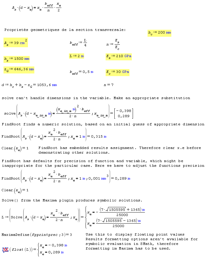

I am relatively new to SMath (have used Mathcad in the past). I am trying to use SMath to run some engineering calculations. Particularly, I am interested in solving equations - I have used 'solve' function, but always get a "no real roots" message (see file attached).

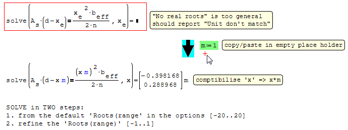

"NO real roots" from the solve bloc is an absolute pest [not to say stupid].

With regards to your responses, I appreciate the need to make an appropriate substitution to overcome the fact that solve can't handle units in the variable; However, I can´t seem to assign the unit to the variable, within the equation (apologies for being thick). I've tried typing x'm, tried using ctrl+w to assign meters unit to x, but still haven't managed to make it work. A bit frustrating... If anyone could be so kind to shed some light here, that would be greatly appreciated.

Type x*'m or x* and then insert the unit from the dialog into the empty placeholder in the right of the multiplication dot.
Multiplication operators in front of units aren't shown.

WroteI somehow missed the option to use the 2nd solve function with root limit, but I didn't need a plot for this, so I used it in one line and everything worked out fine.
If you don't plot, you will soon hit the wall.
That will help set the limits.
