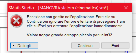

Hi, thanks for the reply.
Instead if I have an error like: "value too big or too small for an Int32", how can I solve it?
Every time this error appears the program stops.
MANOVRA slalom (cinematica).sm (45.07 KiB) downloaded 976 time(s).

10^10 was probably too small, you have to see, how small x can be for your derivative ψ''(x) still being defined. 0.01 works.
