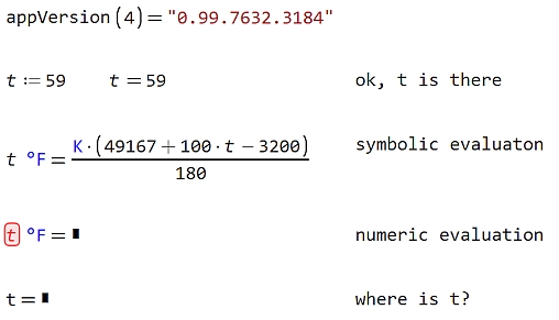

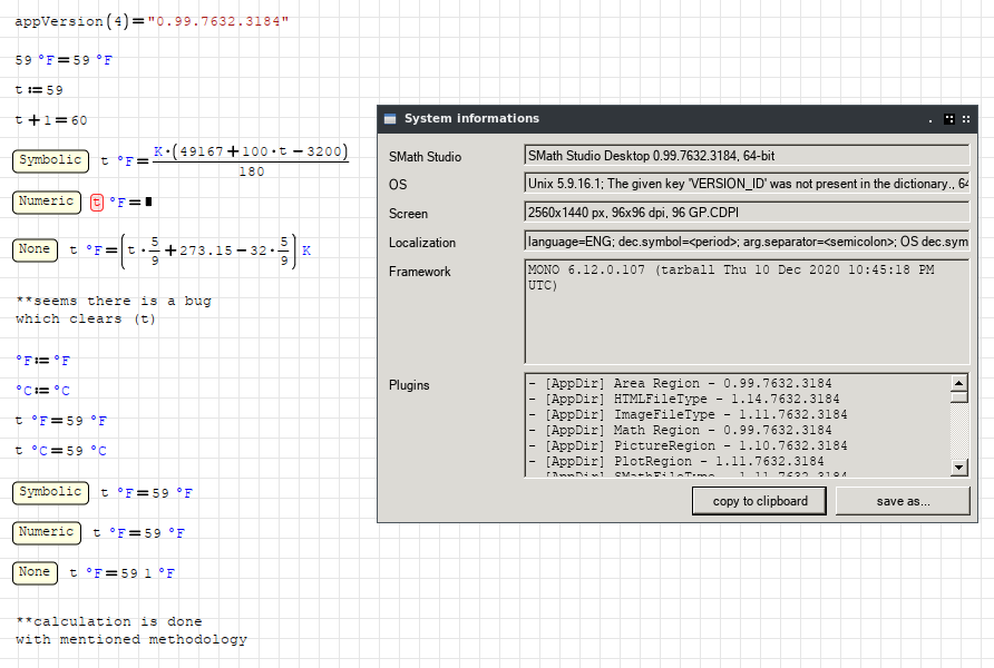

Hi. It seems that Fahrenheit degrees clears t.
Can anyone confirm this? I’m using the Mono version of release 7610 on Linux.
Yep. On Windows 10.
#5 Posted: 2020/12/26 23:59:38
Anders or Eric
Anders or Eric
4 likes in 40 posts.
Thanks very much for looking at that Alvaro. I had only tried numeric evaluation- I get the same result as you with symbolic evaluation.
It looks like you are in even worse shape than I am. The variable is still set to the original value for me after attempting to get a Fahrenheit value from it.
#6 Posted: 2020/12/27 08:03:02
597 likes in 1,377 posts.
Same in here with Mono.
