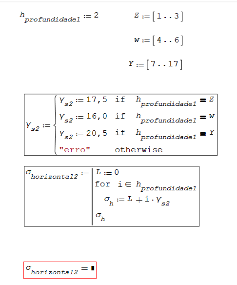

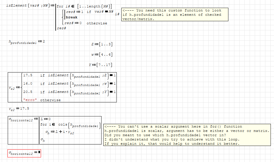

Good afternoon, could someone explain to me how to solve this problem I need that the horizontal voltage varies according to the depth however and the s2 gamma.
my input data is hprofundidade1 z w and y
TESTE TENSAO ADM MATRIZ.sm (5.41 KiB) downloaded 946 time(s).
#2 Posted: 2022/1/6 01:50:51
597 likes in 1,377 posts.
I didn't understand what to calculate in sigma function.
A little more explanation would help to resolve it.
TESTE TENSAO ADM MATRIZ_r1.sm (8.44 KiB) downloaded 965 time(s).

Hi. I think that this could be the solution.
I still don't understand purpose of for() loops. (not in your solution, original question)
Removing for()'s and calculating directly won't change the result.

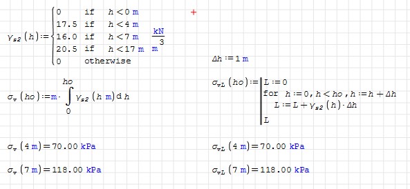

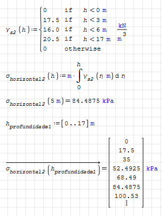

Hi overlord. I guess because using γ.s2(h)*h isn't correct, there the correct acumulation is γ.s2(h)*Δh
TESTE TENSAO ADM MATRIZ.sm (10.8 KiB) downloaded 936 time(s).

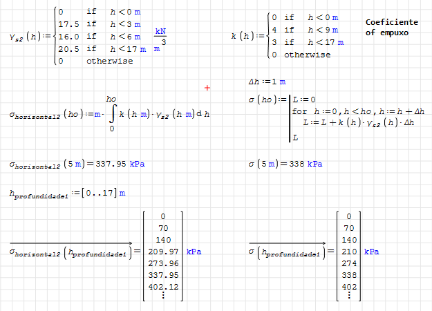

TESTE TENSAO ADM MATRIZ (in_situ parametric).sm (18.6 KiB) downloaded 1004 time(s).
PERFECT FELL LIKE A GLOVE is there a way to rotate the result of the graph 90 degrees?

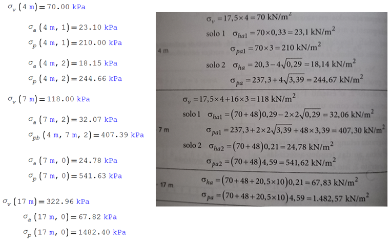

see the resolution of the problem in the attached image
This is a way to do that in SMath.
TESTE TENSAO ADM MATRIZ v2.sm (455.7 KiB) downloaded 1049 time(s).

... updated from Alvaro latest addition.
Cleaned image(s) for publishing the traced reference.
You can have as many sets of parameters [p,d] as you wish,
even of different length as long as you update respectively.
Cheers ... Jean.
Project Algo_Parameters.sm (661.95 KiB) downloaded 982 time(s).
