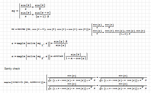

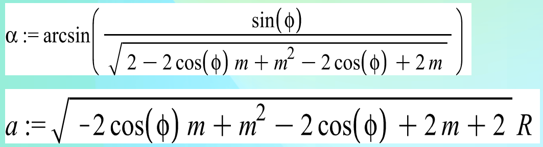

My friend use Maple to get symbolic solution like this
You can see that in the solution of alpha, there is no a, in the solution of a, there is no alpha.

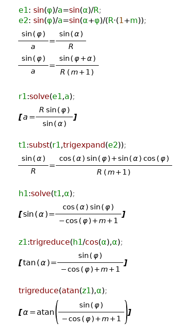

Here is α solved symbolically in wxMaxima.
Same method can be applicable for variable a.

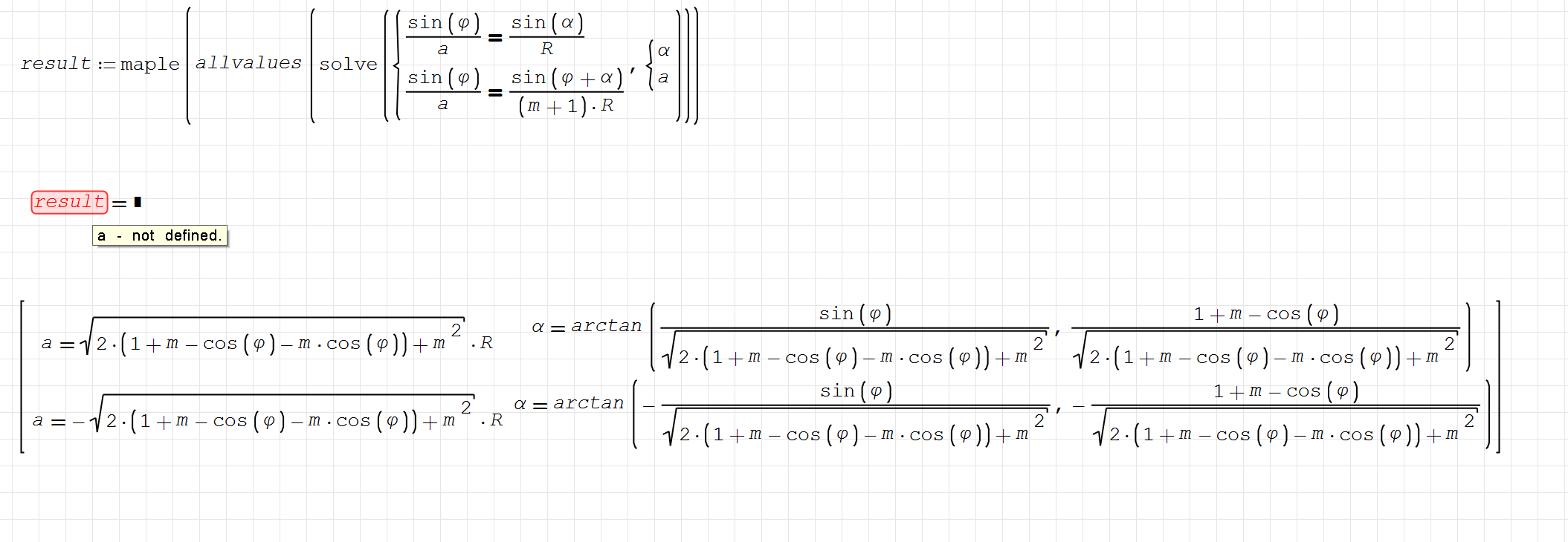

In the example below, I solved your function with Maple.
Though it gives the results correct, result matrix is cripled.
Copying and changing last bits of result ";2;1)" to ";2;2)" will correct the result.
";" may differ to "," according to your arguments separator.

Hi overload,
When I open you sm I get this error

Is Maple plugin in Smath able to get symbolic results as Maxima does, but more
Hi overload,
appears in red, because the evaluation must be symbolic.
select the "result" variable, press the right button and in the type of evaluation select symbolic and that's it.
