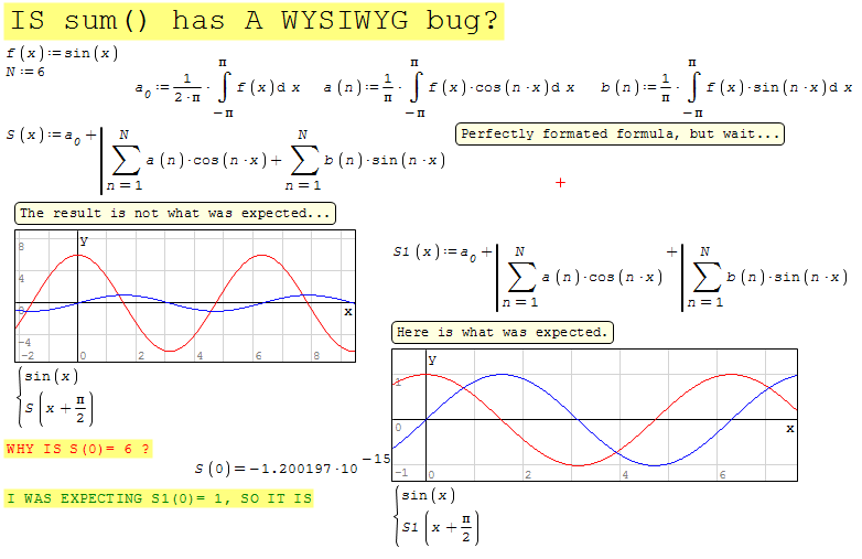

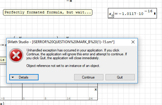

Attached sm file which appeared recently in the forum works in 7030 (stable), but throws errors in 7067 (Beta).
Some times it crashes when trying to evaluate some variables.
ISERROR QUESTION MARK_B (1).sm (18.72 KiB)已下载 1492 次。

Confirmed,
Sometimes crashed (red cross over the screen) and sometimes didn't.

Hi. I don't see a bug here, but some kind of issue handling n. About the WYSIWYG notation, it's well know this kind of difficulties not only in SMath, but in mathcad, maple and mathematica too. About the issue with n it must to be solved using Clear, because n isn't local in the sum.
ISERROR QUESTION MARK_Clean.sm (10.4 KiB)已下载 1506 次。

Thank you Alvaro, you are right
This problem with summation will come up here and there. It would be enough to put the summation terms inside a single line environment. This behaviour is present in SMath for quite a while. This is easy to forget, but it should not have crashed in those cases. The problem is how to remember this issue and overcome situations like this one.

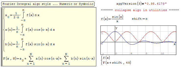

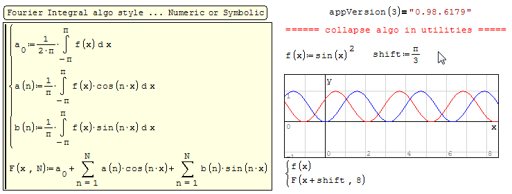

Try this Fourier-algo style.
Fourier Integral Algo Style.sm (7.66 KiB)已下载 1443 次。
Leave default integral acc 100, only 'N'
Rejects SQRT(x) but takes SQRT|(x)|
Try more ... let us know about your version ... Jean

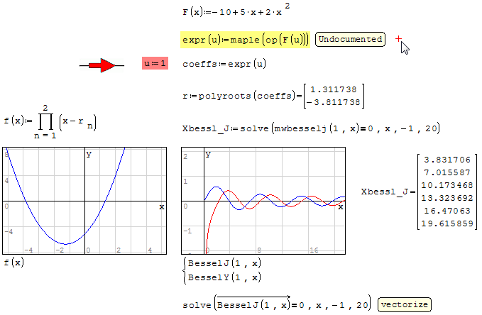

The attached sm file also crashes some times when inputs to Polyroots, solve, maple(solve)
are changed or adjusted.
Roots_Ex1.sm (16.06 KiB)已下载 1415 次。

Tried but it did not crash.
That shouldn't happen, but maybe on latest beta.
1. Polynomials have unique Lagrange format [lot many books are wrong].
2. maple(op(F(u))) will save you manual steps and possible typo errors.
Maths eigenAll Companion.sm (62.14 KiB)已下载 1407 次。
