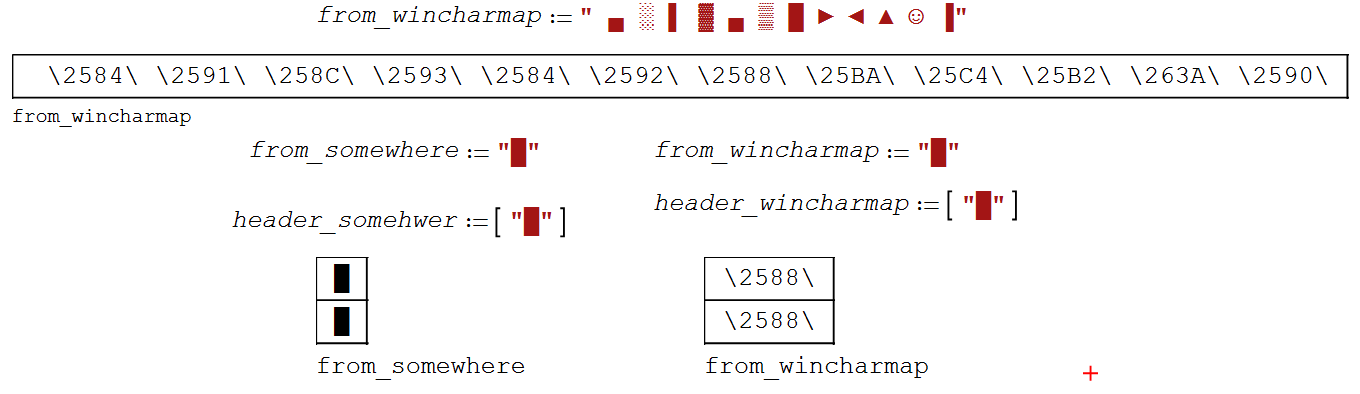

Thanks for the tip, Jean, but it is not working either.
I compare the behaviour of a █ symbol a got somehwere in the internet versus the one provided by win charmap and get the following:
By the way, both SMath and Table Region are updated.

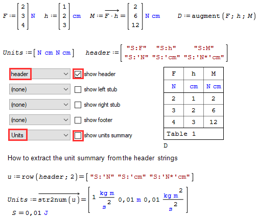

Feature request:
I propose to allow the units summary to accept also vectors of string-coded units (as used in the header)
Benefit:
- Display of the unit summary would be possible with nice pretty printing
- Guaranteed consistency between units applied to the data and displayed units.
In fact, it would be best to avoid encoding and to dirctly specify the units. Yet that seems to be impossible as long as the storage is only in base units.
The example below shows how to extract a valid unit summary out of a header with string-coded units.
Tableunits.sm (18.42 KiB) downloaded 1449 time(s).
