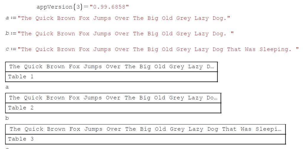

Thanks for the work with this plugin, it has proven to be a very useful and much needed feature.
I am however having one small issue. My table displays fine within SMath, but when I print, depending on how many characters there are, the table cuts off.
This is only when I print.
Is there something in the settings I am missing?
All settings are default in the attached example.
Thank you!
Confirmed. Unfortunately string scaling is driven internally by the .NET framework (here the ssue is how letters are spaced), so there aren't easy fixes. I'll think if I can do something however, thank you for reporting.

Carlos,
I wish it where that easy. Unfortunately, as previously discussed, as the number of characters increases, the more blank spaces you need to add in order to display the full text. In my particular situation, I am dealing with thousands of different lengths, having to figure out exactly how many spaces to add to the end hardly seems like a "solution," but rather a work around... which was also previously discussed.
Here is an example of what I mean. "a" has no space, while both "b" and "c" have each one space. As you can see "b" has 3 missing characters counting the blank space on the end, while "c" has 4 missing characters.
Perhaps there can be a way of counting the characters in a string and then having some concatenating function add the spaces automatically depending on the length?? Just a thought...

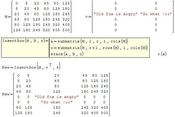

In this example [LM from Carlos], to ease the printing, the global table 'Sol'
has been rounded to 9 Decimals. This does not affect the full 15 of 'x' parameters.
"thousands of different lengths" of what ? ... poetry, numerical values ... ?
Matrix [round,n] in the collapsed area ... done SS 6179.
Levenberg_Marquardt_Code_CBG Model Copy.sm (67.9 KiB)已下载 1665 次。

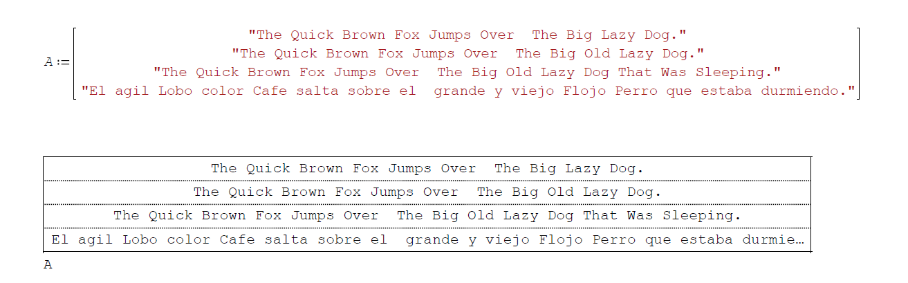

引用
Jean,
I'm working with a text string, as shown in my previous posts...
Not sure I follow your example and how it relates to my particular example. Perhaps you could elaborate more on it?
I'm mot referring to decimal places but rather just string lengt
I do not know what your objective is, the case I described was for use in titles, otherwise, you can use
a matrix without worrying about using spaces as in the example below.
Table_Space_1.sm (6.68 KiB)已下载 1554 次。

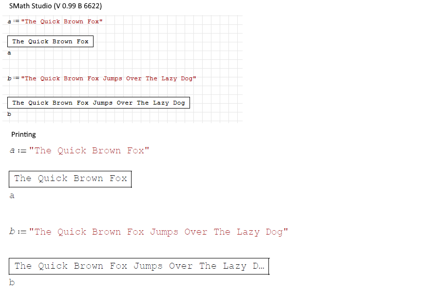

Thank you!
Carlos,
My original post describes my objective, but maybe it wasn't very clear? Typically I read through an entire topic so that I know what is going on, but that's just me. Not trying to be rude in any way, it just seems like I'm beating a broken drum when I have to explain the issue to every poster.
As you can see below in your example, when I PRINT, the table is cut off. All i did was download your sample and print it. As Davide said, this was an issue with the .NET framework. In any case, I appreciate the efforts to help. Thank you all very much. Hopefully Davide can eventually come up with something. In the mean time, I have used the concat() function to automatically add 4 spaces to any string i wish to display in a table. 4 spaces (as shown in a previous post) seems to cover most any length I will use.

Jean,
I'm mot referring to decimal places but rather just string length.
It just shows a numerical problem solved. The 15 native decimals result in
messy *.PDF as well as hard print. The demo exemplifies reducing the print
width if you are concerned with numerical values.
On the other hand, you can add any number of lines of text within a native
Smath matrix of data. Add line(s) anywhere => the text lines will be in
Smath default from the quote system "The wise fox ..."
I believe [not sure] you can add other symbols in the text vg: music symbol.
In most instances, final doctoring is only possible on original project.

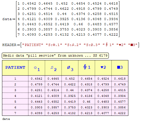

Hi, Davide!
I'm trying to use UNICODE symbols in tables, but they just don't work. I get \numbers\ instead of the actual symbol.
Is there another comprehensible set of symbols I could use inside this region?
Thanks!

Is there another comprehensible set of symbols I could use inside this region ?
In the mean time: from Win Charmap.
sergio 2020/8/24 09:48:00
