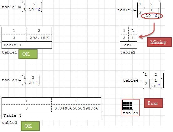

I found two issues within this plugin.
- Comma ',' as argument separator does not work probably when sub matrices are used.
- The degree symbols causes issues when sub matrices are used.
Please see my attached images.
Best Regards,
Infinity
Davide Carpi 2014/2/18 09:44:00
#34 已发布: 2014/2/18 09:44:56
1,443个赞,共2,936个帖子。
Thank you, I'll fix it

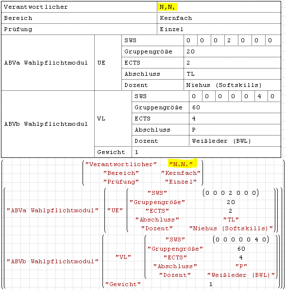

Unexpected results in Table Region. All but the first submatrices are collapsed to some strange number. Something went wrong...
NK TM1 13.sm (38.49 KiB)已下载 1693 次。
Davide Carpi 2014/4/21 13:36:00
#38 已发布: 2014/4/21 13:38:50
1,443个赞,共2,936个帖子。
Thank you Martin, bug added in the BTS (SS-120)
Best regards,
Davide
Martin Kraska 2014/4/21 15:53:00
