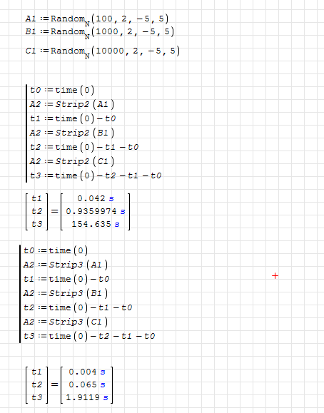

Hi Jean,
See attached. I've modified your strip2() algorithm [See Strip3()]. On my PC it performs same calculations ~10x faster. Might help with large data sets.

#24 已发布: 2019/3/28 12:37:37
Arie
Arie
94个赞,共285个帖子。
Here's some proof of that.

Hi Jean,

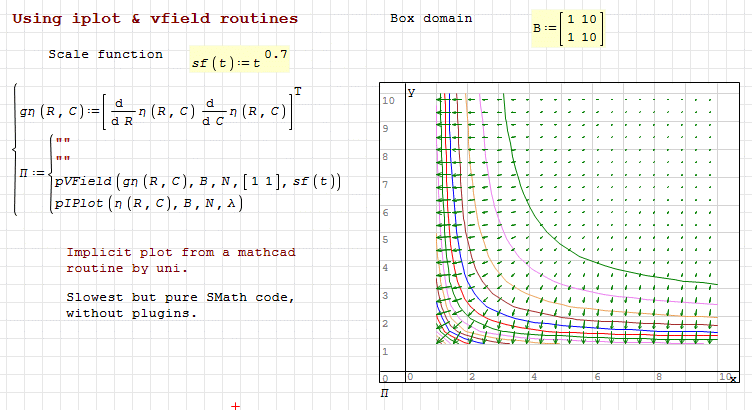

Thanks alyles ... Good job !

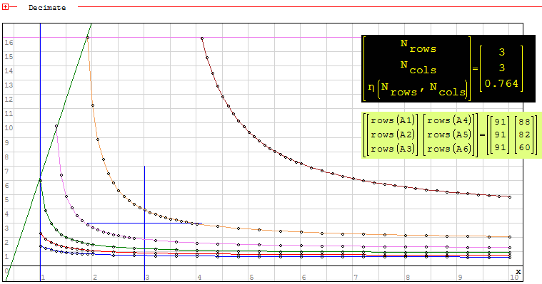

#29 已发布: 2019/3/28 22:29:22
983个赞,共6,866个帖子。
Hello Jean
Thank you so much. Very pretty. Best Regards. Carlos
Hola Carlos,
Few more things to improve presentation ...
Decimate part of the A1, A2,A3 . Confirm project is valid
particularly withe 'z' target in A solvers.
Project PileRedux_Factor_CBG [1].sm (30.8 KiB)已下载 1303 次。

Hola Carlos. Maxima shows 10 for both axis, IPlotSolve, by construction, only can take two vectors (x or y and lambda) but not 3 (x and y and lambda).
For pIPlot and pVField, just change the Box in 'B'. I take columns only one to five.

Hola Carlos,
... decimated plots are lot more presentable.
At this point, for a specific target solution
easy to get a Thiele analytical formulation.
In the mean time, I will test some decay model.
Project PileRedux_Factor_CBG [1].sm (46.98 KiB)已下载 1255 次。
