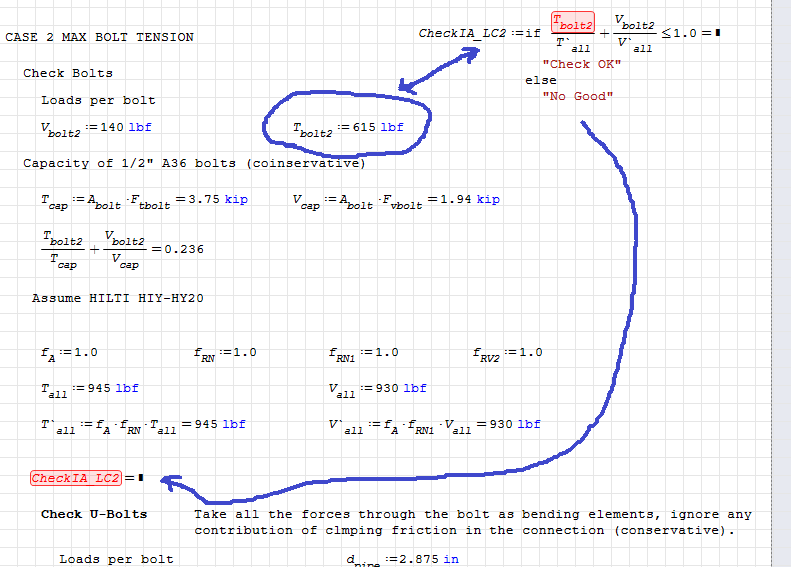

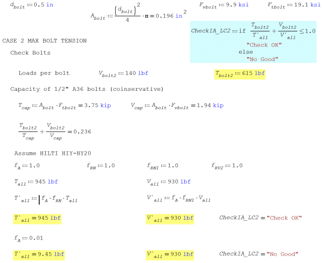

The error highlighting has worked GREAT so far, but today I ran into a case where it is highlighting the wrong equation variable. The error is actually that other variables I am citing are below the equation, but it seems that the first equation variable is getting flagged.

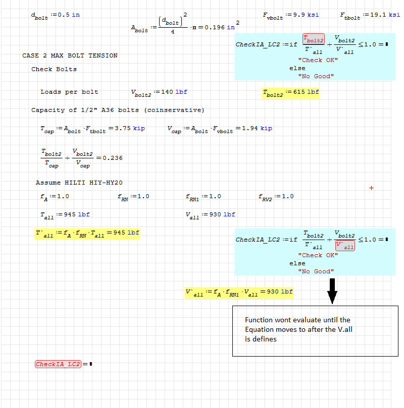

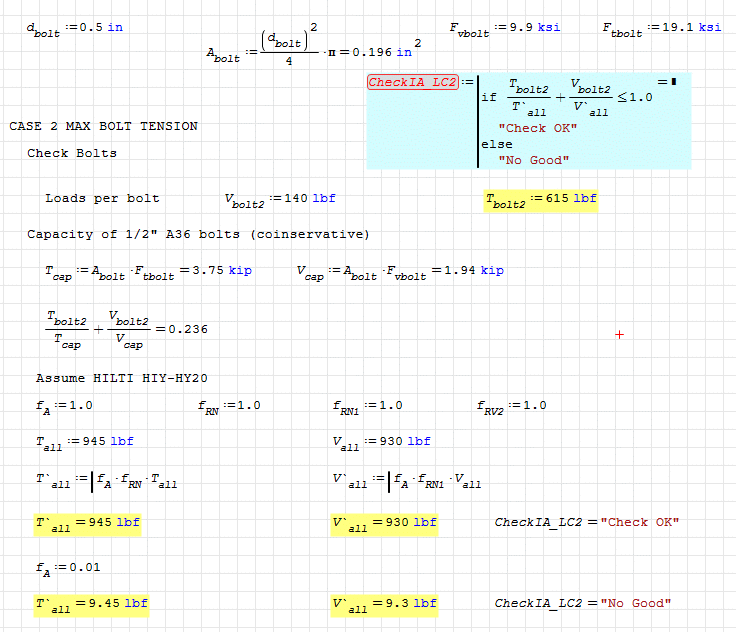

I noticed something else with this- if the function is defined ABOVE a variable that it uses is defined, then the error highlight triggers.
Then, when the function is evaluated below that, the function is highlighted, and the evaluation is halted too. So the error is flagged and the evaluation of the function is stopped.
Previously, I believe that the function was not evaluated, so that it generated no error. Similarly, the function results would be evaluated after the variable definition.
This is may be a real problem for those of us who define a bunch of equations well above where they get used if the evaluation of them is done after the dependent variables are evaluated or defined.

Hi sinneD. Without the actual worksheet it's hard to say, but I guess that this it's a feature of SMath (*), and you can prevent the immediate evaluation enclosing CheckIA with a line(...).
(*) see https://en.smath.com/forum/yaf_postsm7966_Function-as-a-program.aspx#post7966 for example.

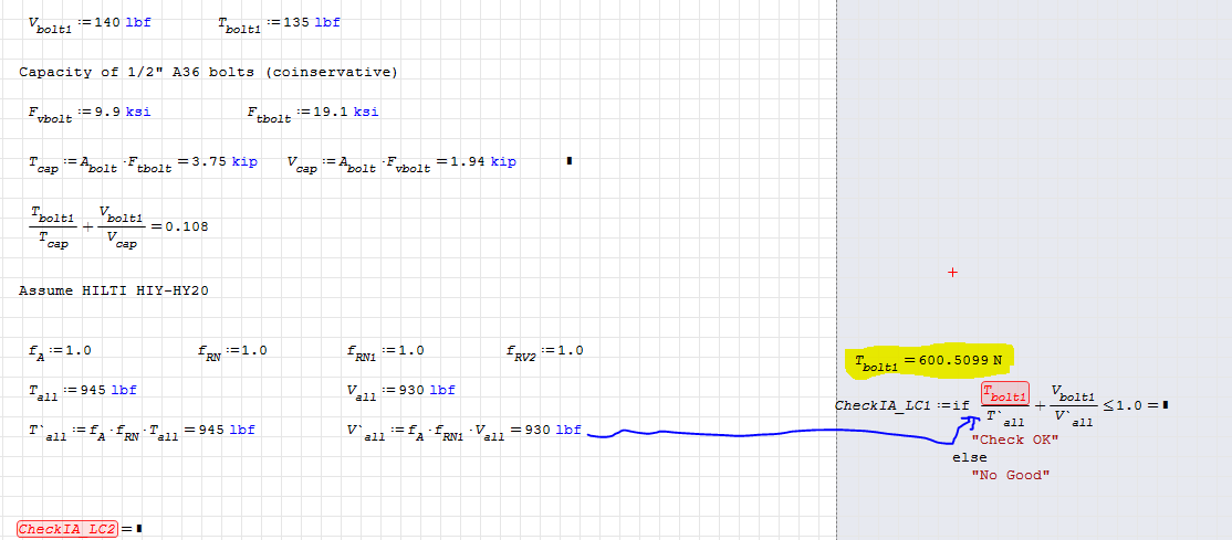

Here is a snippet from the original file-
error-highlight.sm (12.91 KiB)已下载 1282 次。
Previously, I recall that the function would evaluate at the end no matter where the function was defined or its evaluation status. I realize that I am asking it to evaluate before all the variables are defined.
Why are you doing that? If you remove the evaluation then CheckIA_LC2 at the end evaluates just fine.

Hi. Alyles it's right. Just don't force the evaluation in the definition of CheckIA. Don't need line(...) in this case. But this because none of the variables in it's definition have a value. See the effect of line(...) in T.all (with line) and V.all (without line)

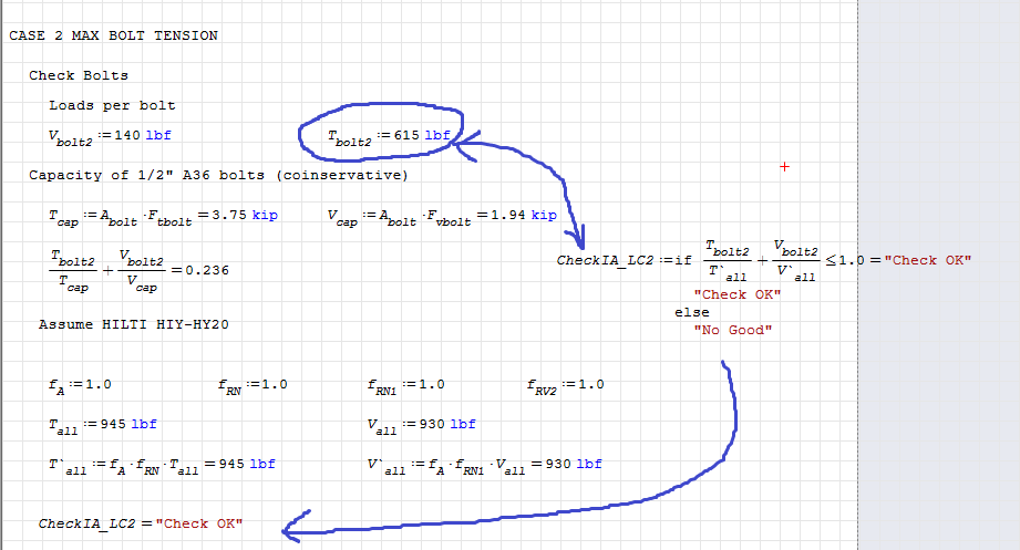

Yes, you are right, there is no reason to evaluate like this. I think I have gotten accustomed to not having the best coding habits, and the are now manifesting themselves. What I also chose to illustrate this might be misleading.
1. When I write logic/evaluations like this, Once I make the first on, I copy-paste for the additional cases I want to check right below the first instance of the equation. That way, if I had to edit the formula at a later date, all the instances would be grouped together.
In this instance, I the thing that am trying to Check Inter-Action for Load Case 2, hence the variable name CheckIA_LC2. The LC1 one was a page or two before that. LC1 and LC2 were one over the other where I first defined LC1.
2. I also usually leave them on the 'right page' that does not print because I only want the results at the end.
I moved the function definition to this part of the calc to try and figure out why the last evaluation was not working and condense the screenshot.
The major point I am trying to make is that previous versions of SMath might throw an error at the function level because the variables were not defined, but did not disable evaluation that is called after the variables have been made.

Hi. For that behavior you need the line, as in the attached: in red because can't evaluate numerically at this position in the worksheet, but give the correct result many times when it's variables have values.

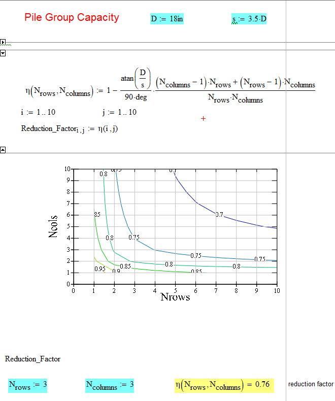

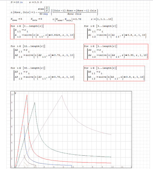

Here is another example, written from SCRATCH that again highlights an issue with the error checking. I am trying to re-write an old MathCad sheet I wrote under version 11 in SMath.
The only copying and pasting going on here is I build complicated formulas incrementally to ensure that I can back check the terms by hand before the final equation and output. You can see the progression in the worksheet.

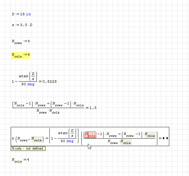

I am mystified why the equation is halting evaluation and noting that the N.cols variable is undefined, yet I can call it above and below the statement.
https://i.imgur.com/oRWzAWy.png
PileRedux_Factor.sm (6.12 KiB)已下载 1290 次。

It is not very consistent to use the same name for constants of fixed value and for the variables of a function. If you do, the evaluation of the function makes no sense except in symbolic form (as I did here).
PileRedux_Factor_ser.sm (7.74 KiB)已下载 1272 次。

this work for me.

The original MathCad i wrote maybe 12-13 years ago. I am trying to update it.
The equation was defined for graphing using the series i and j.
At the end, I find the explicit value by defining the actual numbers.
I am confused by why the EXACT same code works on your end but not on mine.
It's not the exact same code. Sergio uses symbolic evaluation (Ctrl + .) Same as right click clicking expression, changing optimization to symbolic.

I did not think of the symbolic evaluation. Thank you.

the difference is in evaluation (=), that is after the definitions.
do this in two step and then no error is show

This is an approach, maybe Jean or Alvaro, can Doctor it
PileRedux_Factor_CBG.sm (20.11 KiB)已下载 1304 次。
