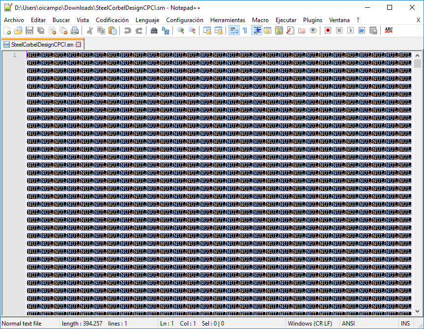

I opened your file on Notepad++ and I found that is full of NULL characters. Same you can see in any other text editos (atom, and so on)...
Sorry...
