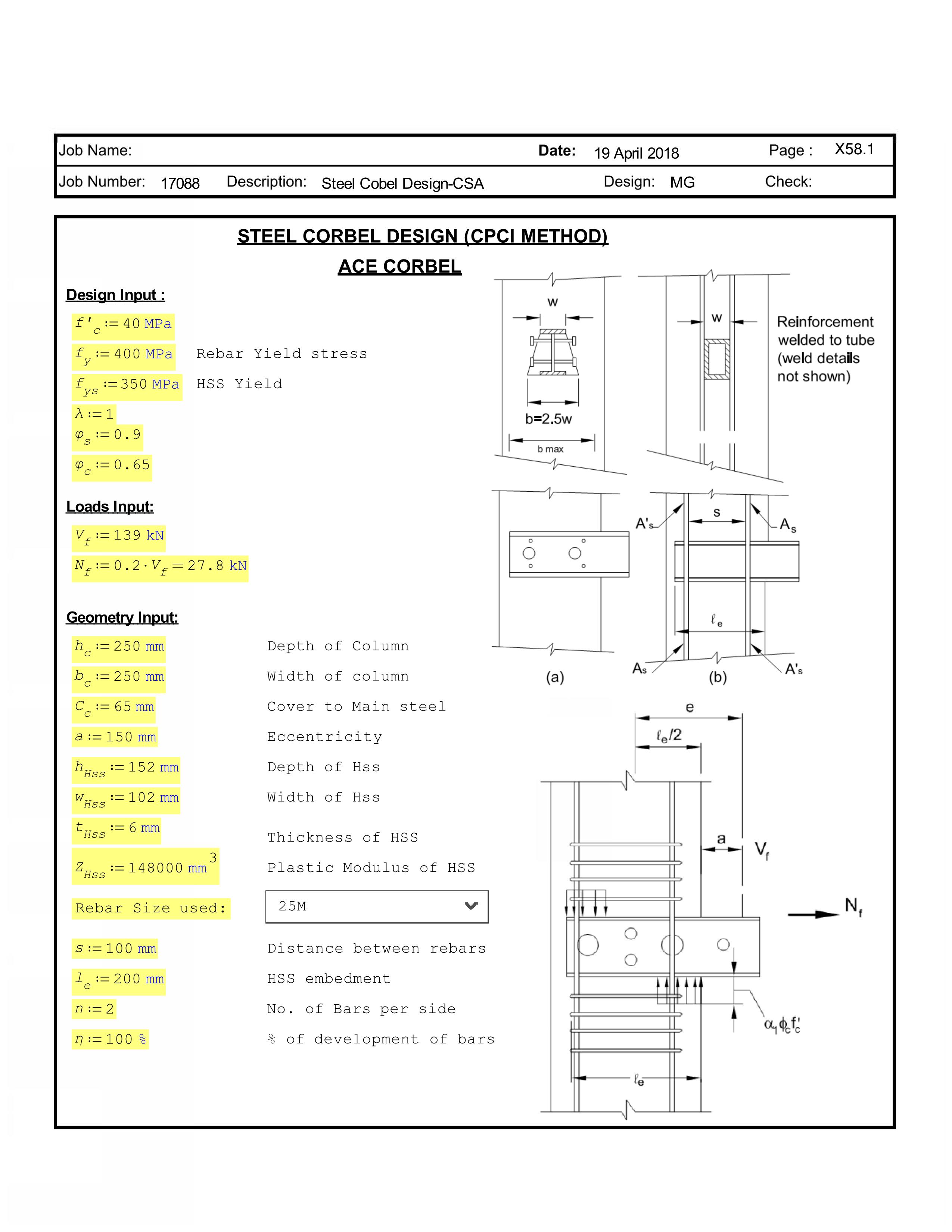

Hi, I was trying to open an Smath sheet but I always get this error message:
"Root element is missing"
the problem is all the copies that I have don't open and give me the same error.
Does anyone know how to fix this error?
I am also attaching a snap shot of the sheet that I had it printed before for reference.
Thanks
显示剧透
