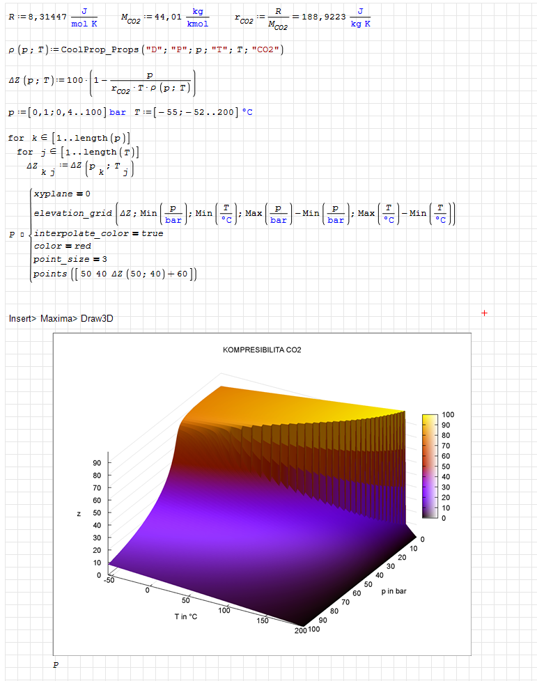

Hi, i would like to add some points to 3D plot. How can I do that?
And can i somehow make the plot smooth without using smaller steps in vectors?

You could try to create a mesh of triangles or quadrilateral objects. Then you are free to use a problem-adjusted surface parametrization.

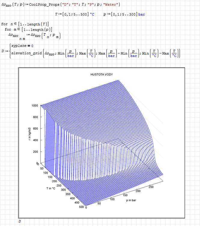

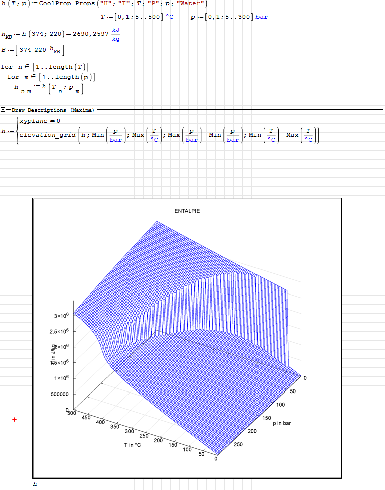

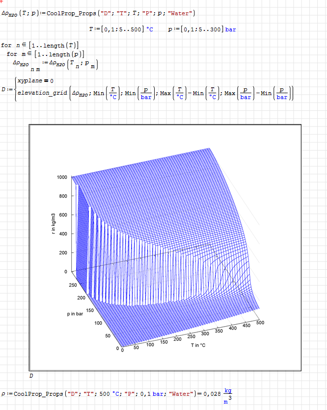

thanks for your answer. I have another question. I´m trying to make graph of water density, but the axes are not right, what is wrong?
hustota vody.sm (69 KiB)已下载 782 次。

Thanks you very much! That helped.

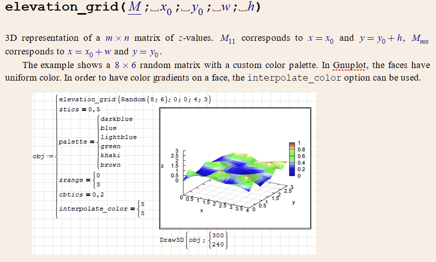

But if i want to make axes right i have to switch x and y axes in elevation grid command. I don’t know why.
hustota vody.sm (135.01 KiB)已下载 785 次。
Is there any sheet of something like that, where I can fing all comands for plots? And how can I write them, because commands that I used, I copied from some file I found.

See topic starter https://smath.com/en-US/forum/topic/cnc5Xp/Maxima-Plugin. I added some references there.

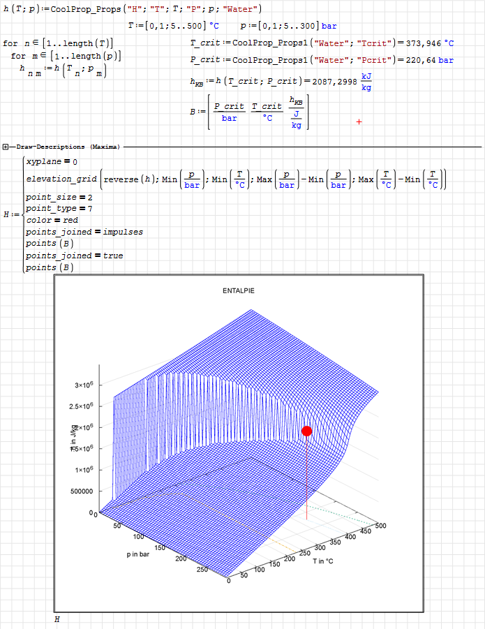

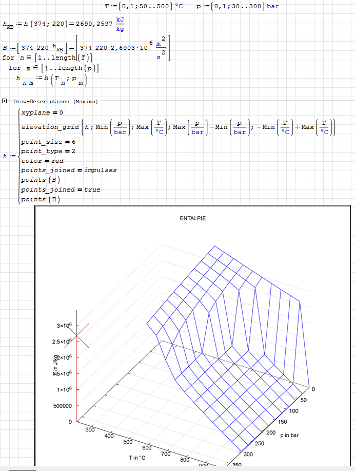

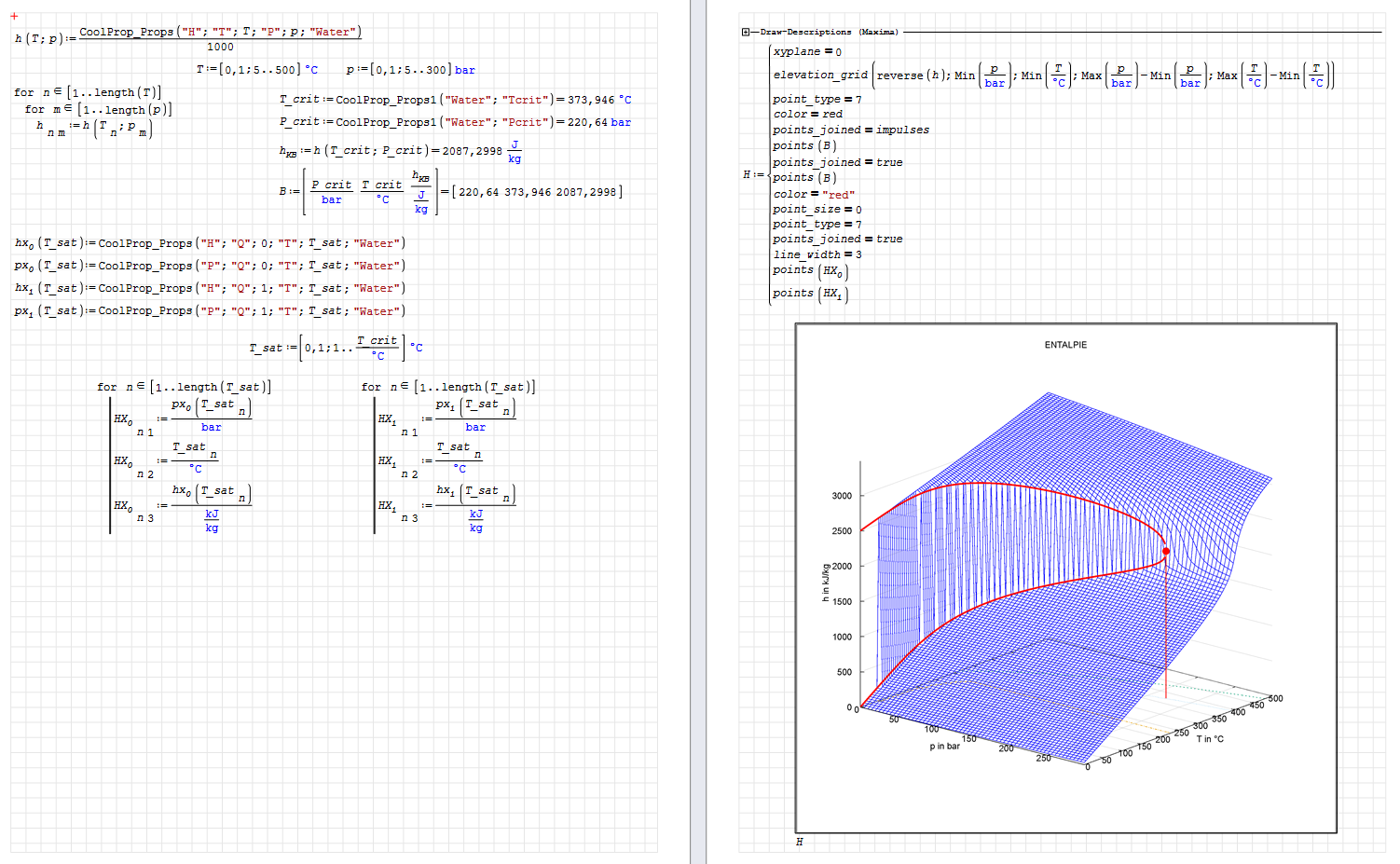

how can I add point B to plot? When I tried I make point or plot, but not both of them.
kriticky_bod.sm (202.22 KiB)已下载 788 次。

Thanks for answer,
I tried to fix it and I ended with this. Still can t plot graph and point together.
kriticky_bod.sm (201.86 KiB)已下载 744 次。
What should I do now?

You still have a negative h value (temperature difference). Reverse this (and also reverse the matrix). Then it should work.
Good to see. You also might display the z values in MJ/kg to get nicer tick labels and play around with the view parameters in the settings menu to avoid interference between axis label and tick labels.

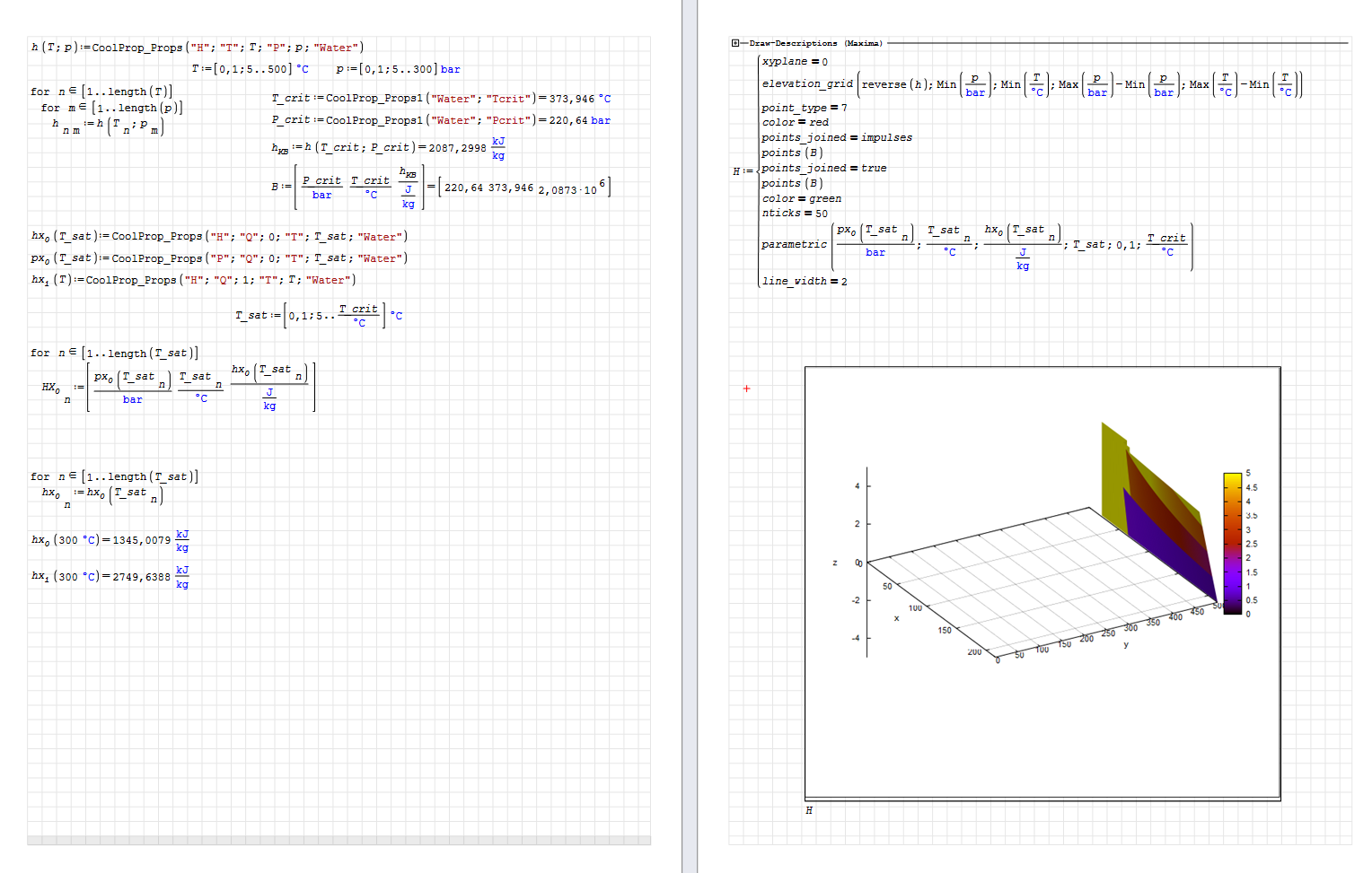

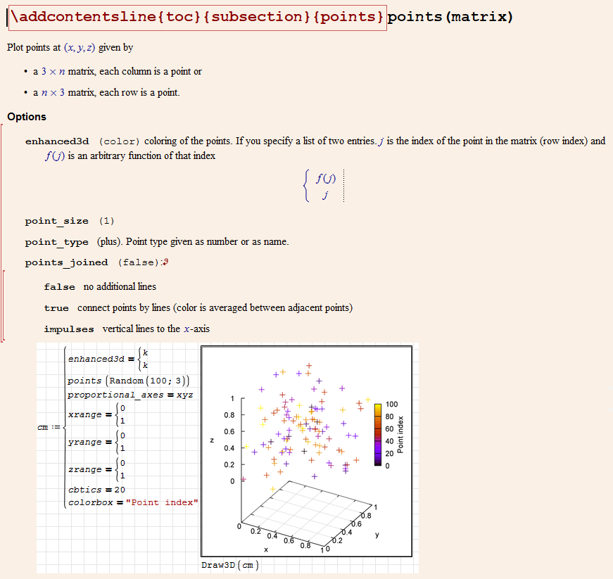

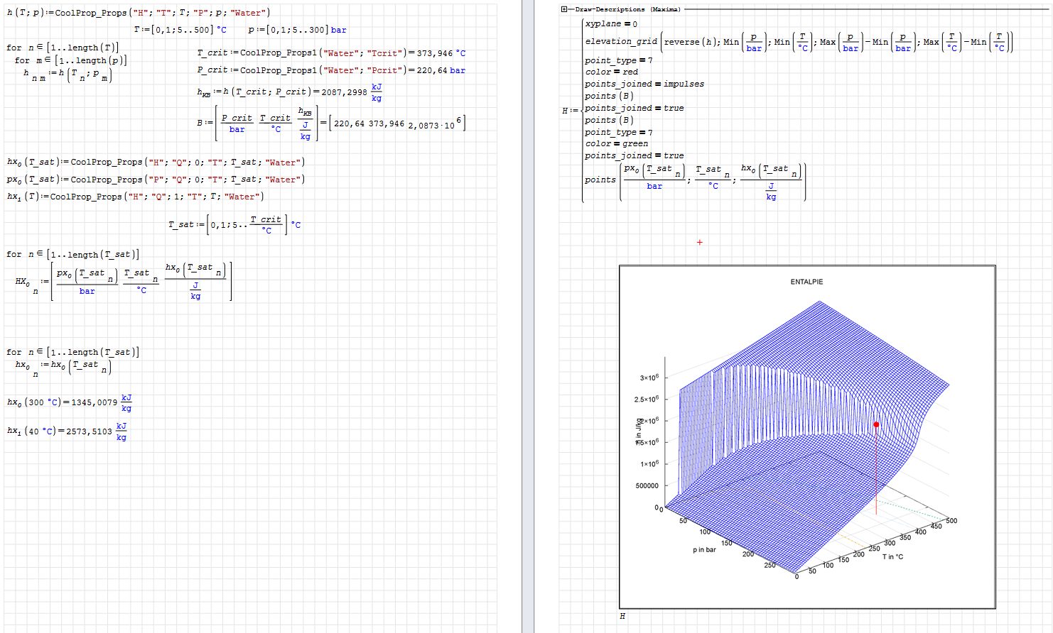

Now I would like to add saturation curve. Is it better to go with matrix or function? And how can I do that?
I tried parametric function, but plot did not work.
krit_bod_2.sm (211.84 KiB)已下载 749 次。

I guess it is best to use the points object just like for the single point. Set points_joined to true, point_type to something convenient. Using a function will work only if that function is supported by the interface to Maxima, which probably doesn't apply to coolprop functions or interpolated functions.

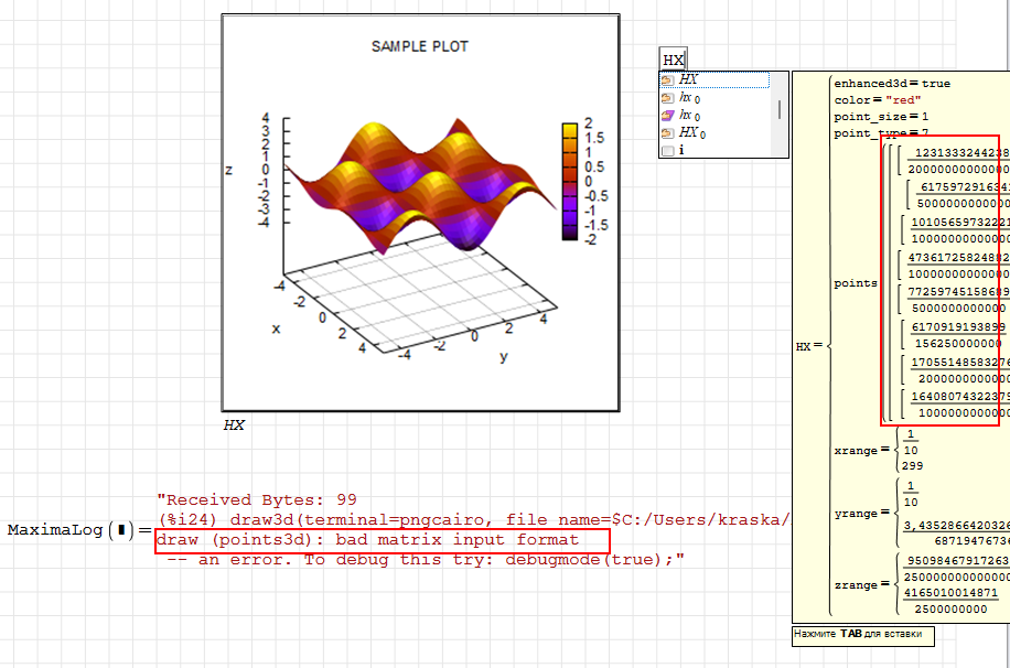

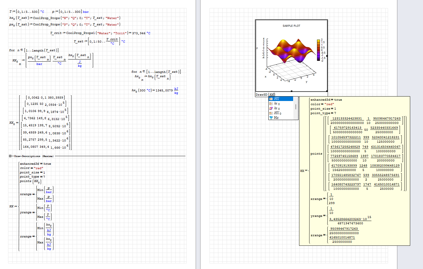

I’m back. I tried to create line of points by maxima handbook. Handbook is really great, but I couldn’t figure it out. What am I doing wrong? Matrix seems right.

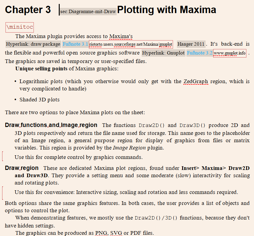

And i have another question. When I created plot of enthalpy I just wrote name of the "plot function". But in the manual, there is Draw3D("plot function"). Why is that?
saturation_curve.sm (194.75 KiB)已下载 691 次。
Thanks for your help and patient, I really appriciate it.
Tomáš

Your data matrix isn't in the correct format. It is a one-column matrix of row vectors. Make it a real n x 3 matrix, then try again.
Also, you use different units when filling the data matrix (J/kg) and for the axis limits (kJ/kg).
As to the Draw3D command, see intro text to Chapter 3.

finally I’v done it! Thank you very much Martin! I think it looks great.
Now I would like to continue and mabye try to make something bigger and try to use Smath viewer.
Entalpie_pT.sm (156.56 KiB)已下载 669 次。
