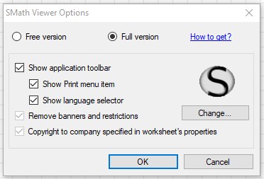

Full version of SMath Viewer is now available for signed in users:

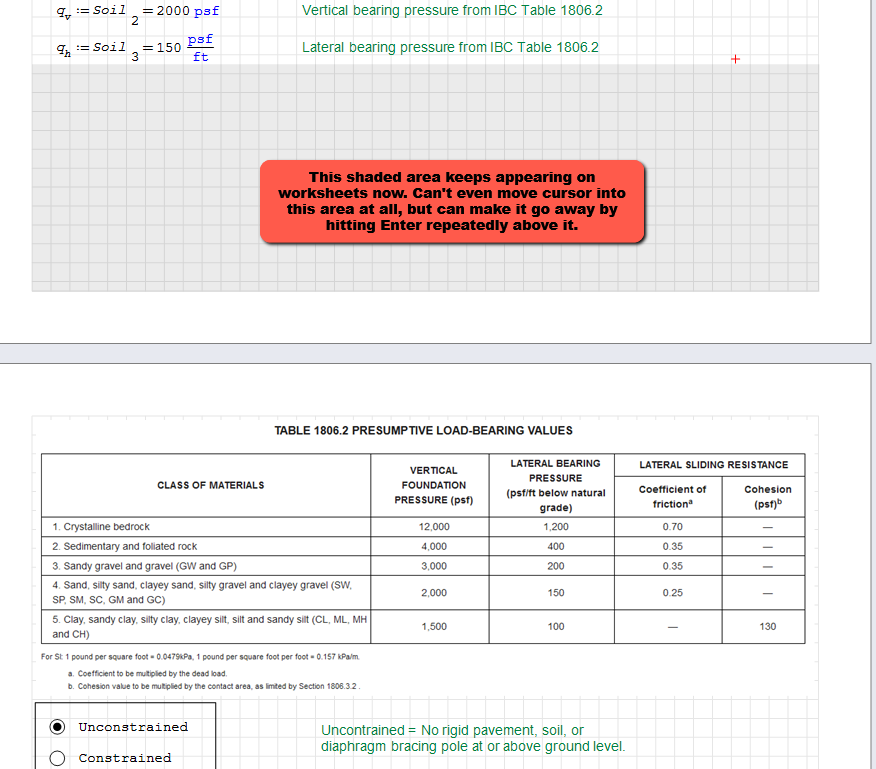

Tried logging in, but nothing happened. Is that SMath account a different account than the SMath Forum account? I did confirm that I had the right password for the forum account and tried again, but no success.
Also, the problems I reported before about unwanted math regions being inserted automatically in text regions is still present. I can't enter a date in any common format without it being interpreted as an equation. Using dashes like 01-01-2021 isn't too different on the formatting (more space), but slashes are also common and 1/1/2021 gets interpreted as a fraction, which is an issue. My only workaround so far has been to add spaces and then backspace them out after I've typed everything, which is not an ideal workflow. But it may also be affecting my dropdown boxes as well now. In the screenshot below, the last entry for 3/4 was entered after the update this morning, and it doesn't display correctly in the subsequent dropdown combobox. It still picks the correct value, but the display in the list could be difficult to interpret like this.
Thanks,

There's also another issue that started appearing in the previous build, but still occurs in this one. See below for a screenshot of the shaded region at the bottom of the page that is inaccessible. The cursor cannot be placed or moved into that area. Trying to move any text or math region into it just makes those items bounce out. Seems to occur when I've had a graphic on the page above that moved down until it no longer fit on the page and moved to the next page. Then it leaves this strange shaded area where the graphic used to be on the upper page. If I hit the carriage return on the keyboard, one line of the shaded region goes away. So if hit Enter a bunch of times, the region temporarily goes away, but comes back later with more editing. Any ideas?
Thanks,
Jason

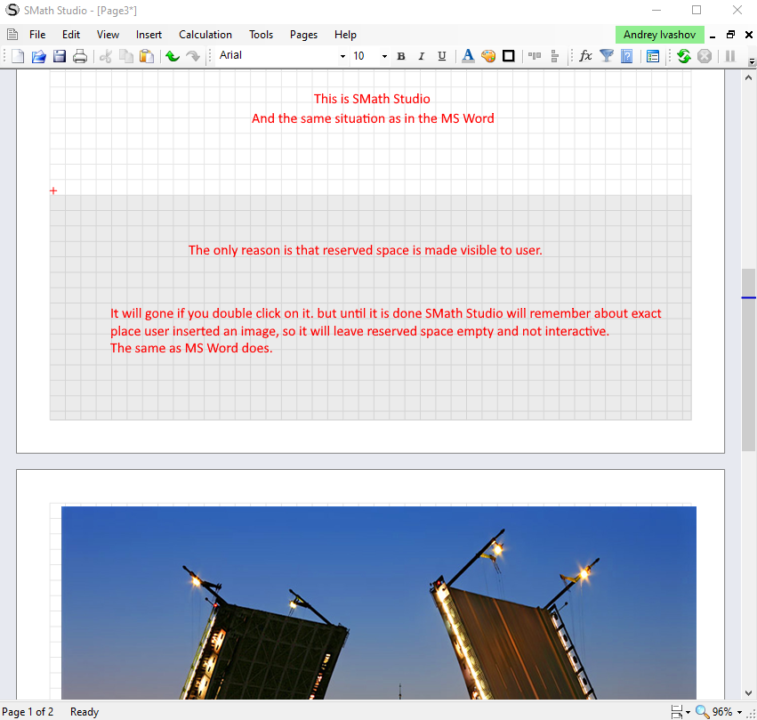

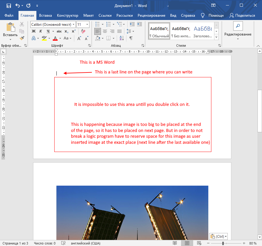

This is by design from the time when Pages representation mode was introduced. Please try to play with MS Word and SMath Studio side by side.

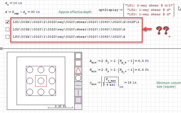

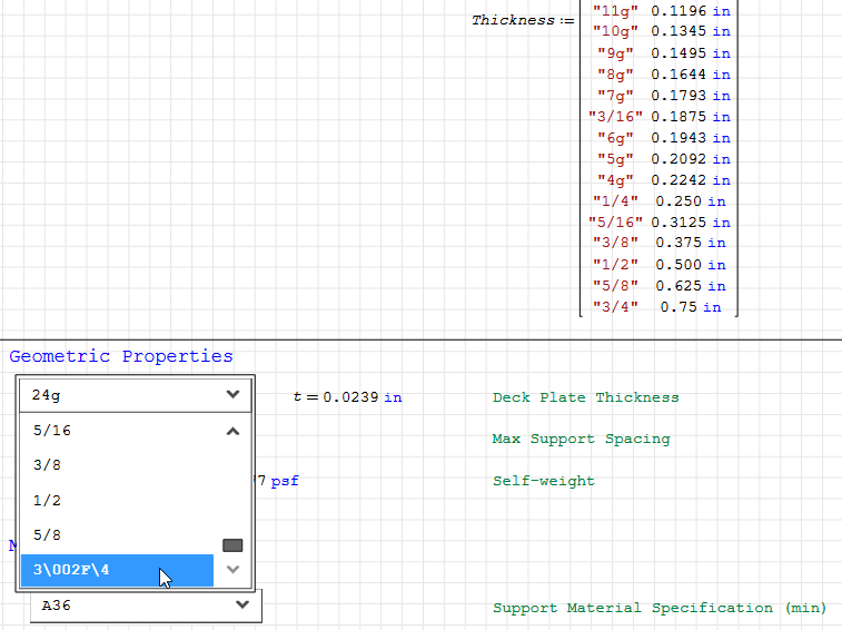

Wow, 20+ years of using Word and I never knew about that! Thank you for the explanation. I had tried clicking in the space several times but never double-clicking. Glad that one had an easy solution. Thanks! Any suggestions on how the text is displaying in controls?
#20 已发布: 2021/4/10 05:11:40
2,344个赞,共4,057个帖子。
组: Super Administrator
The reason is in my comment here: https://en.smath.com/forum/yaf_postsm69253_IMAGE-REGION-DOESN-T-WORK.aspx#post69253
I will start correcting plugins today.
