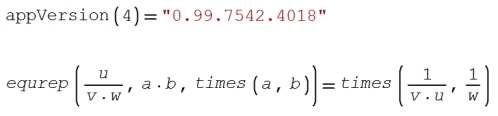

I post that question because interpret that then equrep works replacing f by sin in this example: "equrep(3+f(x),f,sin)=3+f(x)" but now I see that the correct way is "equrep(3+f(x),f(a),sin(a))=3+sin(x)"
Here my attempt to convert an expression with operators to an expression with binary or unary functions only
_to_expr.sm (51.03 KiB) downloaded 1587 time(s).
_to_expr.pdf (223.76 KiB) downloaded 885 time(s).
Rematch ... It's seems to work now.
num2expr.sm (39.06 KiB) downloaded 1461 time(s).
num2expr.pdf (176.65 KiB) downloaded 1031 time(s).
