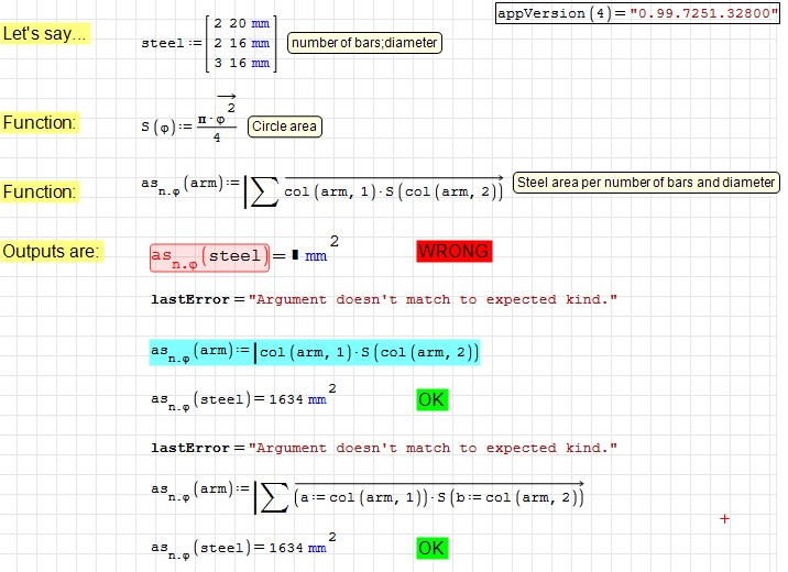

I am having this issue evaluating the vectorized multiplication:
I don't know what the problem could be. I started today switching definitely from Mathcad Prime 5 and started rewriting some codes.

#2 已发布: 2020/4/16 02:37:32
Fridel Selitsky
Fridel Selitsky
520个赞,共451个帖子。
Matrices are multiplied like in a matcade

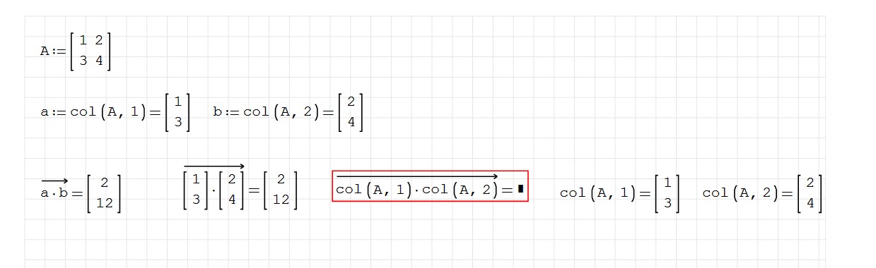

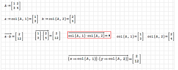

#3 已发布: 2020/4/16 11:23:24
983个赞,共6,866个帖子。
Just a matter of isolating the code
col(A,1), col(A,2) are not like function.
#4 已发布: 2020/4/16 15:52:44
NDTM Amarasekera
NDTM Amarasekera
130个赞,共352个帖子。
This way it works.

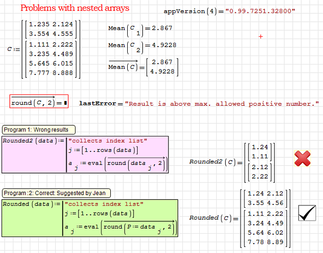

#5 已发布: 2020/4/16 16:44:34
NDTM Amarasekera
NDTM Amarasekera
130个赞,共352个帖子。
There are some more issues with the vectorize function

Thank you all for your quick responses! Problem solved with ndtma solution. Thank you

#7 已发布: 2020/4/16 22:55:20
983个赞,共6,866个帖子。
Nice code SS 7251, not supported SS 6179.

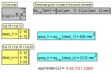

#10 已发布: 2020/4/24 22:45:36
Alvaro Gavilán-Rojas
26个赞,共68个帖子。
Thank you Jean for your suggestion.
I would rather use a function, because in various parts of my worksheet (beam design), I need that function. It would be like this:
AG24042020-Steel area.sm (6.48 KiB)已下载 1506 次。
#11 已发布: 2020/4/25 16:45:24
983个赞,共6,866个帖子。
Maybe like this.
Project SteelBar.sm (23.19 KiB)已下载 1555 次。

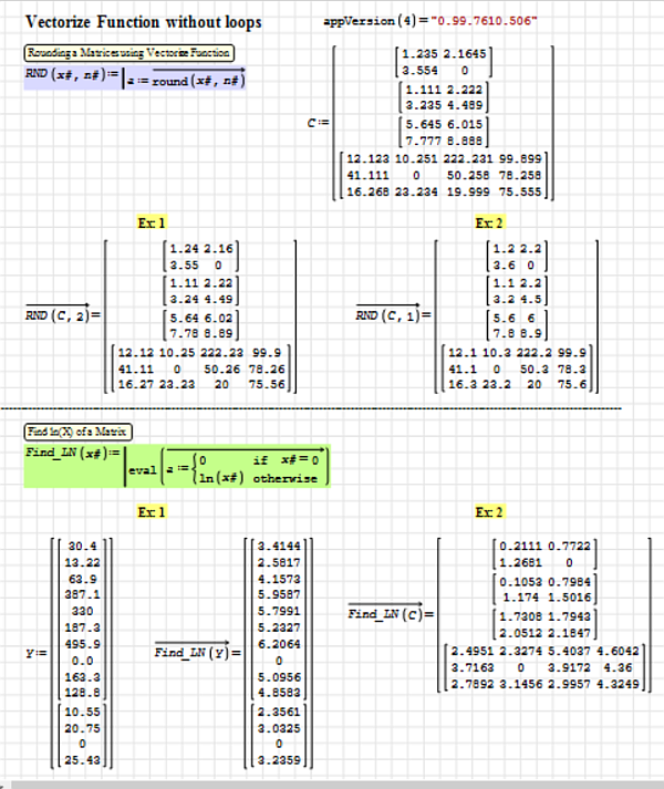

#12 已发布: 2020/11/8 09:58:14
NDTM Amarasekera
NDTM Amarasekera
130个赞,共352个帖子。
Vectorize function without loops.
Vectorize_Eady.sm (15.01 KiB)已下载 1479 次。
