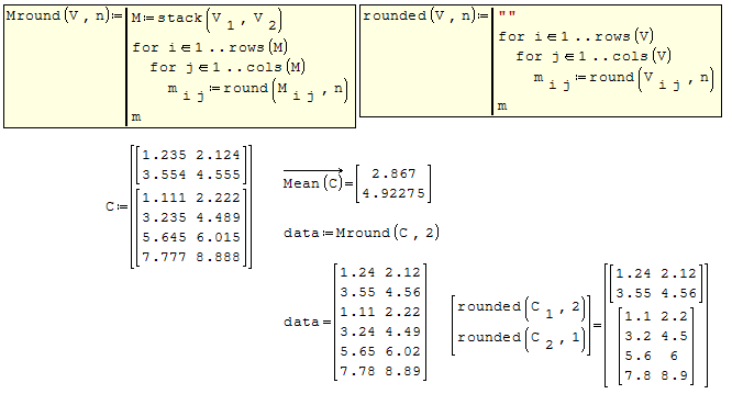

#12 Posted: 2020/11/8 09:58:14
NDTM Amarasekera
NDTM Amarasekera
130 likes in 352 posts.
here are some more issues with the vectorize function
Vectorize function without loops.
Vectorize_Eady.sm (15.01 KiB) downloaded 1112 time(s).
