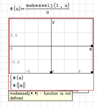

The ber, bei functions are missing
Check if you can do something from the Smath built-in
mwbessl [i,j,k,y] from the f(x) menu.

9个赞,共90个帖子。
Thanks, for your reply. Unfortunately, I do not see "mwbessl..." listed. Maybe something that I need to activate? Is there a certain plugin I need to load?
You may have to install from the plugin list.
Click on "Tools", click "Plugins" ... install all.

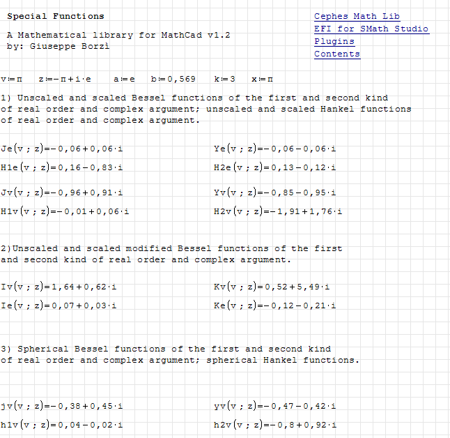

#7 已发布: 2017/11/30 15:27:18
1,362个赞,共2,276个帖子。
Try with my portable distribution, see signature. There, the mathlib.dll (mathcad special functions) is installed and the bitness of the executable is adjusted.
The screenshot below is from the interactive handbook. You find it using the [?] button in the toolbar in the distribution mentioned above.
Goto Plugins> EFI for SMath Studio> Special functions.
2017-11-30 19_23_19-SMath Studio 0.98.6484 - [Section Special functions.sm].png

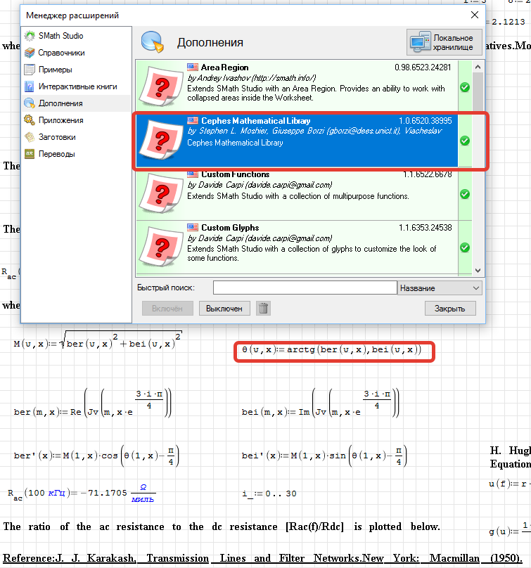

1,558个赞,共1,868个帖子。
Try this.
Links:
1. Cephes Mathematical Library.
引用
mathlib.dll must be uninstalled (removed manually) from the Mathcad EFI plugin. Cephes Mathematical Library contains same functions.

9个赞,共90个帖子。
Many thanks! "Jv" is now defined. But "arctg" is not. Another plugin?
#11 已发布: 2017/11/30 17:52:58
1,443个赞,共2,936个帖子。
Name of trigonometric functions depend on the function naming type in global settings of your smath studio; in your case you should look for atan

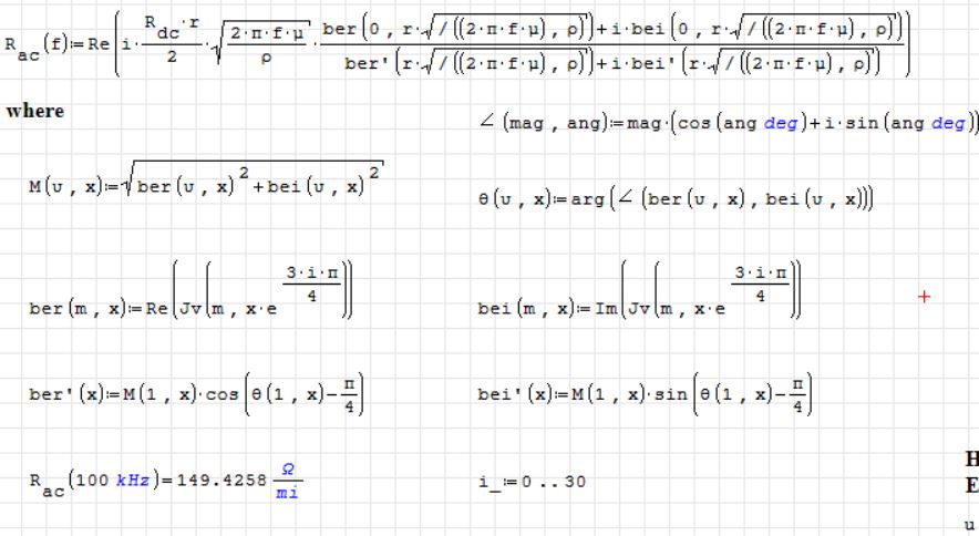

Thank you! Now it computes, but the value; Rac(100kHz) is negative. Should be 141.553Ohm/Mi. I need the "angle" function definition from Mathcad. angle(x, y) Returns the angle from the x-axis to a line containing the origin and the point (x,y). Results are in radians between 0 and 2π, excluding 2π.
#13 已发布: 2017/11/30 18:24:09
983个赞,共6,866个帖子。
angle(x, y)
NFG ... arg(1+1*i)=45°

Norm Schutzkus
Norm Schutzkus
9个赞,共90个帖子。
Using an old MC definition I obtained a better value:

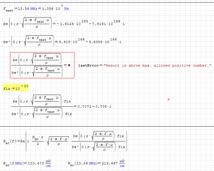

Thanks again for the collab's help. The work sheet displays the same result as MC. AC-DC Resistance Using Bessel Functions.sm (12.68 KiB)已下载 1218 次。

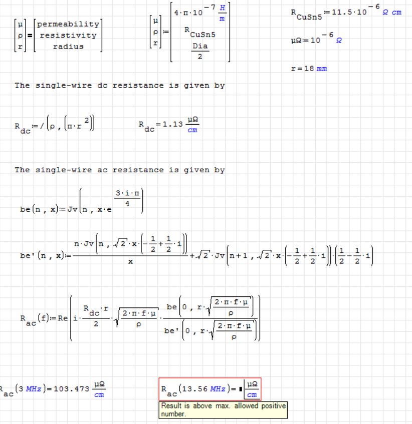

Now I have a fault using a modified sheet that the "Result is above max. allowed positive number." Capture.JPG. The limit for Rac(f) is 9.3MHz, then the error shows.
The result should be 219 micro-ohm/cm. Why the limit?
nas
Bellow Equiv Resistance.sm (14.43 KiB)已下载 1194 次。

1,443个赞,共2,936个帖子。
Something triggered in the factorization of the ratio be(...)/be'(...) you can make it working with a trick
