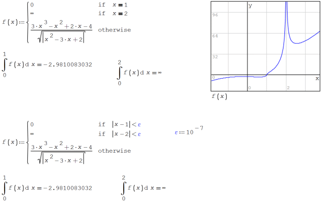

Hi. I think that here the point is how to handle avoidable discontinuities in SMath. Because integral and other operators or functions not accept the 'if' statement, you can use 'cases' in the definition of f, as this:
Even this isn't the case, this other is more general for avoiding numerical issues with avoidable discontinuities:
sergio 2019/2/8 08:59:00
About the other discontinuity, at x=2, I guess that you don't want to work with complexes. It's usual take the absolute vale of logs and roots in real analysis calculus. This other isn't avoidable discont, but can be handled in a similar way.
discont_integral.sm (8.65 KiB) downloaded 933 time(s).
