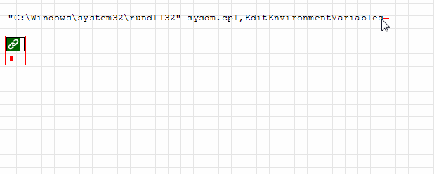

#23 已发布: 2013/8/26 14:14:20
1,443个赞,共2,936个帖子。
UPDATED
Just to complete the early introduced feature
- converter on paste accept command-line strings (input string: "ProcessToStart"[space]Flags)
so when you paste in the placeholder something like:
"C:\Windows\system32\rundll32" sysdm.cpl,EditEnvironmentVariables
this will become:
"'C:\Windows\system32\rundll32' sysdm.cpl,EditEnvironmentVariables"
best regards,
Davide

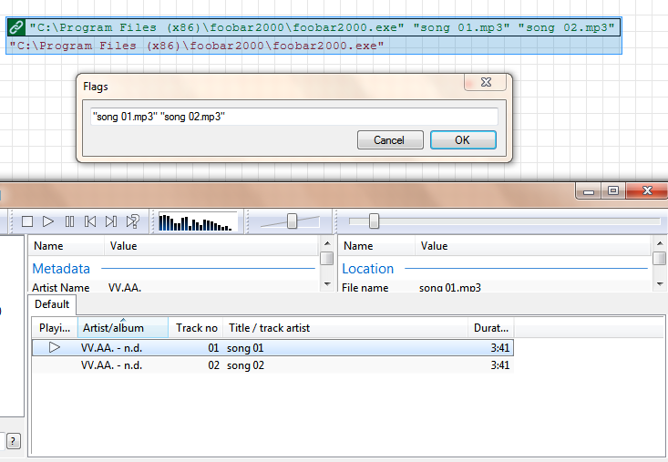

#30 已发布: 2013/10/6 20:09:31
1,443个赞,共2,936个帖子。
UPDATED
- Flags input moved from the placeholder to a dedicated context menu item.
This solve double quotes issues involving flags and SMath strings.
- PASTE feature works also with the new input way.
(TEMPORARY feature) To update worksheets containing the old syntax ("'process' flags"):
- open the worksheet
- save the worksheet
- close and open again the worksheet
- delete all except the process name from the input placeholder
regards
Davide

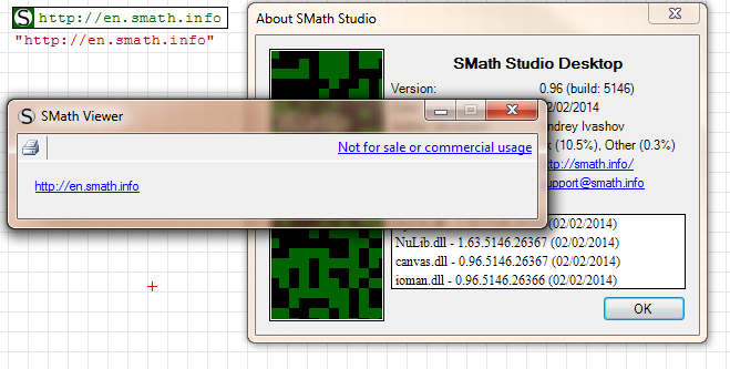

I am using it with version 0.96.5146 but generation
of executable version (viewer) doesn't work for me.
Is that known issue ?
#35 已发布: 2014/2/4 07:08:28
1,443个赞,共2,936个帖子。
Hello, I can't reproduce the issue... could you attach a file that doesn't work for you?
#36 已发布: 2014/2/4 08:10:27
dyleks
dyleks
0个赞,共4个帖子。
The issue is solved.
After SMath was restarted it works.
Sorry for bothering you.
