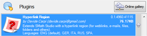

First Beta available through plugin's Gallery.
Documentation and translation sheet in the first post.
Best regards,
Davide

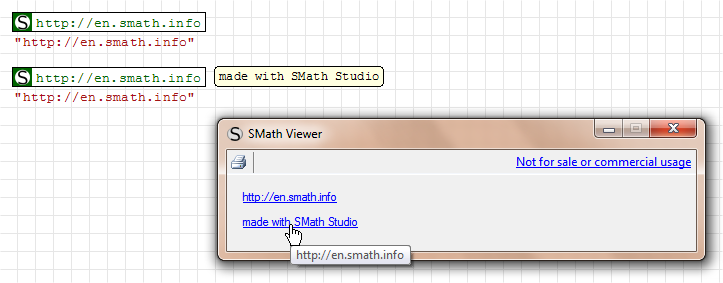

- Support for SMath Viewer
best regards,
Davide
