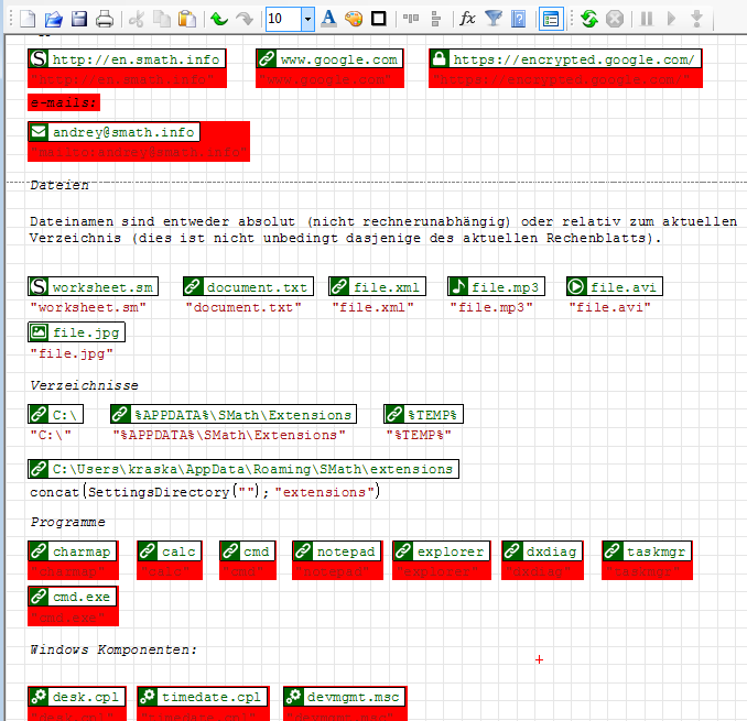

Davide, I experience strange problems with hyperlinks with SMath 0.98.6179 and a fresh hyperlink region plugin.
The links in your docs (from post #1) work fine.
If I copy them to my handbook page, I get "System can't find the file" messages for the links marked with red background, both documents in the same instance of SMath. No matter if portable or installed distribution...
There must be something wrong with my document...

WroteIf I copy them to my handbook page, I get "System can't find the file" messages for the links marked with red background, both documents in the same instance of SMath. No matter if portable or installed distribution...
Try now, it should be fixed.
Also:
- SMath Viever now should be able to open relative links (if the file exists);
- SMath files they can be opened even from SMath portable (a new instance of the current SS will be used to open the files, as in Writer Region);
Martin Kraska 2017/1/2 13:11:00
Confired, thank you.
BTW, due to the current plugin loading policy (long startup time), I'd prefer links to smath files being opened in the currently running instance.
For the interactive handbook, the writer region can't be used by this reason (also, because you need to activate the region before you can click links, i.e. thus doubling the required clicks).
