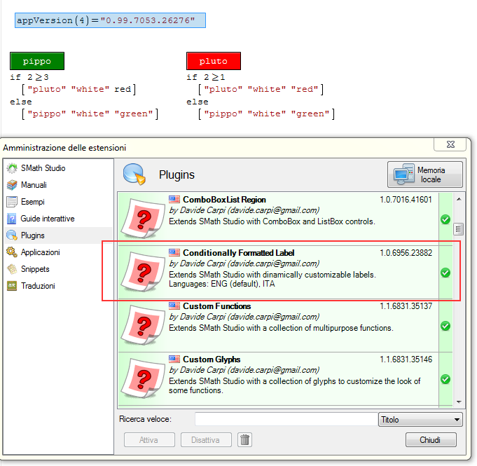

0个赞,共6个帖子。
is this plugin working with version 0.99 of SMath? I can't find it to download from the application's plugin manager.
Thanks,
#55 已发布: 2019/5/6 05:32:50
127个赞,共342个帖子。
in my installation (win7 PRO) it works correctly
