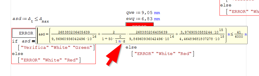

Sorry Jean but i don't understand what i'm supposed to see. I also get "data - not defined".
#82 已发布: 2023/1/17 10:18:15
983个赞,共6,866个帖子。
Sorry Jean but I don't understand what I'm supposed to see. I also get "data - not defined".
data not defined probably indicates some plugins not installed.
Maybe other problems wrt your version.

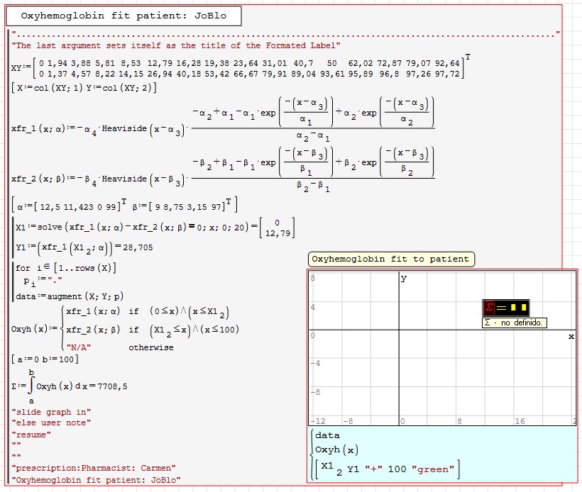

#83 已发布: 2023/1/17 10:55:42
983个赞,共6,866个帖子。
Here it is.
Document does not open ... incorrect format

#85 已发布: 2023/1/17 11:20:05
1,443个赞,共2,936个帖子。
If you hover over the asd definition you can see that there is an unsolved "d" dependancy that triggers the error.
The same happens if you try to force a numerical evaluation using eval()
#86 已发布: 2023/1/17 12:05:21
German
German
0个赞,共8个帖子。
That is it!
As allways thanks!!
But still don't understand why Jean files fails.
#87 已发布: 2023/1/17 12:12:05
983个赞,共6,866个帖子。
SMath Studio Desktop 64-bit
Version: 1.0(build: 8348)
Date: 9/11/2022
Slide left the Formatted Label
Side right the graph, remove the Σ no definido
You should see the plot.

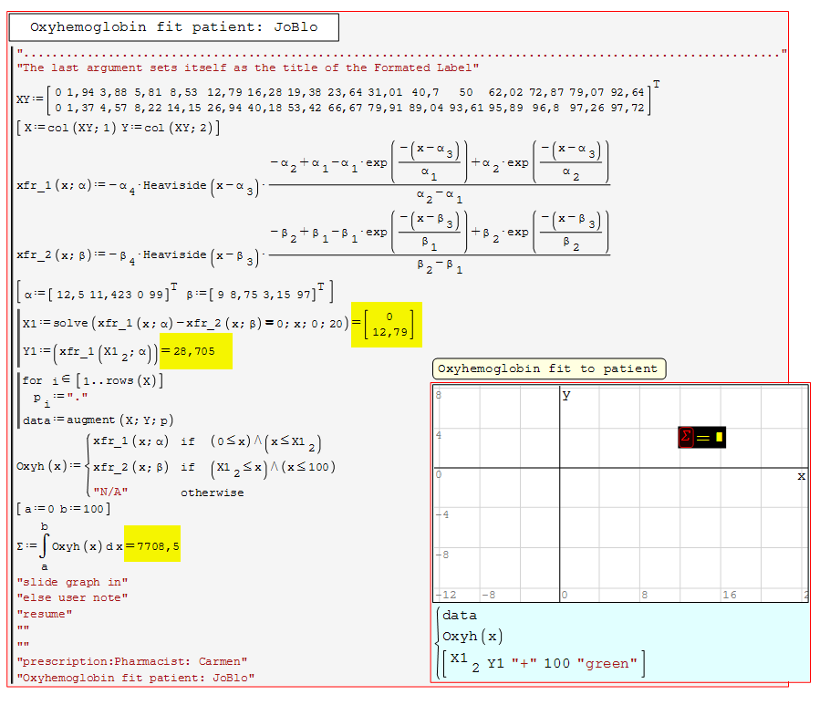

#88 已发布: 2023/1/17 12:15:52
1,443个赞,共2,936个帖子。
That is it!
As allways thanks!!
You're welcome!
There is an excel data import at the begin of the file, is not related to the issue however so it doesn't matter. nevermind I was looking at your file.
If you remove the 3 inline evaluations it will work.
2023-01-17 16_28_05-SMath Solver - [Image Formated LABEL [Oxyhemoglobin] FORUM.sm].png
#89 已发布: 2023/1/17 12:39:57
German
German
0个赞,共8个帖子。
My file can be an example of things NOT to do.

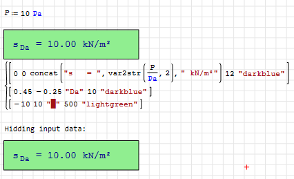

#90 已发布: 2023/10/14 23:08:58
Rogalski
Rogalski
0个赞,共7个帖子。
Can we manage the units that are displayed?
I have a load in kN/m2 and the result appears as kg/(m*s2).
The idea is to present only positive values (with the appropriate unit).
kind regards
Conditionally Formatted Labels_unity.sm (5.47 KiB)已下载 1894 次。
#91 已发布: 2023/10/14 23:52:58
1,443个赞,共2,936个帖子。
The easier way might be something like this
2023-10-14 18_53_23-SMath Solver - [Conditionally Formatted Labels_unity.sm_].png
press2text(x):line(concat(var2str(x/'kPa,1),"\0020\kN\002F\m\00B2\",1,1)

#92 已发布: 2023/10/15 00:08:06
Rogalski
Rogalski
0个赞,共7个帖子。
Thank you very much.
This is exactly what I needed.

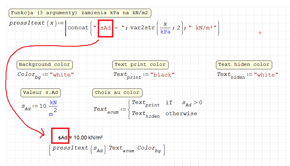

#93 已发布: 2023/10/15 23:51:23
Rogalski
Rogalski
0个赞,共7个帖子。
I'm looking for a way to represent the letter D as a subscript. Unfortunately, Unicode doesn't seem to provide this option...
Is there any possibility to parameterize individual characters that will be presented?
#94 已发布: 2023/10/16 03:06:16
983个赞,共6,866个帖子。
You can subscribe whatever.
mysystem dot HelloGrandMa

#96 已发布: 2023/10/17 02:13:46
Oscar Campo
Oscar Campo
135个赞,共309个帖子。
Davide used superscript unicode character for write: "kN\002F\m\00B2\" wich renders as "kN/m²" so, you can use unicode characters...but not all characters have subscript version.
Please check here: https://www.compart.com/en/unicode/search?q=subscript#characters
Oscar
#97 已发布: 2023/10/17 13:30:37
1,139个赞,共1,805个帖子。
Hi Karol. This could be a workaround, using the SMath Plot region.
label.sm (6.22 KiB)已下载 1870 次。
Oscar Campo 2023/10/17 16:52:00
#98 已发布: 2023/10/17 18:15:56
983个赞,共6,866个帖子。
Subscripts in native Solver 30405.
Collect as many the project needs,
call the wanted by indexing.
Maths Subscript.sm (10.73 KiB)已下载 1897 次。
#99 已发布: 2023/10/17 23:23:29
Rogalski
Rogalski
0个赞,共7个帖子。
Wow great Alvaro. Thank you very much.
I'm impressed.
#100 已发布: 2023/10/17 23:26:39
Rogalski
Rogalski
0个赞,共7个帖子。
Jean Giraud,
Thank you too.
But I have to put in some effort to understand what you sent.
Kind regards
