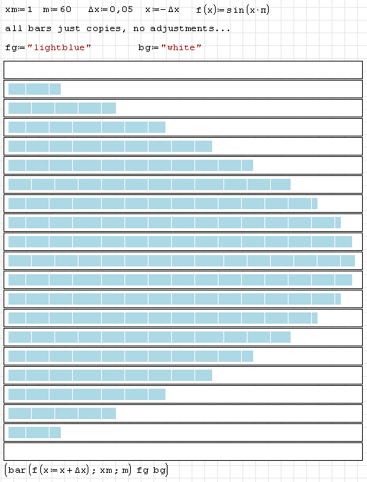

The size is exclusively driven by the contents (string length). Might be a good idea to hide the grips.
Please find attached a brick for bar charts. Please note that I was forced to fill the right of the bar by visible symbols as spaces obviously are disregarded for computing the region size.
Example cfregion barchart.sm (4.95 KiB)已下载 2113 次。

Now the complete bar chart.

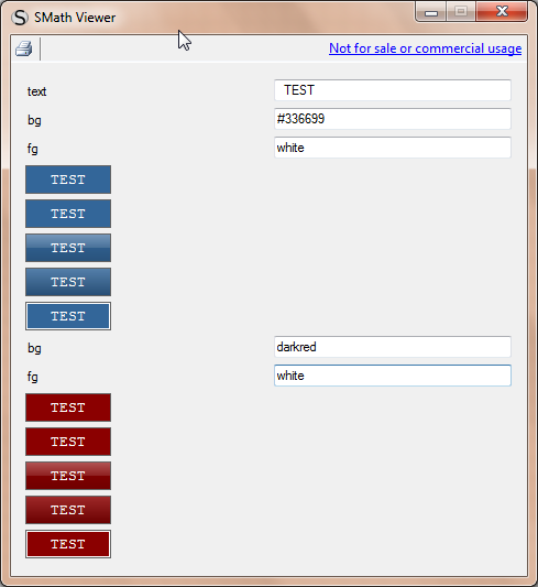

#16 已发布: 2013/10/25 11:39:06
1,443个赞,共2,936个帖子。
UPDATED
- small fixes
- added styles (optional 4th argument)
Andrey Ivashov 2013/10/26 08:22:00
