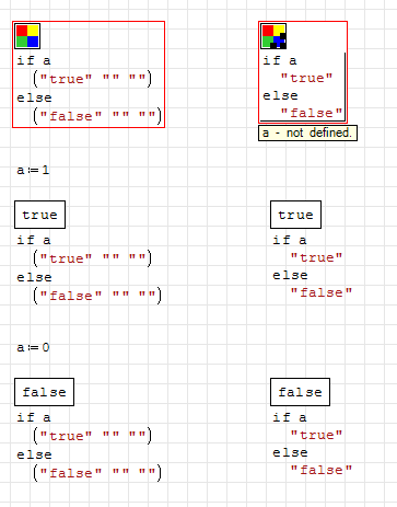

The new version disabled the feature if a ("true" "" "") ("false" "" "") I thought this is practical, why remove it? Now I have to use if a>0 ...
Also, when I modify a sheet that was created with an older version of the plugin that uses the old style syntax and I adopt it to the new syntax, Smath Studio crashes. I will try without automatic recalculation now but my data is lost.
#31 已发布: 2014/9/26 03:26:38
1,443个赞,共2,936个帖子。
Hello brotjob,
I cannot reproduce (or I've misinterpreted the issue)
I see what is shown in the screenshot
