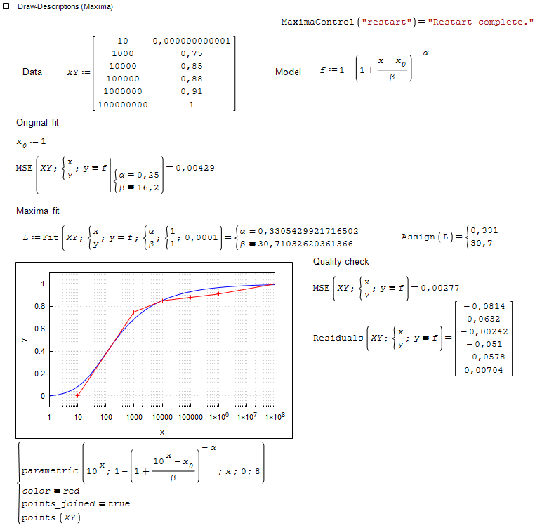

Here is a Maxima version, including the fit procedure. Note the use of parametric() in order to get evenly distributed points in the log plot.
logplot.sm (145.83 KiB) downloaded 1040 time(s).
Thanks Martin.

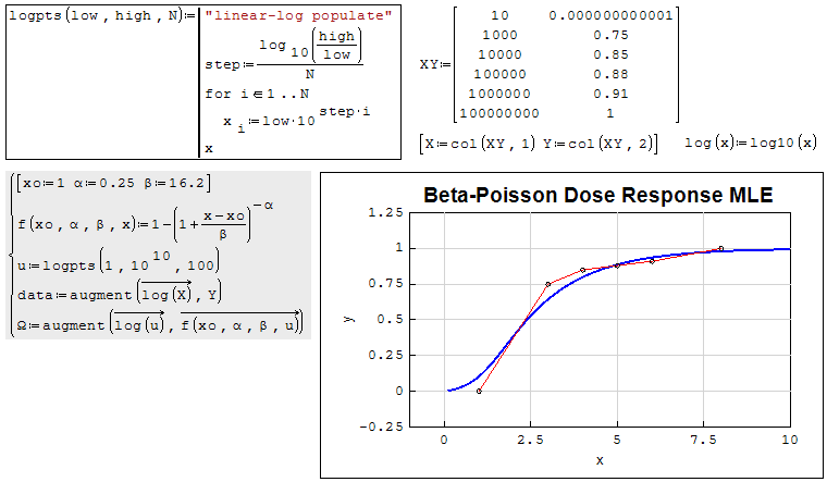

1. added the source experiment notes
2. added Weibull MLE example.
Utilities logpts [Beta_Poisson].sm (353.86 KiB) downloaded 927 time(s).
