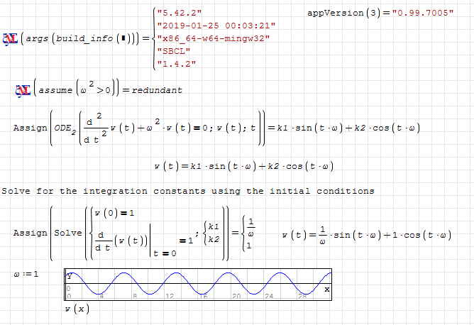

WroteI'am not able to use the assume function.
There are 17 ODEsolve in Smath that will do.
Also, can work with complexes ...
MaxODE.2.sm (17.68 KiB) downloaded 876 time(s).

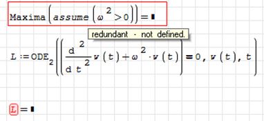

Hi Everybody,
thanks a lot.....I forgot to evaluate symbolically the assume command....
